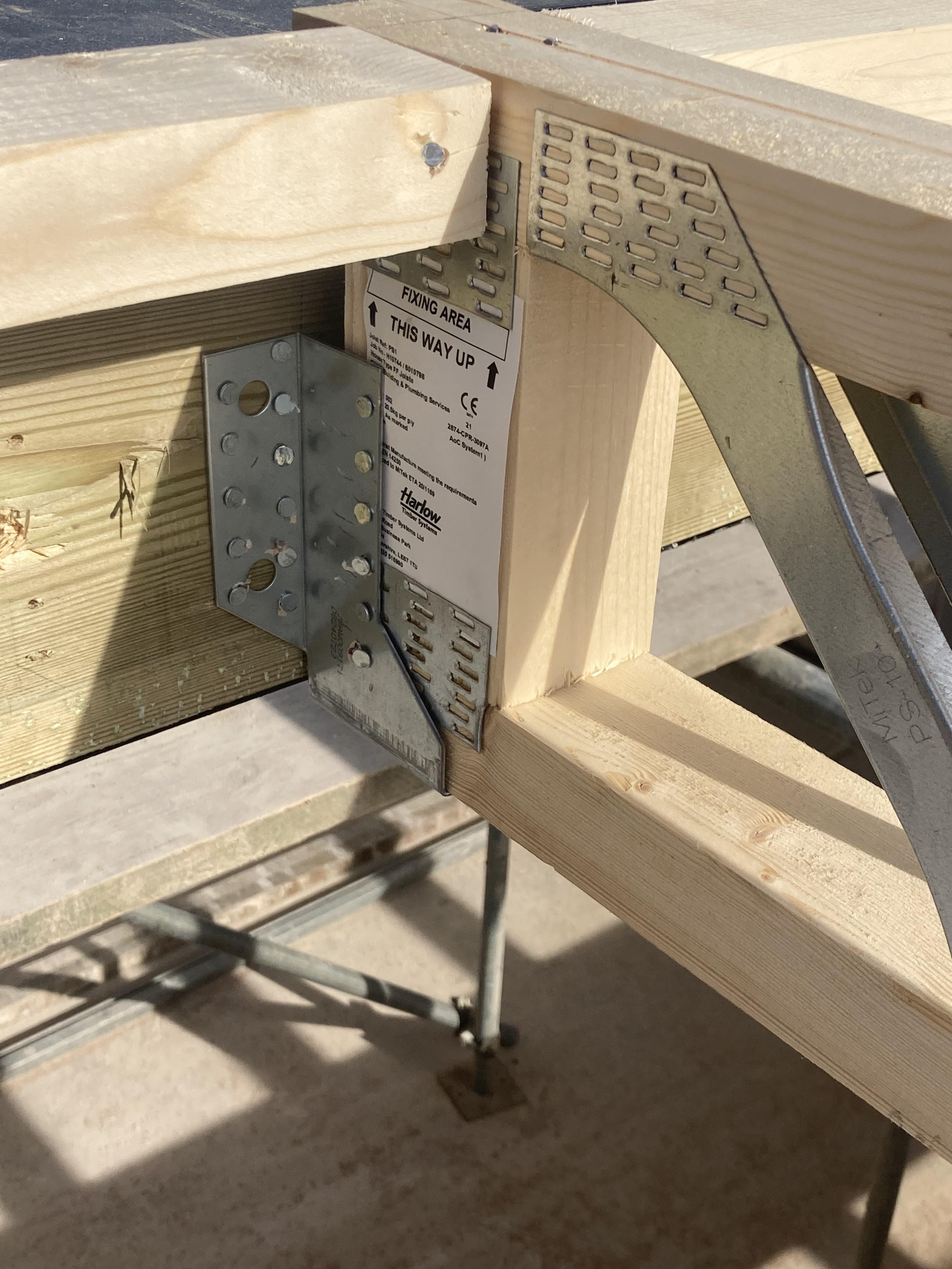

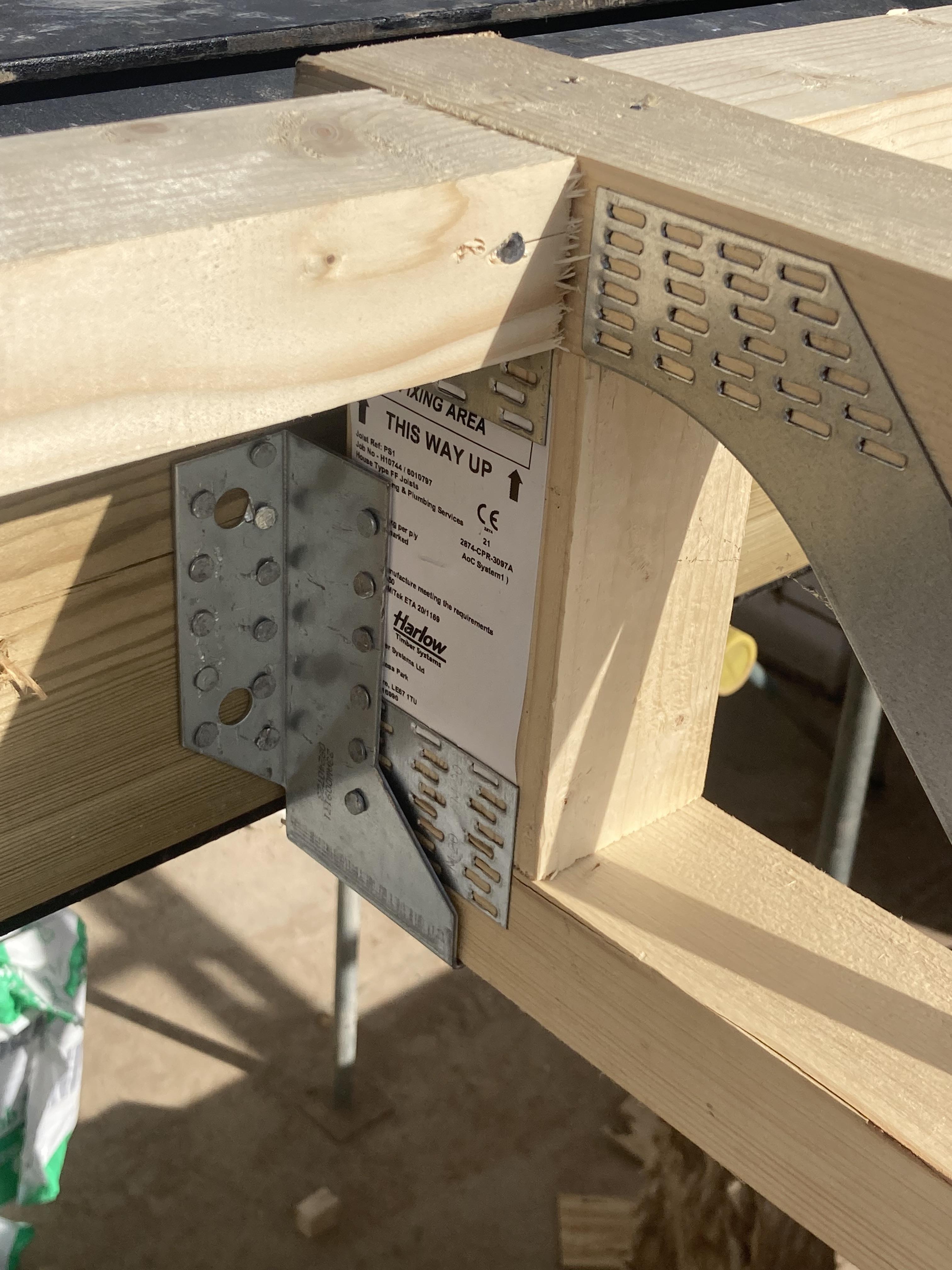

Yep it seems like that but .... I had sent hime the joist drawings 2 weeks ago and also the sizes of the web of the steels. This is where he noted that the timbers would need packing out and suggested 12.5 mm ply to do this. He said he was going to place the ply behind the timber which seemed fine to me providing it was the full height of the timber. Then I turned my back !

I agree. Seems like a poor design that I overlooked. Yep this is where the main problem lies Its not really possible when the steel is tight in the web
I agree. If it had been me I would have put the steels in position and measured the pozi joist then packed the timbers to suit. Then again I am just a bricky and not qualified to think for the chippies.🤔
No the steels are within 5 mm of where they should be.

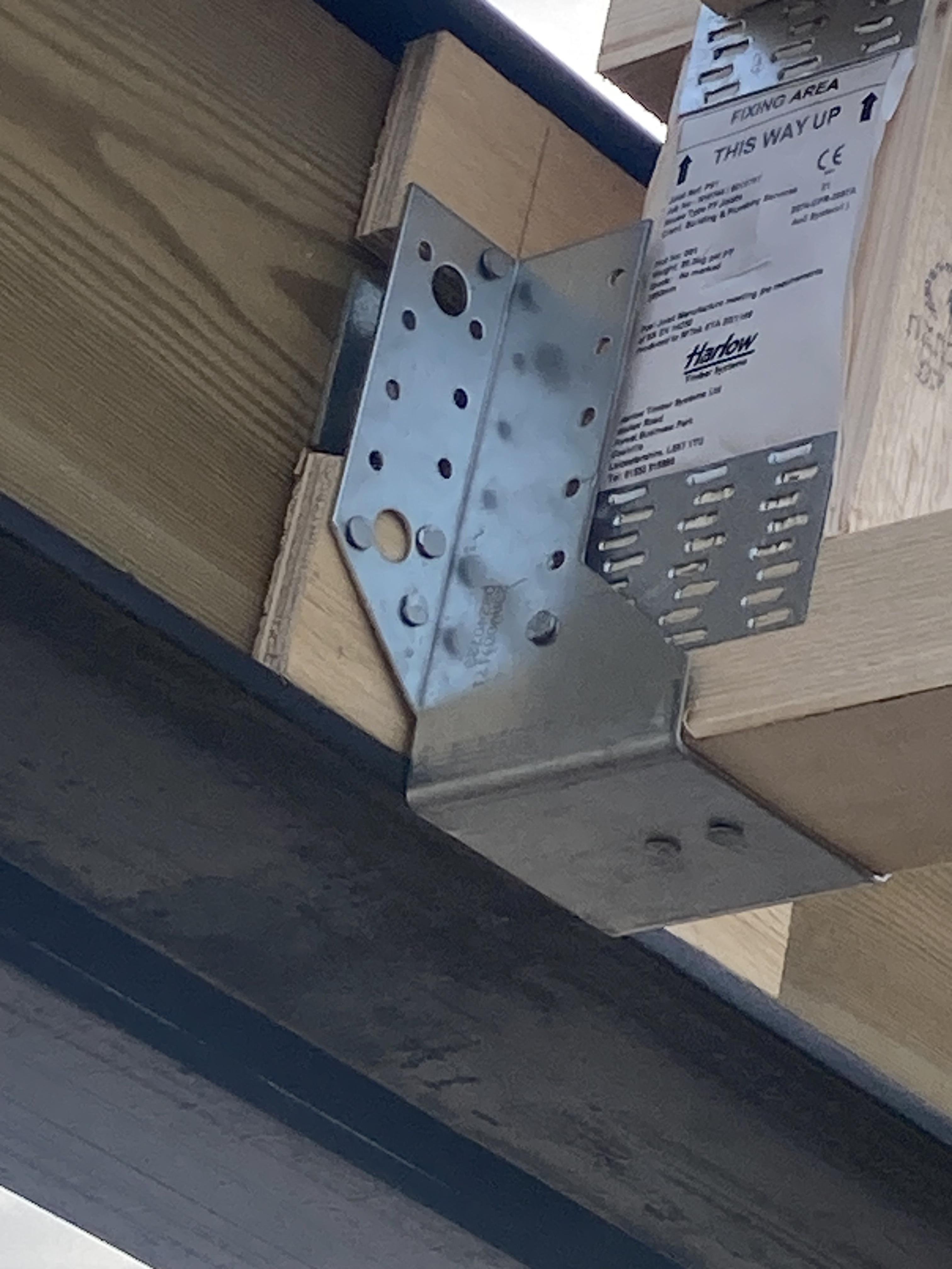

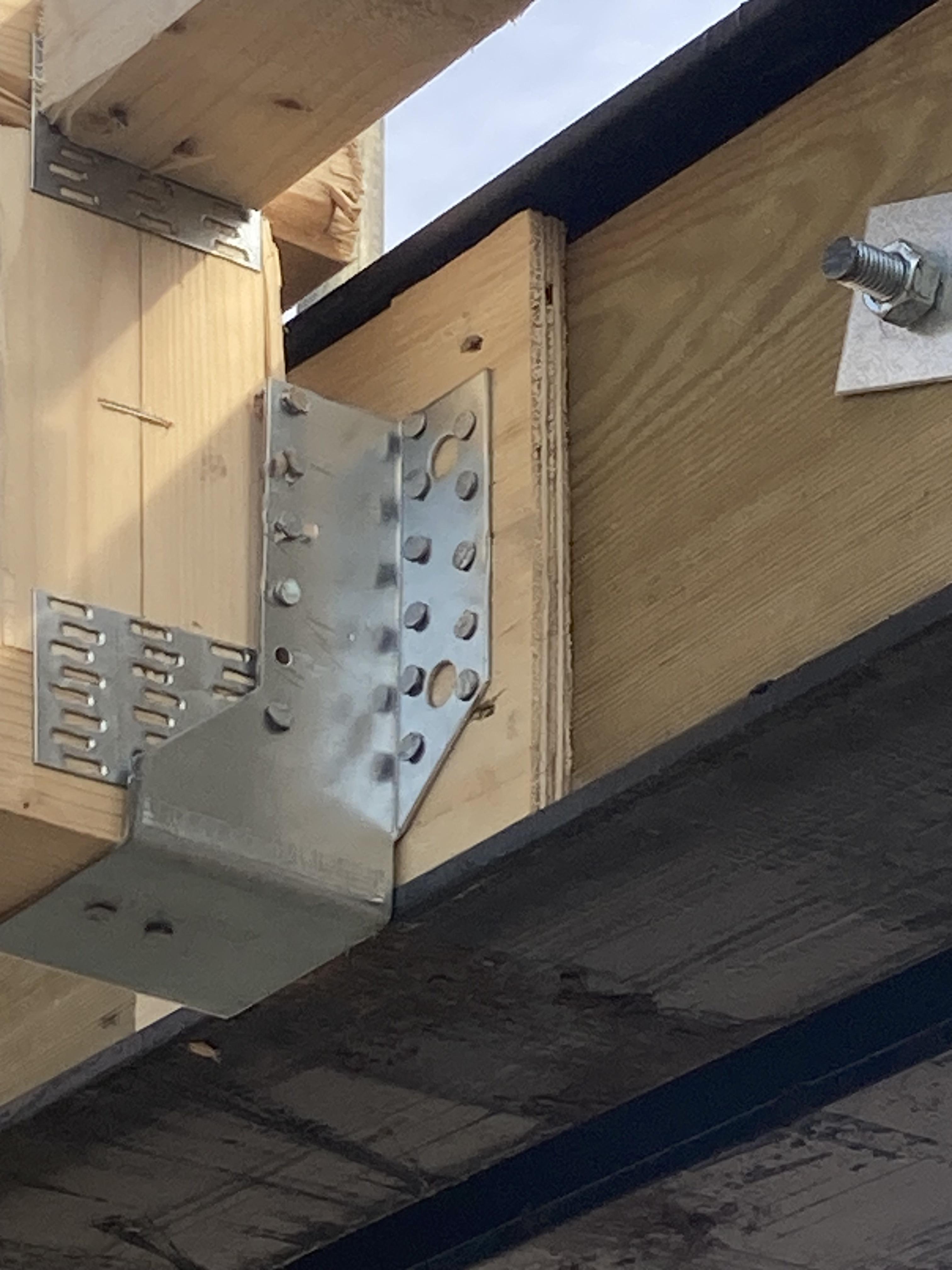

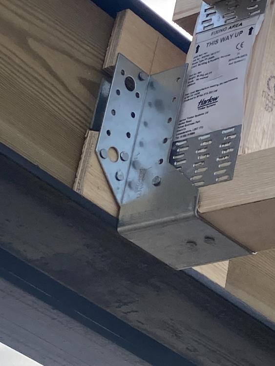

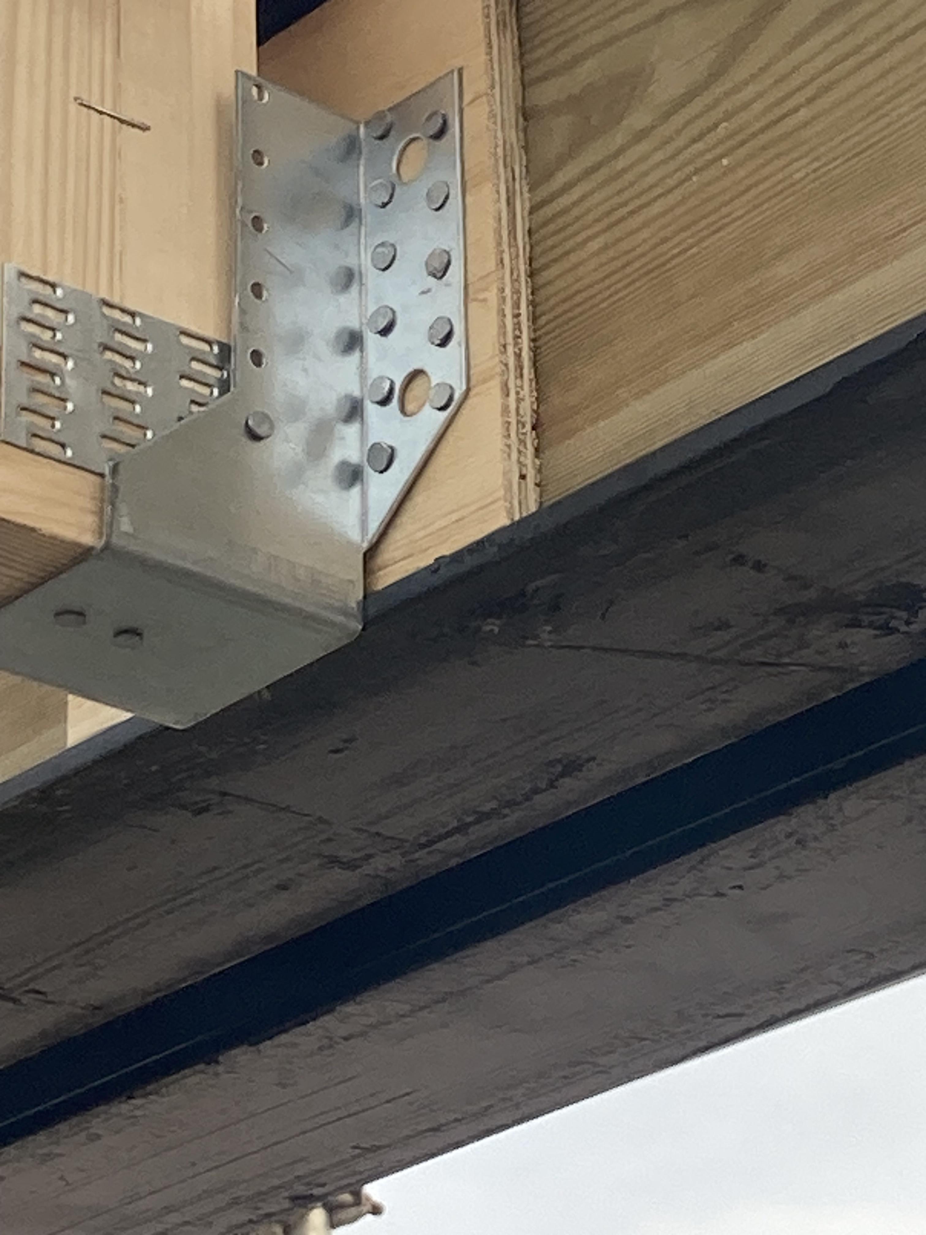

The next solution offered is to prop the joists and remove the hangers then loosen all of the bolts and then slide another 2 Nr 12.5 mm ply strips behind the plate (one above the steel bolts and one below) then retighten the bolts. This would put the plate back in the position it should have been. Not according to the joist plans. FF Joists- Posi-Joist Floor Layout - REV. E.pdf
Thanks Nod. I thought so. I was getting the bullshit excuses from the chippy which really gets to me. The joists should be solid at the ends Where is their hanger fixing detail ? The plate can't be bought forward because the hangers will be in front of the steel 🙄 ( yeah and) I have always done it like this and never had a problem.😡 Which warranty provider are you using ? (As if it makes a difference) In the end I said 'look we both know it's not right' either take them off or come up with a solution. You turn your back for a few minutes. I have got them to pack out the other timbers to sit flush. 10 minutes work ! I asked him to try to nail the verticals and of course the timber splits. At this stage I think I will have to cut the top end off and force a timber into the gap prior to nailing. An unnecessary compromise. Bad Sunday at the office.
Morning all. My joists are going on this weekend but I noticed an issue with the hanger connection to the steel. The Chippy suggested getting some 12 mm ply to pack out the plate to the edge of the flange so I supplied some. Then I turn my back and he has fixed it to the front. Even so the face of the ply is still short of the flange. Then the hangers go on and there is no chance of fixing through the vertical nail holes. We have had a conversation about this and I am insisting that the other house is changed to pack out the plate to suit the joist length but I am left with the first house like this. The Chippy is insisting that Posi joists don’t need to be nailed vertically. What are others thoughts on this ?
