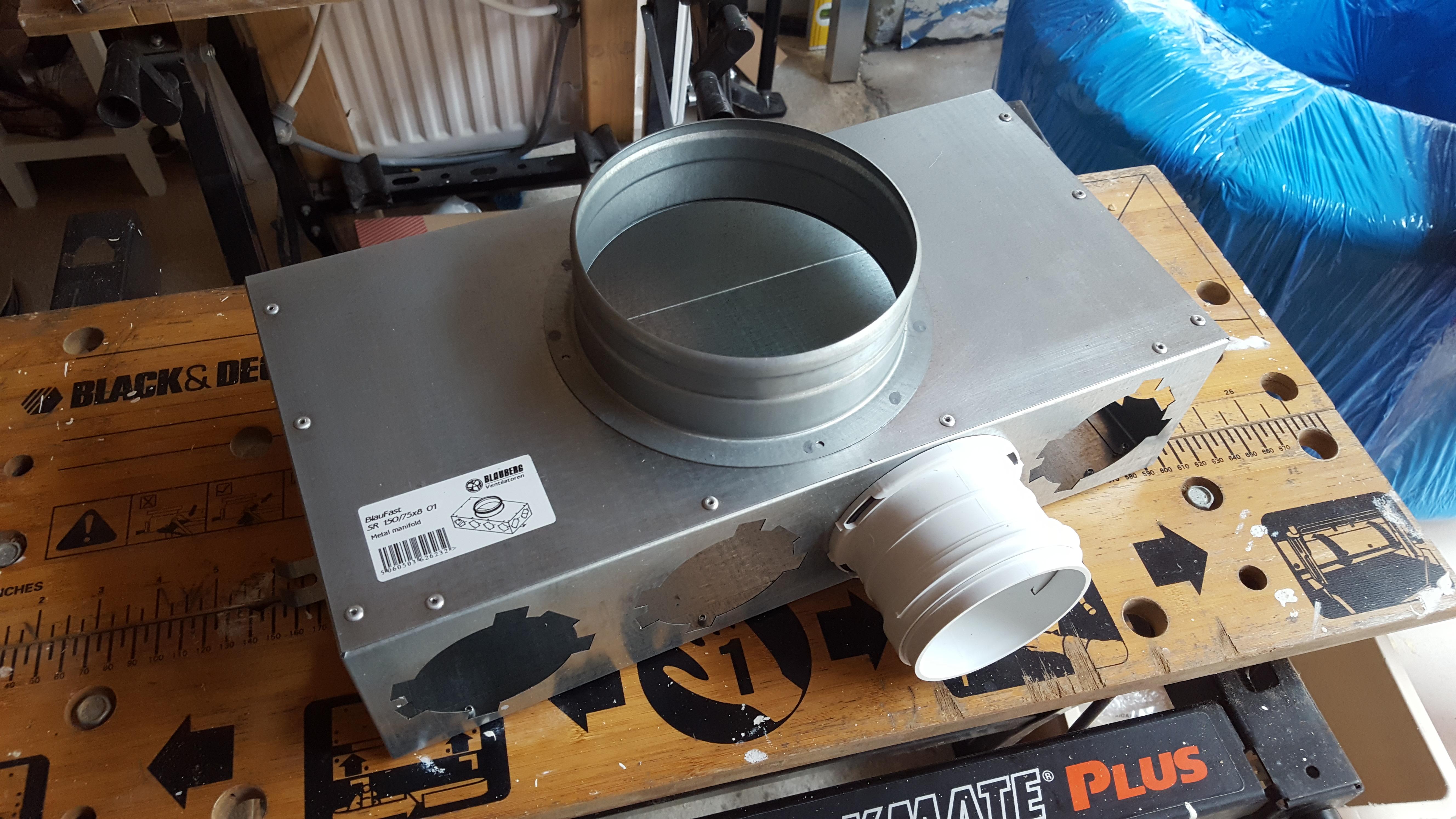

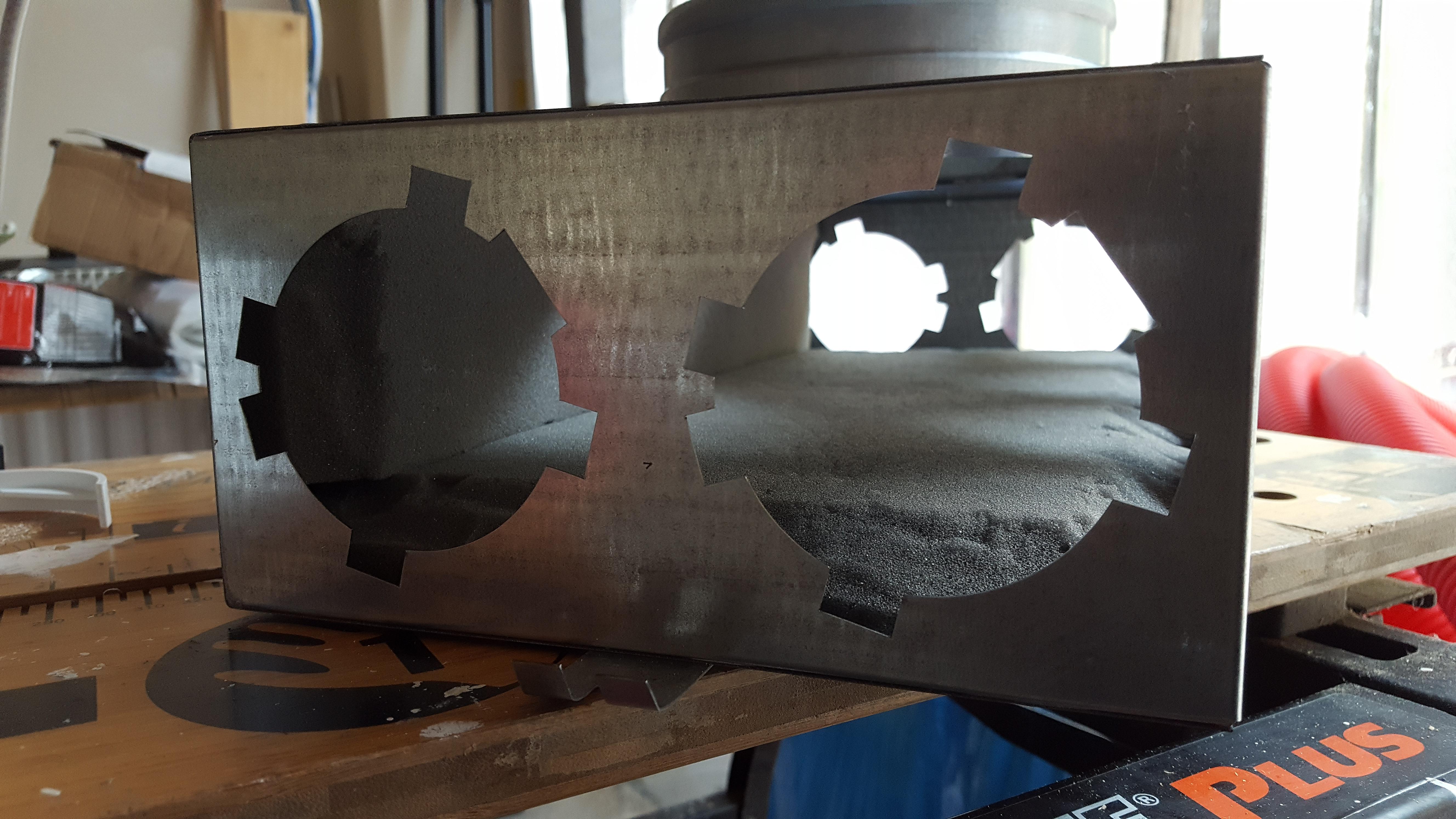

For what it's worth I added some acoustic foam to my manifolds, partly to absorb noise but also to aid insulation (they're located in a cold loft, although they have been externally insulated too with rockwool). I don't know how effective it was as it was done pre-install but suffice to say I don't think I can hear any fan noise (just air flow on boost).
