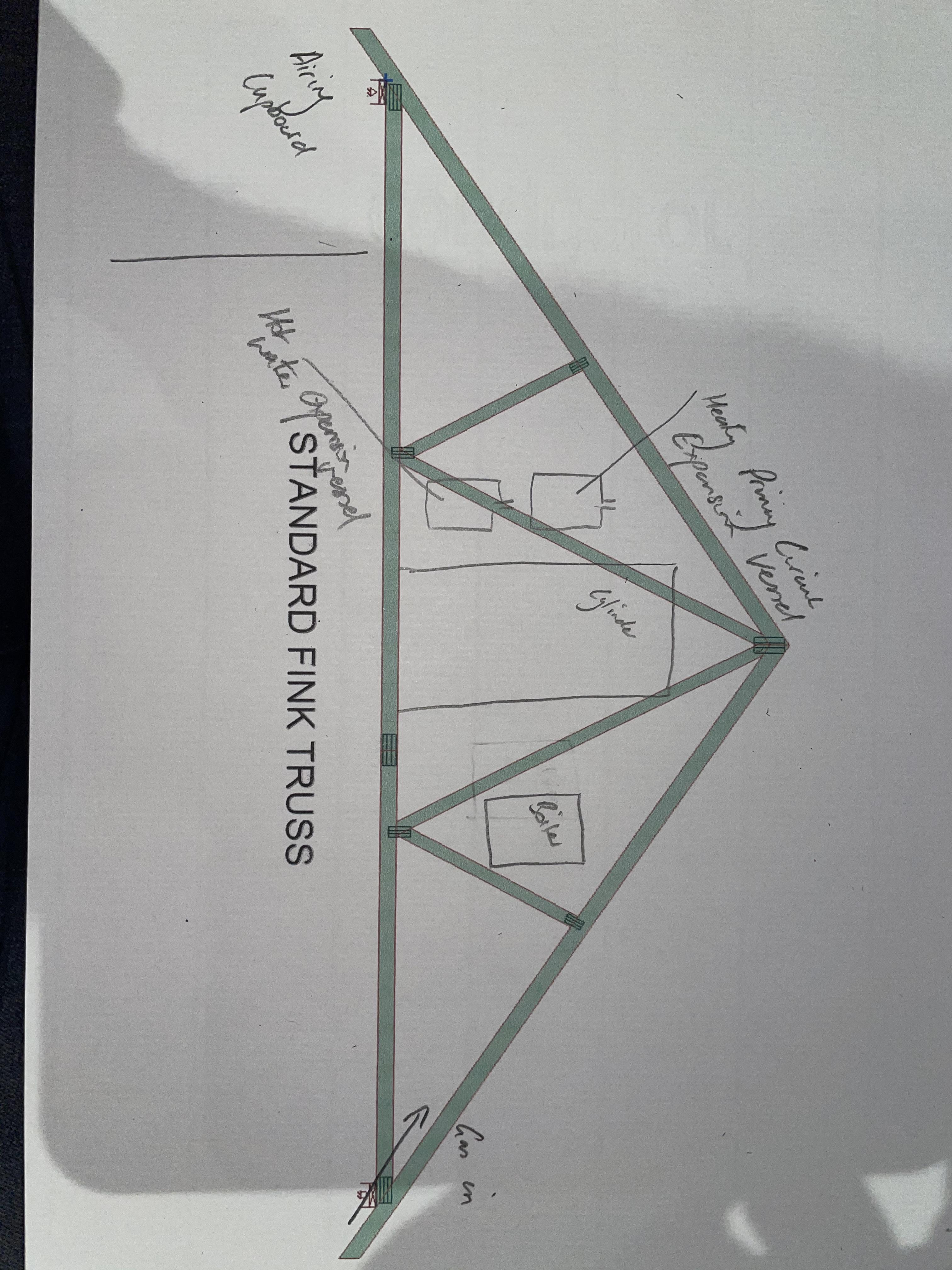

  7. Thanks Tony When there is reference to the area being floored, does the floor have to be flat and continuous. What I mean by this is that in the wider angle photo, if I floor the 'gaps' between the 2x6 going across the trusses, is it ok for the installer and later engineer to have to step over the remaining supports? There is 600mm between centers for the trusses, so presumably the metre in front needs to be the width of the boiler plus as much as I can leave? There is a single immersion in the tank as a back-up and for frost protection and looking at the spec while this wont give us the luxury of 2 baths being filled simultaneously, its enough to get away with in a push.

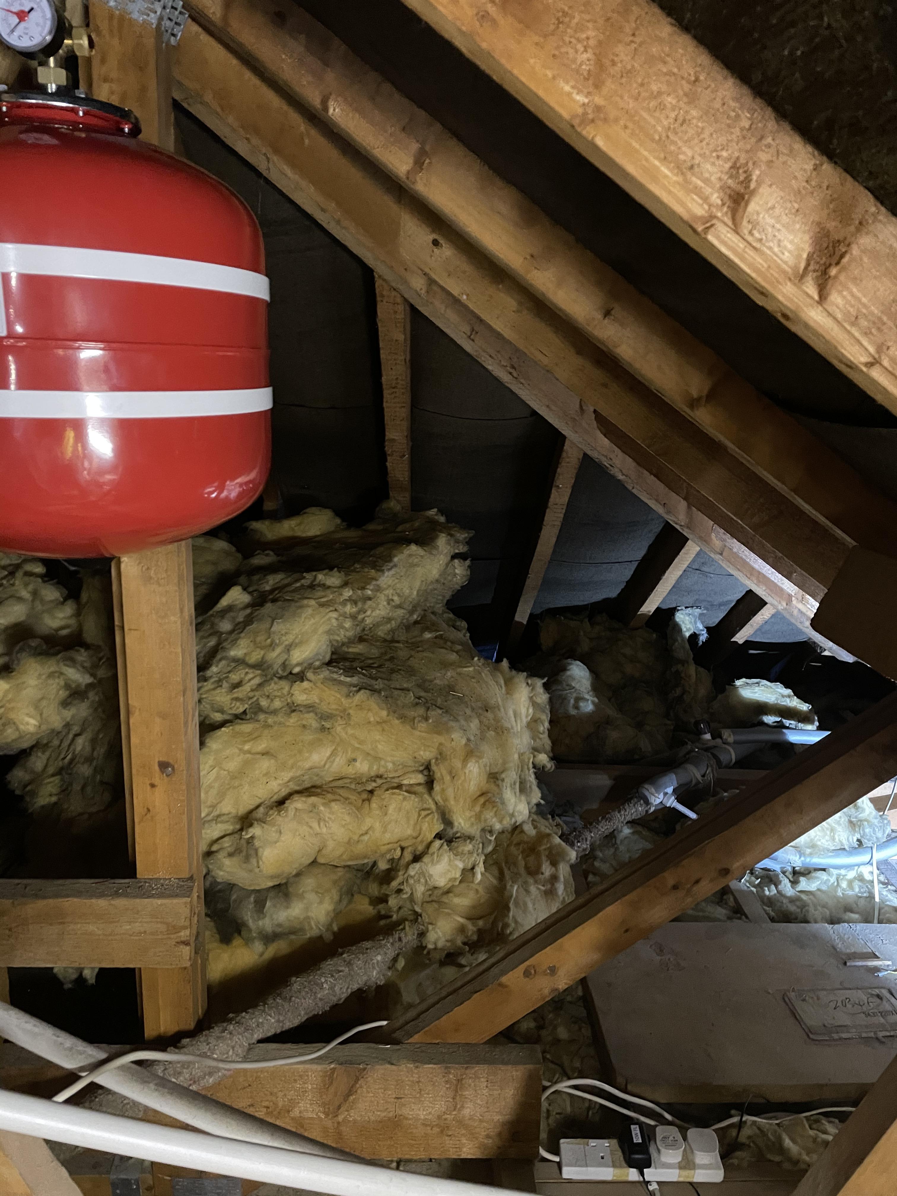

  8. Thanks Peter I hadn't thought of Tracpipe as there is a significant external run (4m up from the meter box) on the outside wall of the house and didn't think this would be acceptable.... It would however allow the whole run to be done as one piece without any joins. I've just ordered 10m of the 28mm along with tape and fittings which should be completely future proof in terms of if we need a bigger new boiler. I can get the tank in (just) at 530mm in diameter by removing the loft hatch (i fitted it with screws rather than nails about a decade ago 'just in case'). Its 1600mm in height. The current 227 litre tank is raised off the trusses by a jenga arrangement of 2x6's, presumably to give it some height (there are 4 levels). This spreads the load across 5 or 6 trusses, the end two of which are doubled up. This has been carrying the weight of the tank, and the heating circuits e/f tank for 40 years and looking at the total loading from the new system I will be about 30kg over this which will hopefully not be an issue, though with some of the wood I am removing I am likely to get to more like 20kg over or even closer to neutral. The expansion vessel isnt actually connected to anything - I was just trying out the location for height and access and then realised I had better plan for the boiler now rather than later!

  11. I can reach my proposed position with 28mm from the meter to just short of the soffit board and then 22mm from there to the boiler in my proposed position without any issue. The issue is whether my proposed layout is any good!?

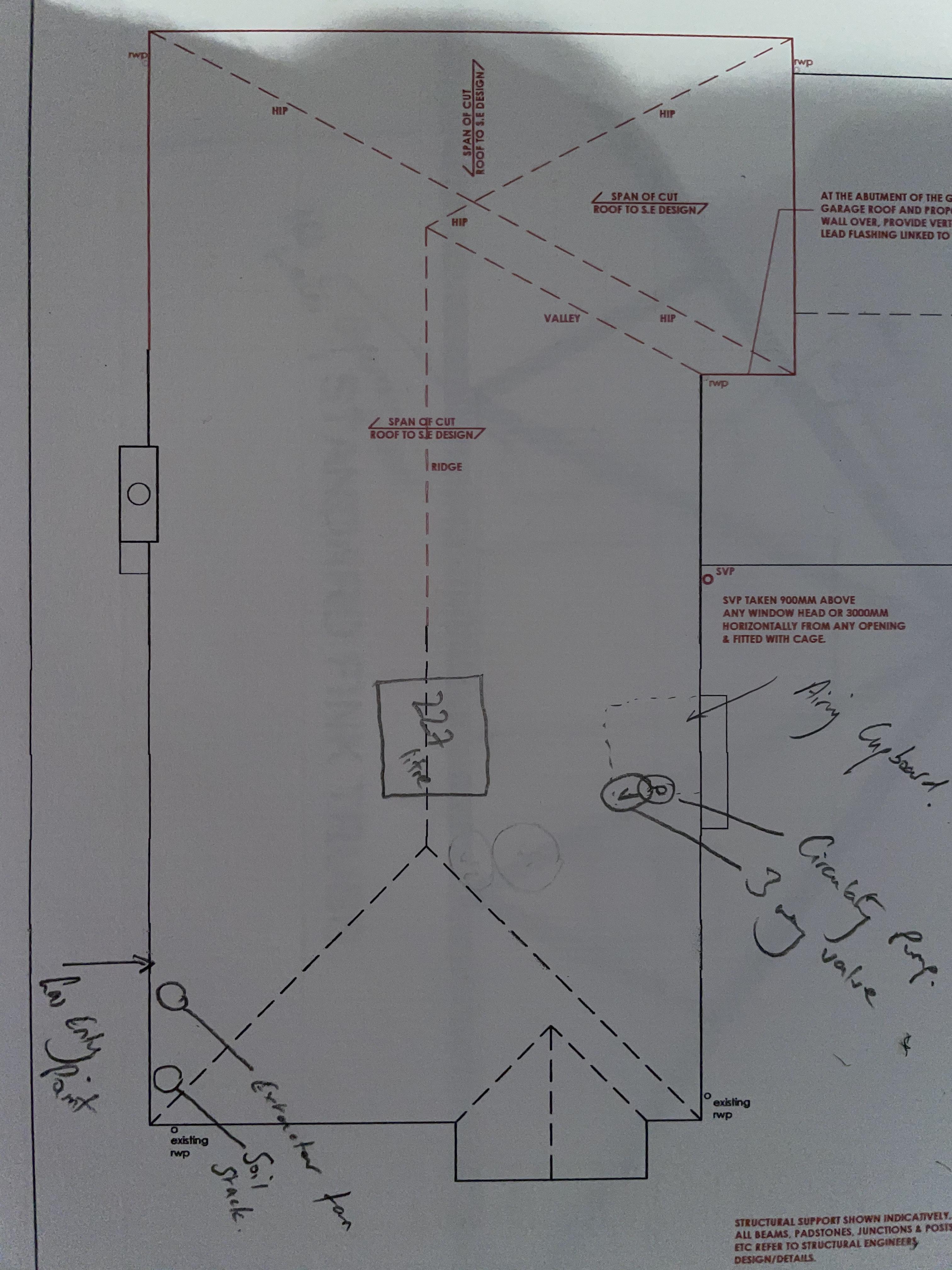

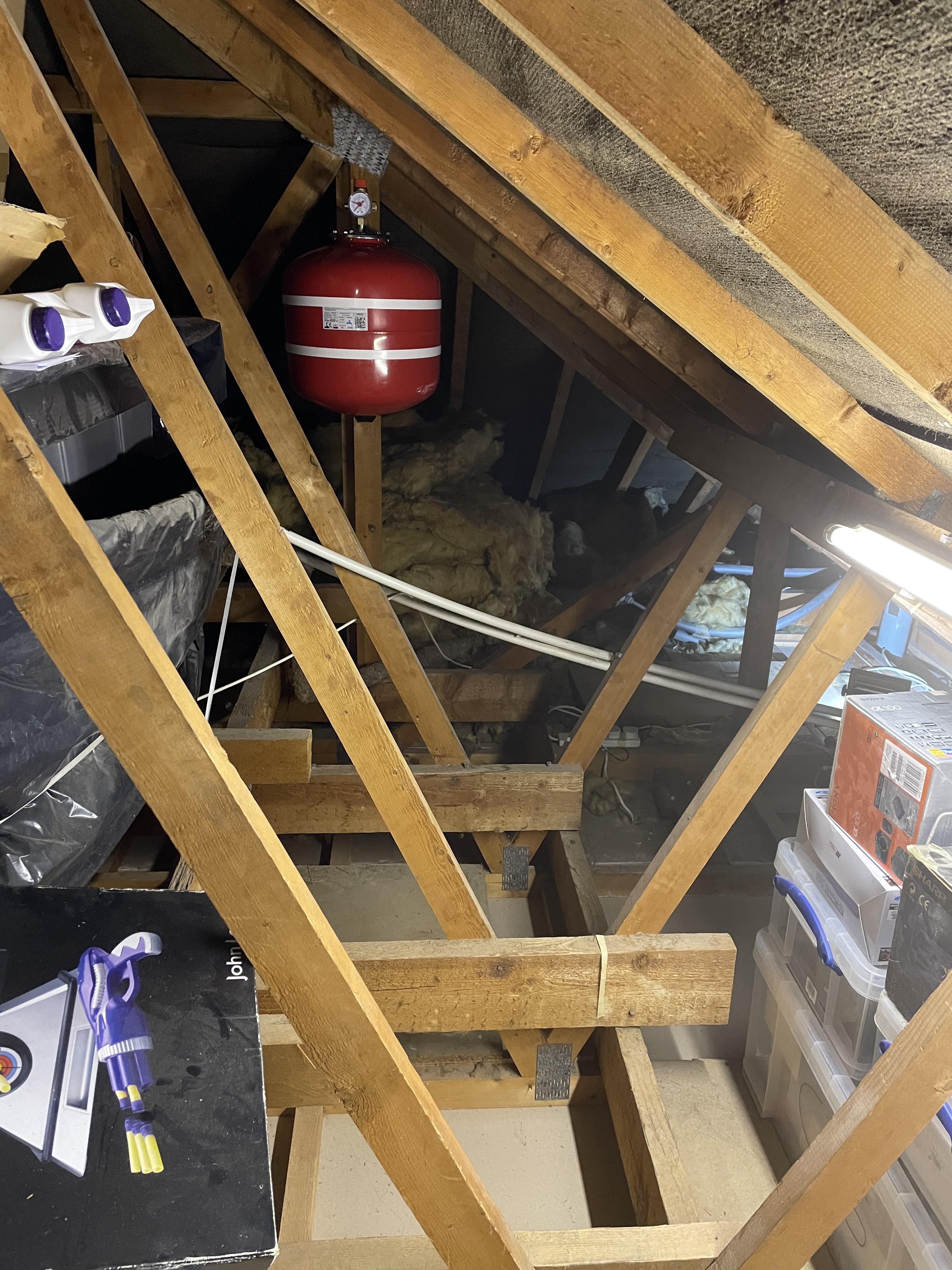

  13. I am in the process of getting my loft ready for (and doing some of the fitting of) a multi-phase process. An extension is being undertaken and the current heating and hot water system is being significantly changed. Currently we have an vented heating and hot water system, with heat coming from a regular 'heat only' boiler in the ground floor kitchen. An expansion / feed tank in the middle of the loft for this system, a pump in the airing cupboard on the first floor on the opposite side of the house from the boiler. There is a expansion / feed tank (227 litres) for the hot water cylinder that sits in the airing cupboard. The airing cupboard is going (it forms part of the new ensuite) and as a result we are swapping over to: Unvented hot water cylinder in the loft (to replace the 227 litre e/f tank) Unvented primary circuits on the central heating / hot water system, with the expansion vessel and filling point being in the loft. Once this is done we will then be moving the boiler to the loft (or installing a new one, not sure yet) and moving the circulating pump and 3 way valve up in to the loft. There appears to be only one sensible layout for the relative positions of these things in the loft. Mostly this is driven by where there is adequate support for the weight of the new unvented cylinder, and where the gas supply will be entering the loft. Having done the calcs, to allow for the 2x 45 form bends to get the gas pipe in through the soffit board and then onto a truss and then two further 90 degree form bends to get to the boiler, in the planned 22mm pipe the maximum length is 5.5 metres. Once allowance is made for the drop down and out of the soffit (before it mates with 28mm pipe from the metre) this only gives me 5 metres of length to get to the boiler, both in the horizontal and vertical axis. The bends required to get into the loft make running 28mm through the loft a nightmare and I am keen to avoid this. I am hoping to have everything ready to go for the boiler fitting on this conversion for a gas safe fitter to come and do the soldering of the gas line, and then connection of the pre-installed flow and return feeds, and of course the installation of the flue. When I say everything ready to go, I mean all the pipe cut to size, with the appropriate bends etc (not soldered where joins are required). Partly this is down to me wanting to do some of the work myself, but a great deal of it comes down to cost. There is limited budget for the extension, as with most things in life and I would prefer to be able to move the boiler rather than leave it where it is to save costs (the kitchen becomes a 'snug' room after the extension is done). So I guess the point of the post is to 'sense check' where I am planning on the various bits being installed, because it's going to be a massive headache if all of the water side of this gets done, and then it turns out this is the only place where the boiler can be. I have attached a couple of drawings of what is there now and what I am planning. The new boiler position would be just to the right of where the expansion vessel is now.
