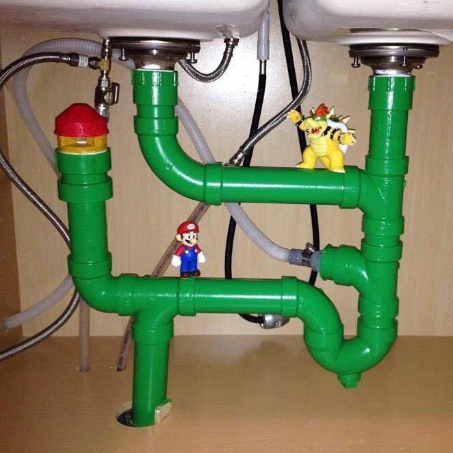

That's an interesting manifold setup - looks very 'continental'! (Is it Ikea?) The flexible pipe looks handy for routing, and I can only assume it is not at the same risk of blockages that such things on a toilet waste are given it being smoother (and a different type of waste material... with apologies to those reading this over lunch).
I must admit I do most (well, all!) plumbing in pushfit but I did a bit of copper and soldering in the last house and just about got on with it. I'm tempted to make a soldered up manifold outside the cupboard and then mount that inside and connect everything up. Thing is I haven't got a blowtorch anymore (lent it to someone... grrr) so that'd be an additional expense that I might not have need to use again. My backup was still to use copper but use compression fittings which many of the components would be anyway (eg isolation valves) so might still look okay.
I thought there might be, although the manual for our proposed dishwasher doesn't mention it (but I'm sure I'd read elsewhere it does). Whilst having it downwards facing (like yours) would make things a little more difficult for me it'd be playing it safe just in case and it won't become any easier to do this than right now.
Looks perfectly functional to me! You've reminded me that modern appliances seem to always come with anti-flood hoses so I must make sure I'm not too tight for space to accommodate them. Do you/anyone know if orientation matters?
I note you've used telescopic components too - I can see that they're really useful to enabling a neat installation lining everything up just where you want it.
That looks like a neat idea, and could make installation slightly easier as it'd give a vertical adjustment below the manifold in addition to those above it if I too changed the whole trap.
I've already bought a McAlpine space saver kit (it does seem good quality as you say) which I thought looked useful as it shifts most of the pipework to the back to allow more storage space within the cupboard. No AAV on the trap though... Perhaps one could be added to the centre spigot if required? That said, I'm not sure I've had gurgling issues before (elsewhere in the house I mean - this is a new kitchen in a new room), and this pipe run to the soil stack is fairly short so might that also help?

Does anyone have photos of their under-sink plumbing (of course you do) that you wouldn't mind sharing (maybe not)? I'm looking for inspiration as to how to lay things out... For what it's worth I've got a 1.5 bowl sink, mixer tap and dishwasher to cater for. My supply and waste pipes will be coming in from one side too. Your setup doesn't need to match though - I can cherry pick interesting features from anything I'm sure.
