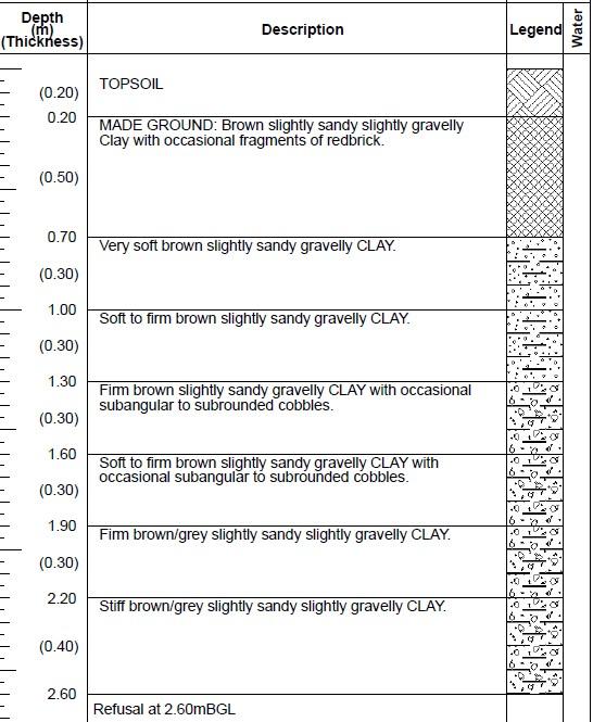

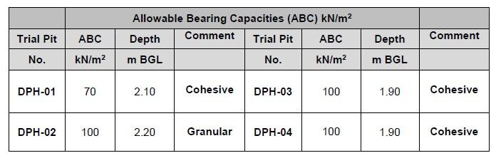

Well, everyone is back from holidays today and my Structural Engineer made a comment about the Ground Investigation Report I've been digesting all day. Turns out my soil is very poor despite hundreds of houses being constructed all over the rest of the estate 25+ years ago, I'm the one with a problem now! I'd have to dig / excavate nearly 2 meters of soil to reach sufficient bearing capacity which means my plans to start groundworks next month are almost dead. If you see results like mine....RUN!!

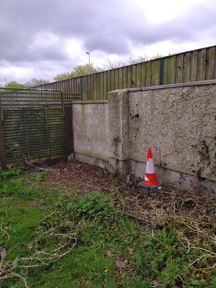

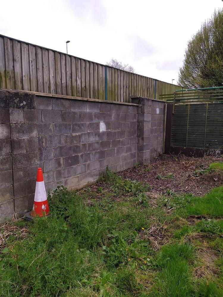

I've sent photos to the Groundworks lead as I've a house to one side 2.5 meters away which isn't too bad but the other side has a block council wall and would be 1 meter away, and 800mm where each of two buttresses are from the wall of the new house (see pics).
Anyway, I'll see what they come back with but the excavation would be 10m x 10m and 2m deep, risk of groundwater seepage, flooding, subsidence and having to shore up the walls to prevent collapse/damage would be required. I can see all those Grand Design houses coming back to haunt me!!
Piling / mini-piles are an option but with the close adjacency of several neighbours, are unlikely to be welcomed
A Kore Raft Foundation, a standard steel/concrete raft or strip foundations all require similar depth to get the bearing capacity from what I'm told.
Tip: If building get the Ground Investigation done EARLY!!!
I've reached out to a company that should be able to design a solution but their turn around due to workload is measured in months. I'll see if there are any other companies but screw piles are not common in Ireland, from the searches in this forum it's more likely in the UK to be required. But this would allow me to build a raft on top.
My house beside the site is up for sale, stuck on a legal issue currently and my planning runs out in August!! I'm guessing I'd be very lucky to get any foundations started before then and I've spent €15K on timber frame drawings and line loads to date. All expecting the site to sail through the soil test! At least I didn't try building after a trial pit and it subsides years later!!
I've asked the Architect for the cost of applying for new planning permission and I've an application in to extend the current one but that only allows you to continue building if you are up to wall plate by the deadline, expensive foundations don't count!!
I could probably reapply for planning myself at my own time and cost, just need to research a bit and hopefully am allowed use the original Architects drawings again. Either way the foundation costs are going to be more than I expected but plan B is to pull out of the house sale, sell the site or move elsewhere! I was thinking Thailand?! Anyone want to join me!!

Hmmm, that's very curious. What kind of soil is it (should be on the report)? Has your BCO been able to throw any light? They usually know what kind of founds are OK in each area they deal with.

The thing that stands out to me is the 'refusal at 2.6m' - which suggests something hard and amply load bearing (and therefore helpful). You're using Tanners (as lots of people on BH do and given that they're based in Ireland)?

I don't know the detail of course, but I think the design is cautious.
100kN/m2 is perfectly normal and takes standard footings.
70kN/m2 is not great but should be ok. Making footings wider spreads the load and is preferable to taking the whole area out.
So I would be proposing standard trench footings at 1.3m.
70kN/m2 is also fine for a floor slab...nobody will fall through, otherwise it wouldn't be safe to walk in the garden. Therefore the ground between footings can stay in place.
Yes have  a chat with the BCO.
What would be necessary is close inspection of the excavation as it proceeds, perhaps tending higher or lower as the ground is exposed.
Perhaps the SE is avoiding the uncertainty, which some clients would prefer.

To be cautious, I would also go with the piles assuming that the 2.6m wasn't just a single lump of something / wait for Tanners to catch up (bug them a bit) / do my planning re-application in the meantime. The latter should just be a case of filing the same docs with a prominent one page note explaining the history. You should be able to download and check the old docs and file them again yourself in an hour or so. Check with your planning officer that nothing has changed and ask nicely for the LPA to process the re-application quickly? Probably other things for you to be getting on with anyway - services?

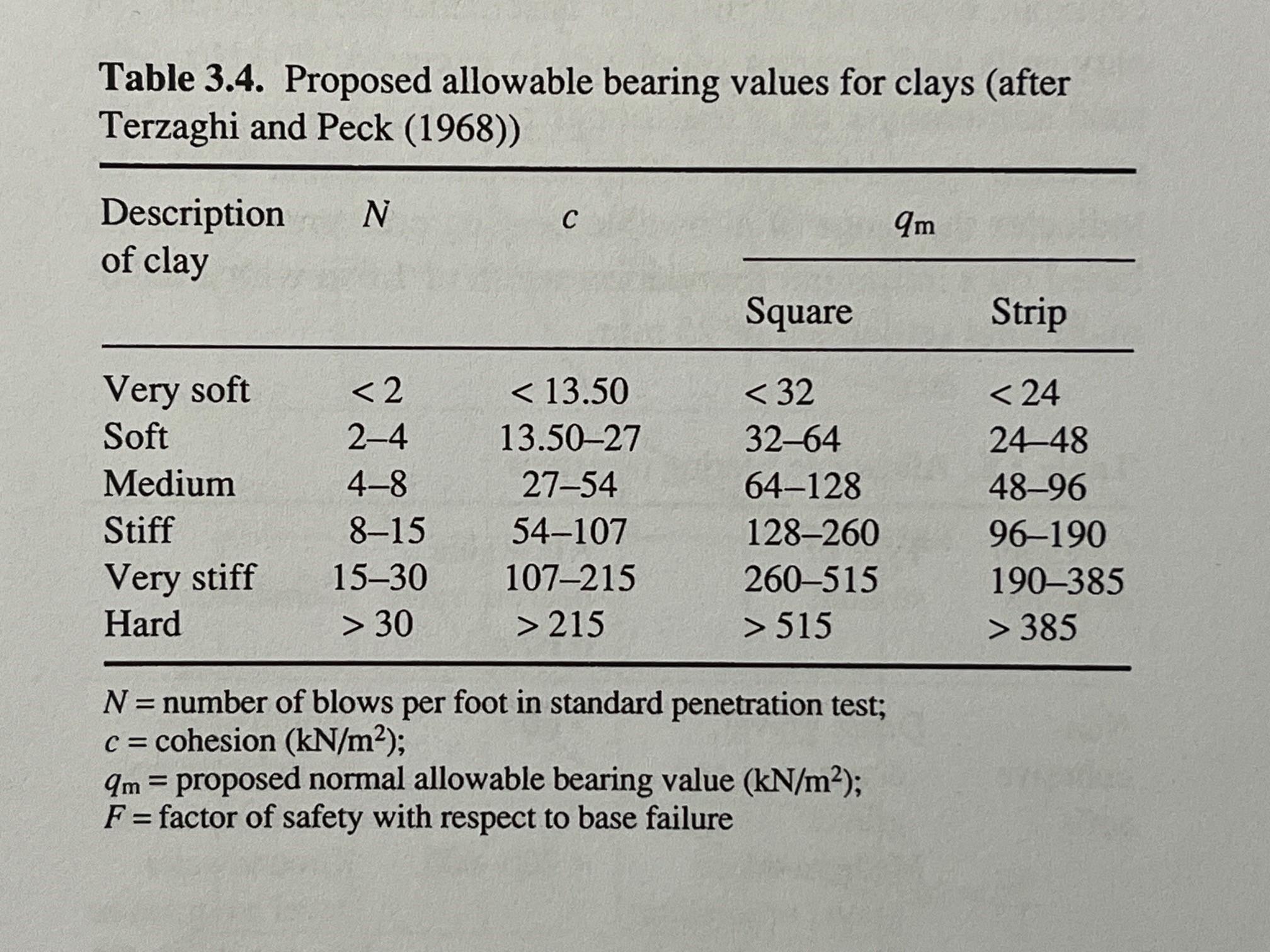

I just came across this table in Atkinson for clay soils - it suggests, as saveasteading says that 70-100 kN/m^2 (see column c) is OK i.e. 'stiff clay' for standard foundations. Begs the question of how heavy your design is, of course.

5 hours ago, mike2016 said:
the Architect is likely to charge 5-8K as my guess
So diy or change.
In case an explanation of basics helps..
There will be a load coming down your structural walls, measured in kN/m.
Say it was 50kN/m and the ground capacity is 100kN/m2, then you make the concrete foooting 0.5m wide.
But if the capacity is 50kn/m2, then you need a base of 1m width.
The floor is separate and can sit on much weaker ground.
If your project is several stories high, with very big rooms,  then the wall loadings will be very high, and it would become technical and expensive.

So my Civil Engineer says there's a lot of "made ground" and we should look at strip foundations to 2.2m rather than Piles. Just needs to be dry and ideal weather etc and we should get this done ok. Next up is to talk to a contractor he knows to see if they are interested.

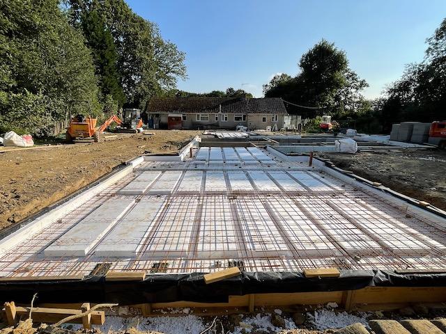

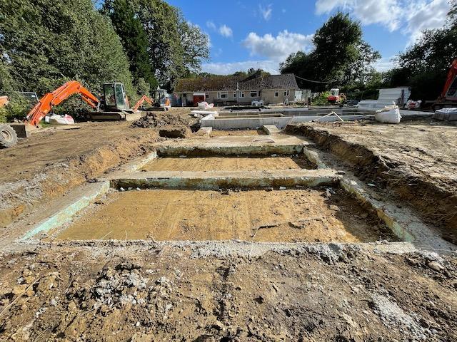

we had strip foundations dug to 2m on the 'arms' of our build (the bits without a basement underneath) and then put an insulated raft on top like these photos show. it was designed by TSD so maybe give them a chance to come up with a design?
IMG_1176.jpeg.e3833df54e75a48d53924808245863f8.jpegIMG_1264.jpeg.3f25ad840bea92245a980265cce4bf2a.jpeg
Link to comment
Be aware that if you go for piling these can go much deeper than the survey refusal depth. My ground investigation stated refusal at 2.6m, piling contractor quoted to 3m, most went between 7m and 9m!
They charge per linear meter over quoted depth at a cost of £65 per meter for us, we overspent on the piling by £9k!
Bitter pill to swallow but knowing how much concrete and steel went in the ground safe to say it isn't going anywhere!!
We did have the option of 2m deep strip foundation but the cost of getting rid of the spoil meant we just went with piling.

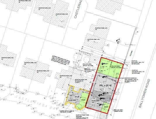

Stop press, mike2016 has PMd me a site plan with annotations. There are trees close to the building, so footings have to be deep near the trees. It doesn't change the solution too much.
I don't think we knew about the trees before, but the SE had allowed.
Whether the floor can be ground supported is debateable. I think it is unikely to be affected by the trees once encapsulated by the foundation.
