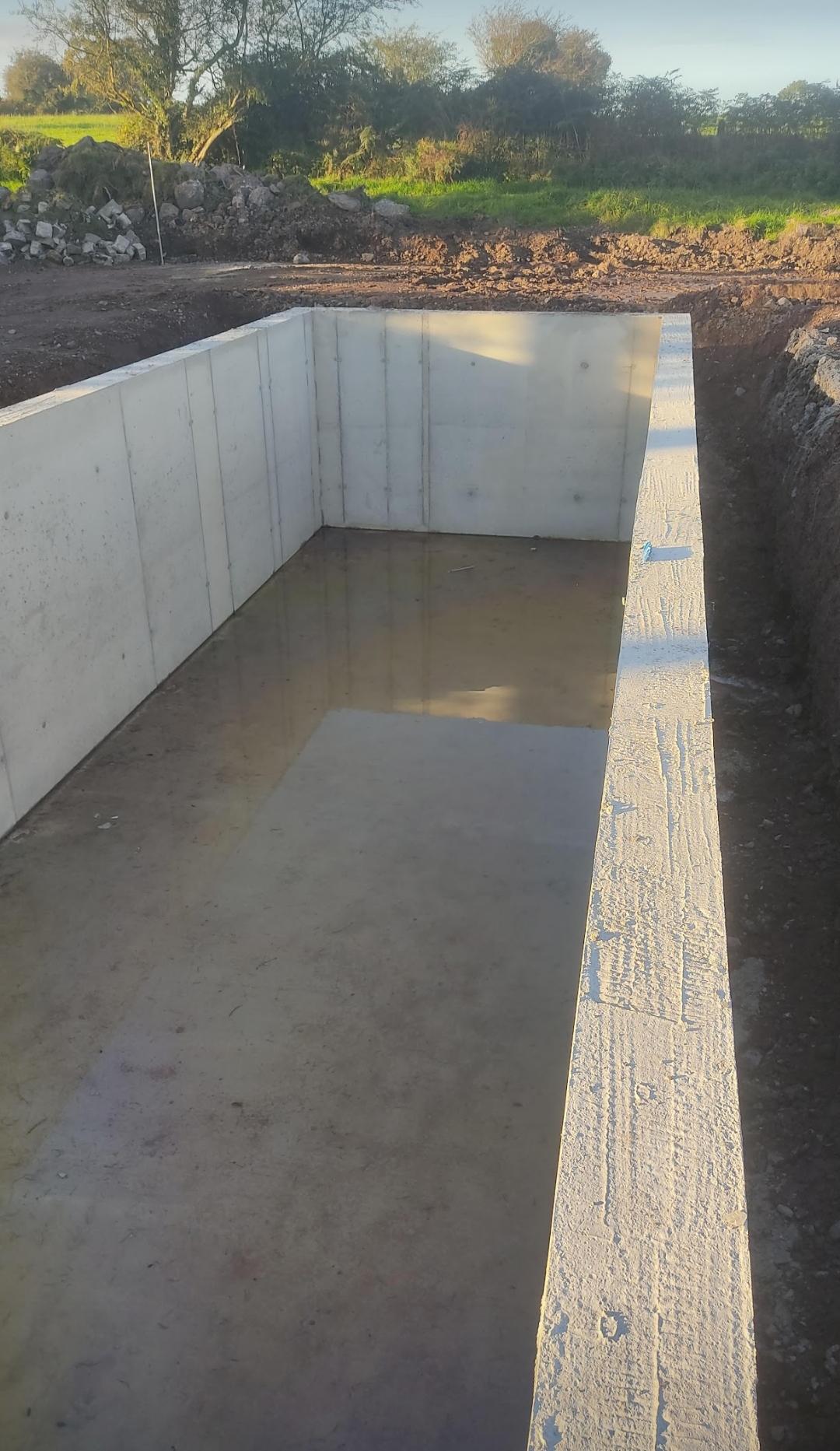

It depends on site value I guess but if you had to put 2.6m concrete "walls" into the ground it would seem a missed opportunity not to put a floor in too. A sump and pump and you're done, even just as storage area/plant area.
A contractor built me a 4.6m X 17.7m X 2.7m deep slurry pit in 2020 for €17.5k.
Screenshot_2023-04-13-12-46-22-260-edit_com.google.android_apps.photos.thumb.jpg.c960a76b511a3408368d6089e081fd8d.jpg
  • Like 1
Link to comment
Nice work and price. But add waterproofing the walls and base, muck away, the stair, fire escape provision,  and it is expensive for a wine and potato store.
