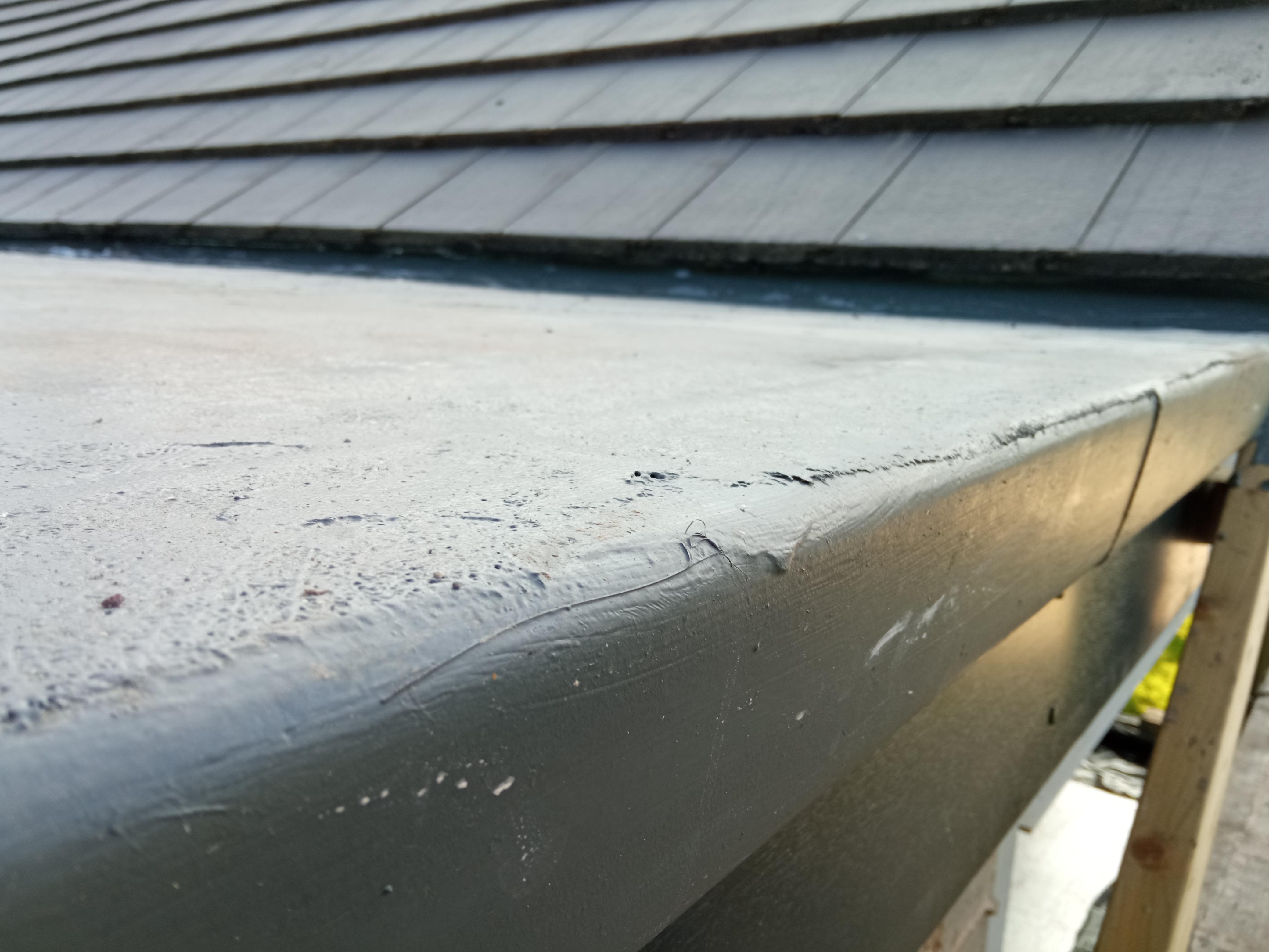

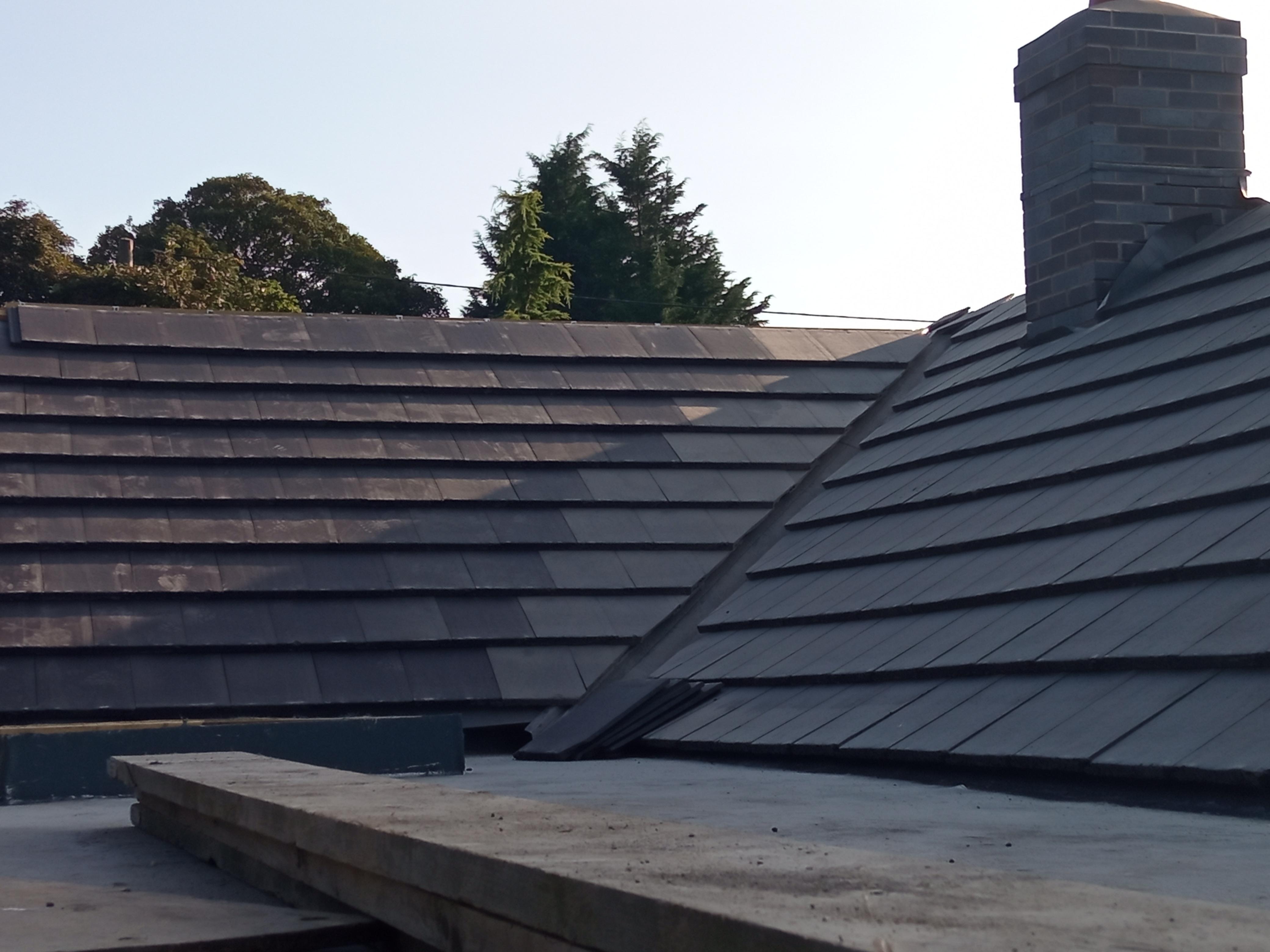

Here is the current GRP as it stands, comments welcome because I don't know if I'm being over picky but I want to be prepared for meeting the builder this week so please give me your opinions.

The main laying up of the GRP does not look to bad, just the edges and corners that look rough.
Basically what they did was use the cut edge of the roll on the trim.  They should have used the torn edge.
It is hard to tell if the trim was properly prepared before they started as they seem to have tried to cover up mistakes with extra flowcoat.
Not a hard job to put right to be honest, just a bit time consuming and messy.

I would get the angle grinder out, sand off all the problem areas, then re-GRP those areas.
The external corners are always going to be a problem, would probably use a glass tape on them.

As someone who has done GRP roofs myself that is shoddy work, but as @SteamyTea says it’s fixable. Another example of Some tradespeople not paying attention to detail.

It might be fir him but not for most people (me included) an angle grinder and a flap wheel to take off the rough bits (as long as you don’t go right through, but even if you did it’s patchable) and a bit of topcoat will fix it.

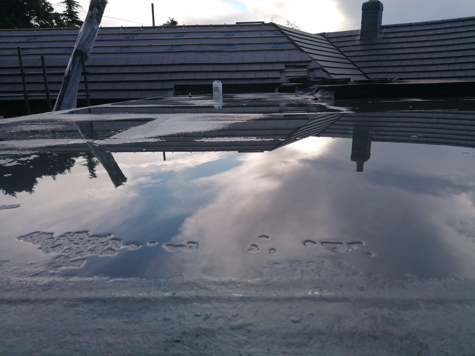

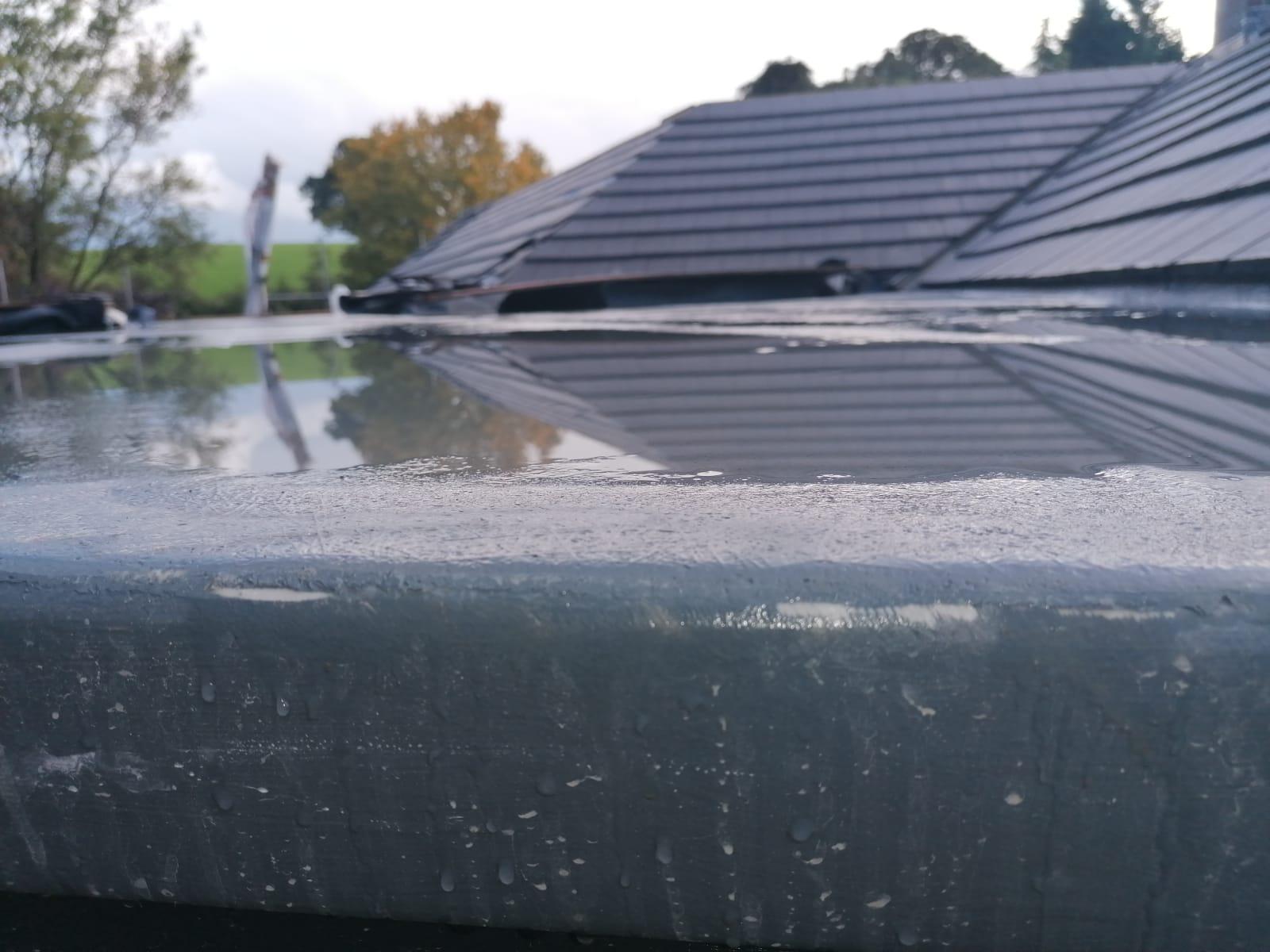

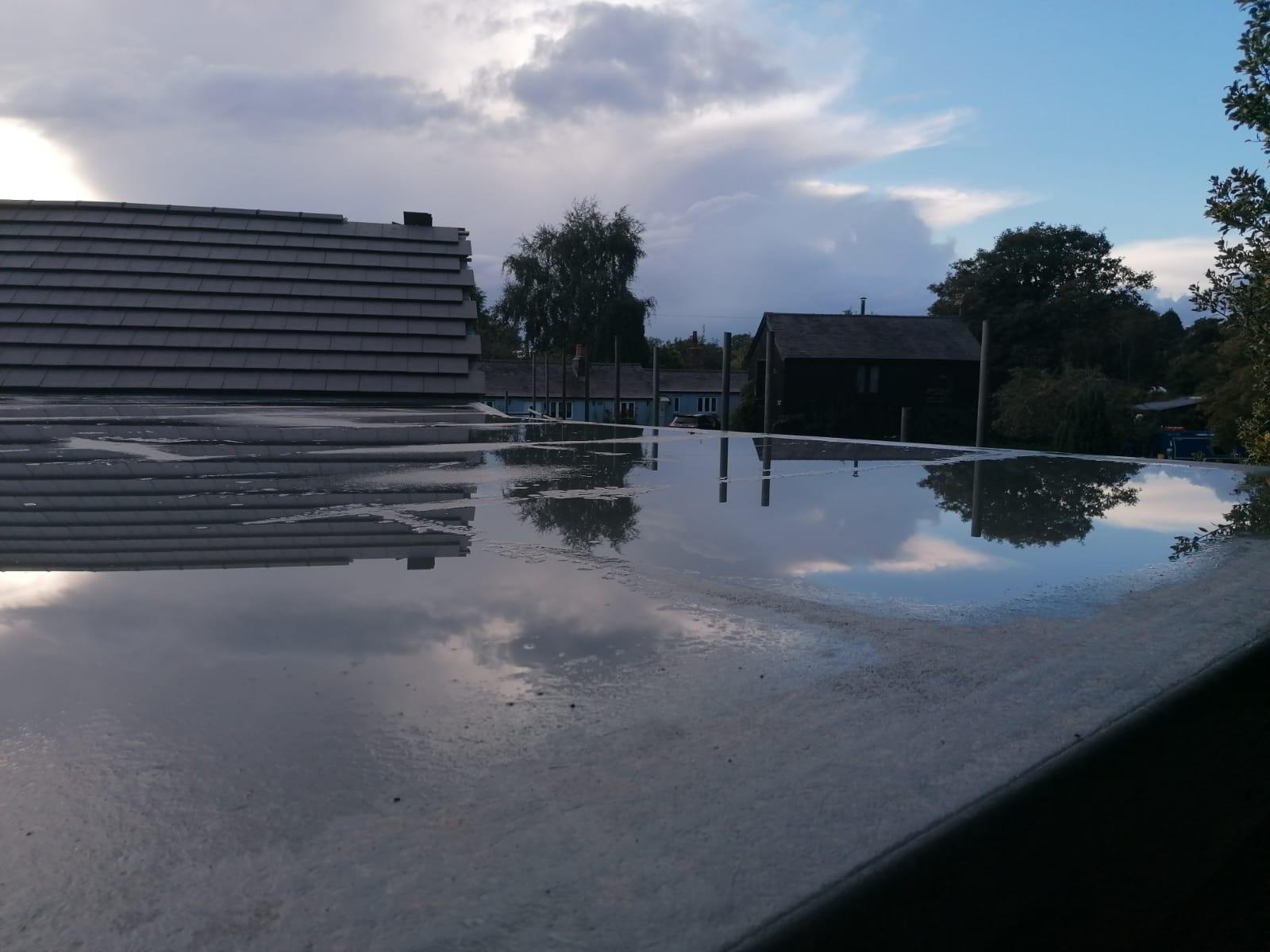

hoping for some advice. Still no rectification to the roof as yet but after a heavy downpour today and a visit to the site I went to inspect the roof. And this is what's happening.... Clearly this needs sorting as it looks like water is already penetrating...... Any words of wisdom? Surely now I can't be told this is normal??IMG-20200924-WA0032.thumb.jpg.c040f0f1c69fce40bee1c3f6918c3185.jpg
We also have definite pooling of water, albeit we have no guttering.

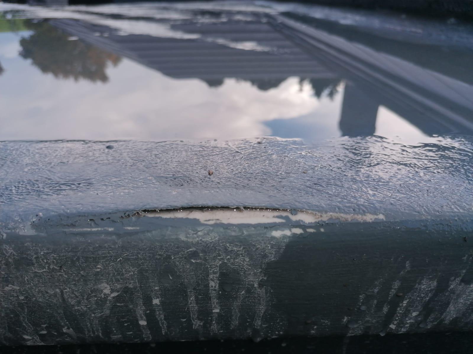

Even on another part you can see it starting to lift IMG-20200924-WA0031.thumb.jpg.5a1f84159f4089e23496c2042301b4bf.jpg
joe90
Posted
The pooling is not a problem but the “delaminating” from the trim is wrong, make sure you photograph every area where this has occurred. @SteamyTea will be along in a moment to suggest it’s remedy (that the roofer should do). Don’t know if it’s luck or judgement (hopefully the latter) I have never had that happen on a roof I have done.

I know others are a fan of the old GRP. I could not live with that. I would be having that whole roof ripped off. I have built atleast 20 flat roofs, and i have never built One Flat, for the reason that, regardless of what you cover it with, it will look like yours. I am not saying that it won't be ok, but it looks dreadful. What do your drawings say ? have your drawings asked for a flat roof, or do they show a fall, constructed by perhaps firing pieces. If your drawings ask for a flat roof, then that is what you have got. If your drawings ask for a flat roof will falls, i would make him rip the whole lot off.
