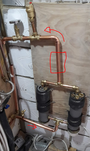

Willis Heater approach
So therefore looking to heat the UFH with 2x 3Kw willis heaters in order to progress with the internal house work. Thought I'd add some info on here as a lot of people like myself aren't familiar what they are. They originated out of Ireland and still much in use over there. They're essentially external immersion coils and instead of sitting inside a tank are simple external electric units - AKA "Willis jacket", "standard sleeved immersion heater"," inline electric heater". Googling should get you something like this:
Willis Immersion Heater | Shell & 3kW Element
Item Weight 1.15 Kg
Product Dimensions
30 x 9 x 9 cm
I have tried to get plumbers interested in rigging this up, but they're either not interested or have told me it's not possible/don;t know what a willis heater is. I've managed to plumb in all the Hep2o in the house, so hopefully this won't be too much of a bodge.
@TerryE has kindly discussed his set up which is pretty impressive with his DS18B20s set into the walls etc. I'm no programmer and my javscript is mainly simple web stuff and wanting to get heat into the place ASAP, I just want a KISS approach for now. Perhaps later I will think about having some of it programmed using Terry's Node Red option which makes for interesting possibilities. Get a feel for Terry's approach here:
But as I've said, I'm after a bog standard dummies approach to this - seriously KISS:
So rather than wiring up room thermostats to the wiring centre, I will for now simply use the Willis inbuilt thermostat and set that to gradual increasing temps from 10oC up to a max of 25oC. A gradual heat increase seems safer in my mind. My only concern is if the Willis thermostat fails and carries on beyond 25oC - up to max temp. Obviously I will have the manifold mixing/blending valve that should restrict temp flow into the UFH also, but is there a further failsafe to consider?
Dummies layout.
Eventual Sunamp units (for DHW) will be located on left of manifold so having to locate Willis heaters to right  and expansion vessel top right:
FYI: The immersions need to be turned the other way (so colder water enters the side)
Parts list:
  • 15mm copper pipe. The Willis heaters are 15mm so I presume plumbing them into the manifold with 15mm would be okay?
  • 15mm plastic pipe for cold return should suffice I presume?
  • Bottle vents - automatically release any trapped air (like this one). Do I need any and if so where do I place them?
  • Willis heater (ebay has the cheapest)
  • Expansion vessel - 8litres sufficient for total UFH volume of 130L? (like this one)
  • 20A DP switch outlet (for each willis) from a 16A MCB (like this one)  . Probably one for each willis
  • Immersion timer (like this one) to be added possibly when I change over to E7 low tarriff rates
Will get an electrician to wire it all in for me!
Be grateful for comments, suggestions and any answers to above questions!

Question for the experts. Can I use a flexi braided steel tap type connector to join up the copper to the manifold? Most of the flexi's I have seen will operate up to 10Bar and temps of 85 degrees. The willis setup is most likely going to be a temporary set up ( and likely will be used as a backup if ASHP is out of action) so be handy if I could just disconnect the whol willis side of things by using flexi's. With the current arrangement it's also a pain in the backside to solder and place all the copper, only for me to have to cut the pipework later on again for ASHP connections.
dpmiller
Where is the pump going??
oranjeboom
Was going to rely on the UFH manifold pump.
The manifold pump only pumps around the loops though.  You'll need a pump to push water through the heaters as well.
dpmiller
Yep. I was able to mod my manifold to get flow out into the Willis, but only because a. it had a bypass and b. said bypass pointed at the return of the Willis. And I have the Willis underneath the manifold so have the chance of convective flow anyway.
You'll need a pump...
unless... where does the braided hose at the far right go? Tee into that and connect to the bottom of the Willis, and go from the top of the heater to the supply into the manifold. Cap the return. Sme of your flow will be diverted through the heater and the mixer will then sup heated water.
oranjeboom
Bugger! Wish someone had spotted that at the beginning.
Will see where I can squeeze the pump in.
That's a filling loop connected to the mains -  I will need purge all the loops of air. Also need to get a bit of copper in there still to the expansion vessel (out of shot).
So what pump should I be looking at?

Because the UFH pump only pushes water around the UFH loops, it doesn't normally push water around the primary pipe loop.  The primary loop can be shut down or restricted and the UFH pump can continue to push water around the loops.  I use this feature to equalise heat around the floor, by running the pump when the ASHP is off.  It works well to even out the floor temperature, by drawing heat from areas of the floor than might get warm from solar gain and moving it to areas of the floor that are cooler.
oranjeboom
Right then, so adding a pump on the feed pipe into manifold, just above the willis heaters:
Would that work? It's the only bit of spare pipe I could tap into really.
And there's a Wilo glandless circulating pump going at a decent price at BNQ. Will that do the job?

If you get rid of the mixing /blending valve and manifold pump you could revert to just having one pump. According to what others have said the Willis heaters should regulate the temperature, doing away with need to blend?
PS - Ive just ordered bare manifolds and will connect these up directly to the Willis heater and use a standard recirculating pump set up. Ill set a low temperature on the Willis and see how it works.

Jeremy, there's absolutely nothing stopping anyone putting the Willis heaters in the manifold loop apart from preconceptions. See my set up. In this configuration you aren't using the manifold TMV for mix down, and I have mine cranked fully open.  The only reason that it's there is because it came with the kit and acts as a connector.

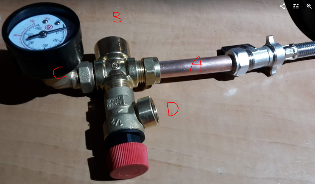

Right, almost done here with this willis setup. Just need to plumb in the expansion vessel. Have 15mm pipe tee'd off from the willis return pipe. But bit stumped on what to do with the expansion vessel. Fill loop is obviously a temporary connection (A), pressure vessel on top (B) pressure gauge (C) on the opposite side and pressure relief valve at bottom. So I presume I need to add a bit of pipe from here  (D) that will act as discharge pipe? So where does the 15mm from willis setup get plumbed into? Confused....
Onoff
...so have you got a sealed system?
oranjeboom
Yes. This is for my UFH willis setup, not for DHW:
dpmiller
tee it into A or B
