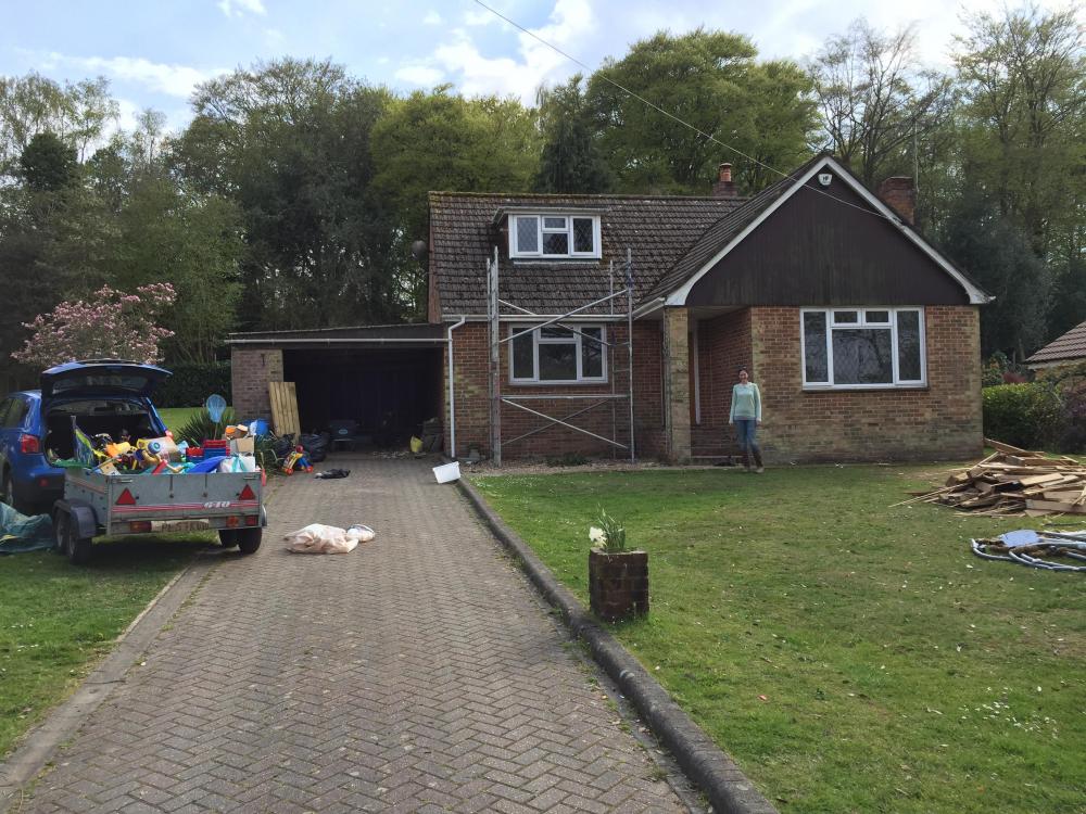

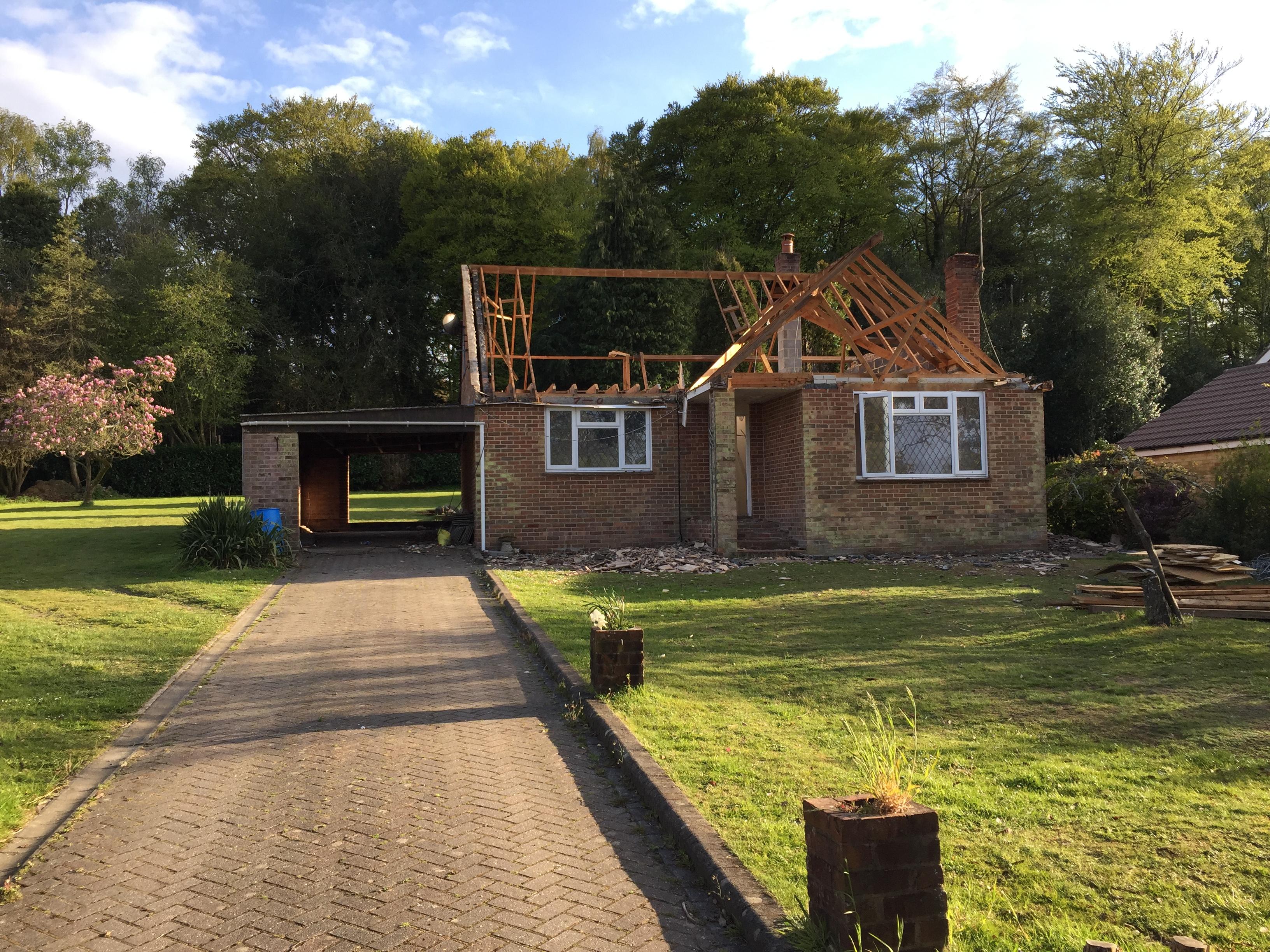

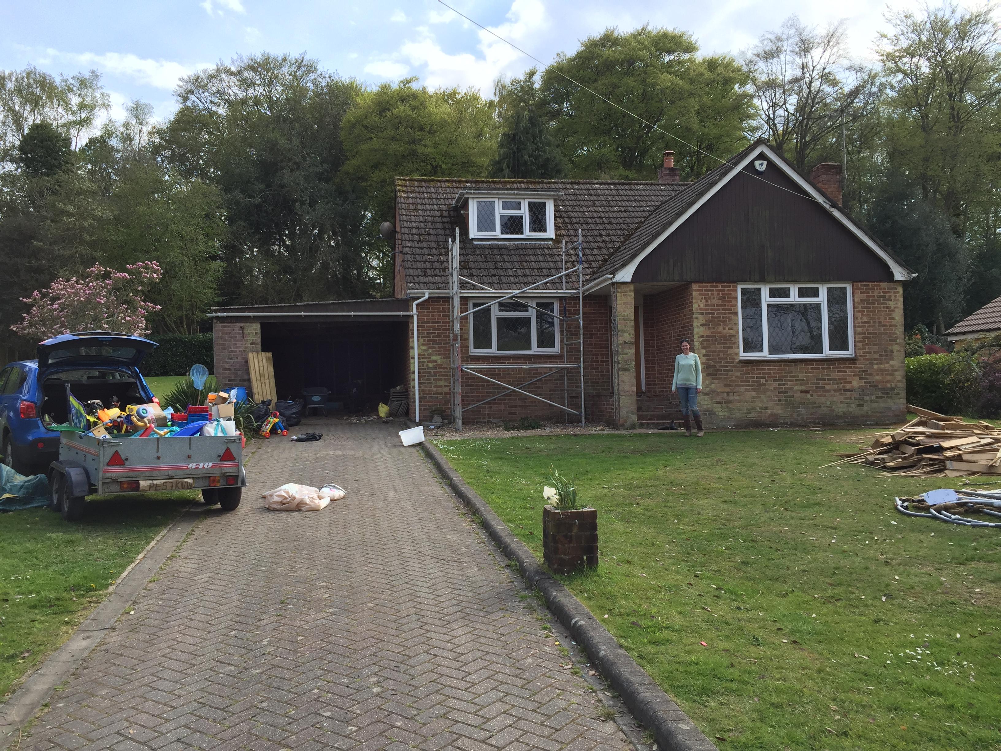

Dan1983 Posted May 10, 2021 Author Share Posted May 10, 2021 And so it begins! Link to comment Share on other sites More sharing options...
Dan1983 Posted May 10, 2021 Author Share Posted May 10, 2021 Link to comment Share on other sites More sharing options...
Dan1983 Posted May 10, 2021 Author Share Posted May 10, 2021 (edited) embed image gallery in website Edited May 10, 2021 by Dan1983 Link to comment Share on other sites More sharing options...
Dan1983 Posted May 10, 2021 Author Share Posted May 10, 2021 Did look down the route of ASHP, it was going to add approx 10k to the build unfortunately. Possibly short sighted but decided to stick to gas and up spec insulation to pass SAP so no renewable energy needed. 1 Link to comment Share on other sites More sharing options...
Dan1983 Posted May 16, 2021 Author Share Posted May 16, 2021 Link to comment Share on other sites More sharing options...
