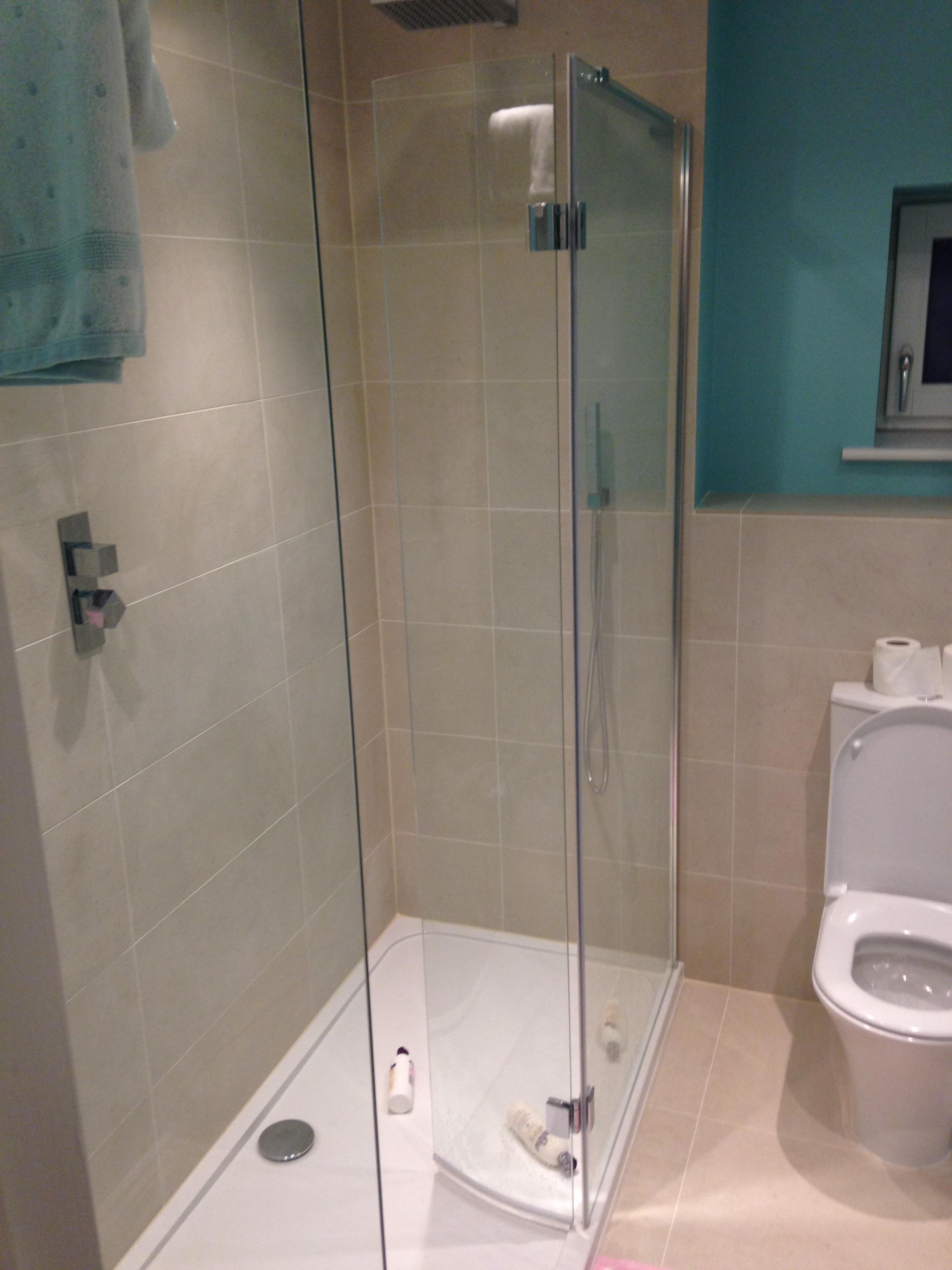

This is an infold door, just two of them. If you zoom in on the tray edge you'll see a chrome threshold that I butted up to the raised floor tile. That is about as frameless as you can get without having a Wetroom.
Those doors came with the receiver that would have gone opposite so it could be fitted in an alcove. They got ditched and the square magnetic strips got switched out to ones which were at 45o. Both got supplied as it's an universal setup eg it could have also gone against a fixed glass side panel ;)

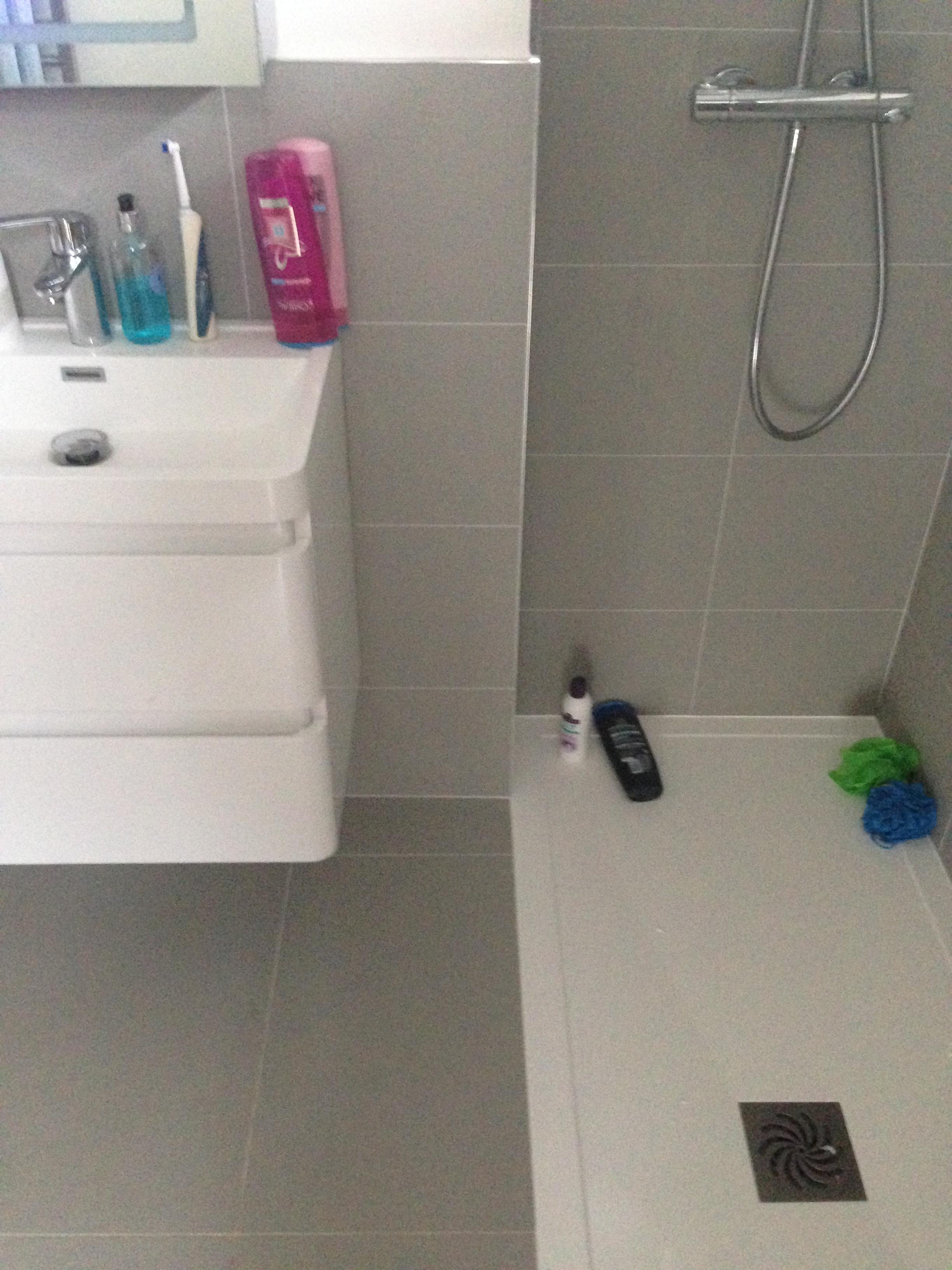

We put a 25mm tray in one bathroom and an Impey wetroom former in another (primarily to resolve joist / drain positioning issues).
We made a last minute decision to add electric UFH mats to the bathrooms (which have been a big success) so the 6mm backer board plus the mats, latex, adhesive and tiles allowed the tray to sit completely flush, looks great.
Wetroom tray also looks great with a nice envelope cut tile vs using the metal angles that Impey provide.
Have taken some pics, will upload when I get 5.
