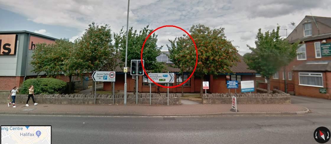

Ferdinand Posted May 16, 2019 Share Posted May 16, 2019 (edited) >(* Piccie to be added) Here is a piccie of one of our fairly local Drs' Surgeries. The trees were there first iirc. When you give people free money, they stop thinking. So don't give them free money. Suspect this is due to some grant scheme being available, or perhaps due to the days when manifestly excessive FiT encouraged silly projects. Edited May 16, 2019 by Ferdinand Link to comment Share on other sites More sharing options...
ProDave Posted May 16, 2019 Share Posted May 16, 2019 5 minutes ago, Ferdinand said: >(* Piccie to be added) Here is a piccie of one of our fairly local Drs' Surgeries. The trees were there first iirc. When you give people free money, they stop thinking. So don't give them free money. That is very much like our house, which is why I went for ground mount. Although at this time of year the sun is high enough that for a lot of the day roof mounted panels would do alright, but in the Autumn when the sun is low they would suffer massive shading. Link to comment Share on other sites More sharing options...
Ferdinand Posted May 16, 2019 Share Posted May 16, 2019 Just now, ProDave said: Although at this time of year the sun is high enough that for a lot of the day roof mounted panels would do alright, but in the Autumn when the sun is low they would suffer massive shading. Indeed, but I would say that those trees will grow rather larger. F Link to comment Share on other sites More sharing options...
