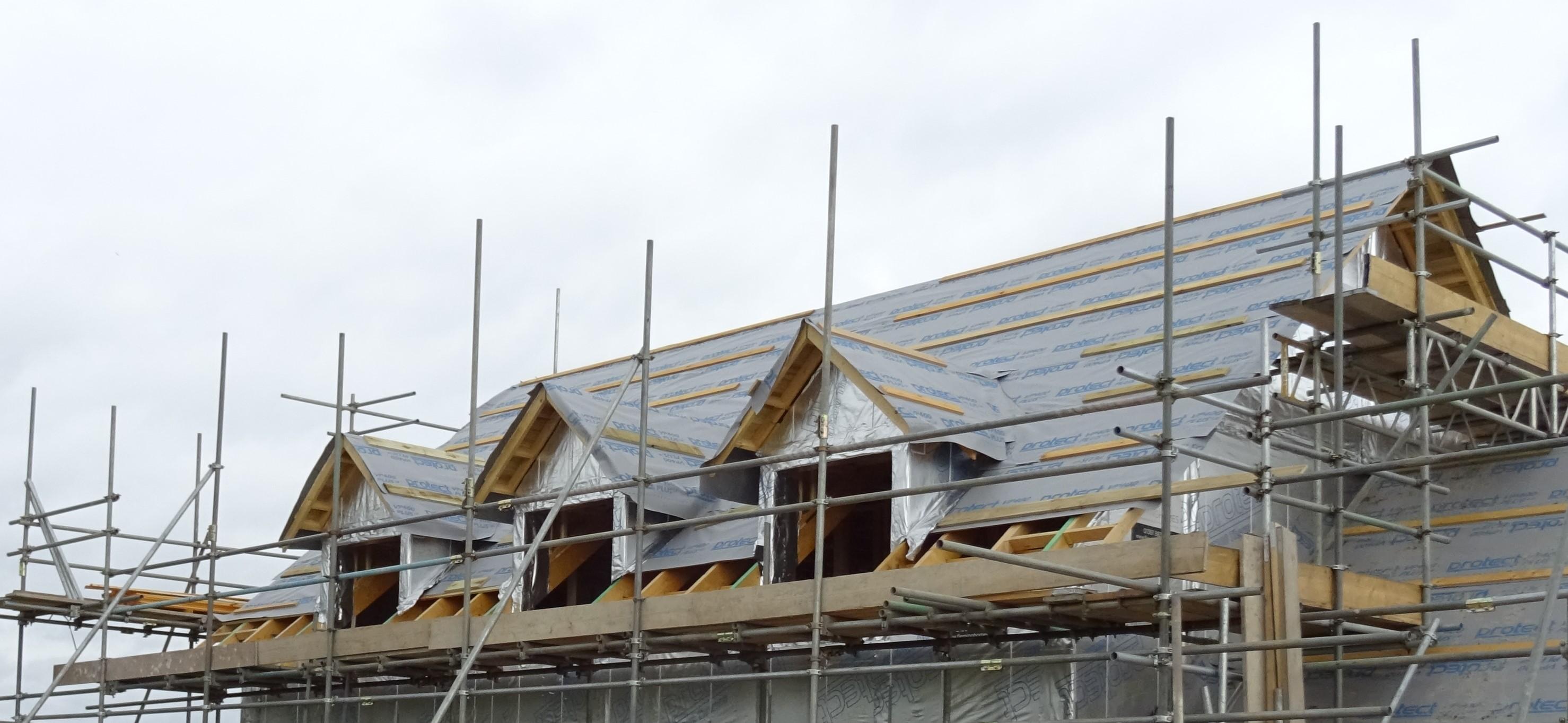

Our old 1920s bungalow had T&G sarking boards covered with roofing felt and slates nailed into the sarking. Our new roof has 15mm OSB3 raking/sarking covered with Protect TF200 thermo membrane then 100 x 50mm rafters with 50mm Rockwool between and Protect A1 tight over the rafters then NuLok roofing.

Hope this helps. Nothing like a photo to assist. It shows our roof having been fixed with Sarking and then a "loose" or floppy fitted membrane attached.
