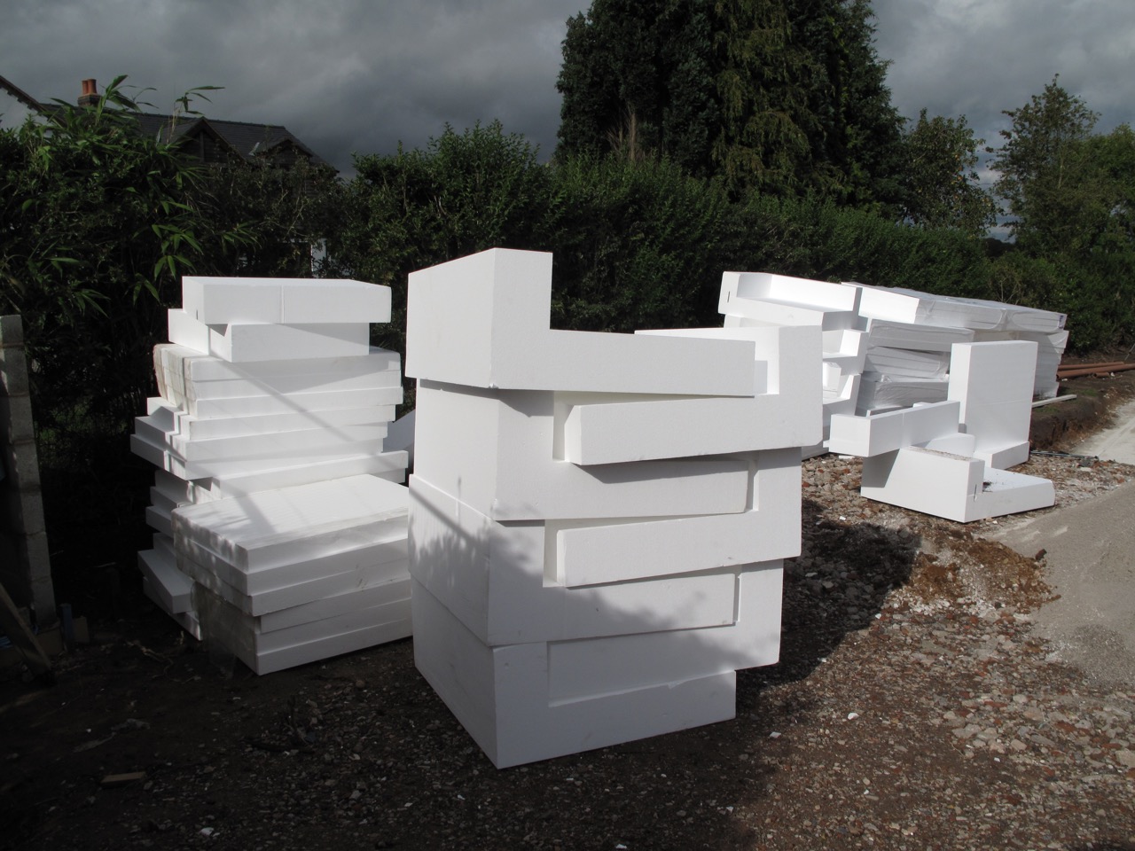

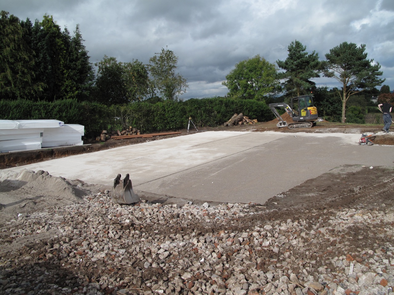

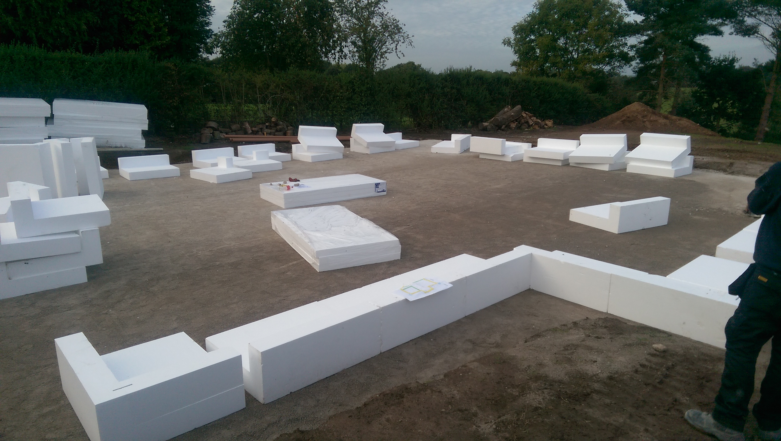

worldwidewebs Posted September 27, 2016 Author Posted September 27, 2016 MBC are on-site! https://selfbuildnoviceblog.wordpress.com A bit of a potential cock-up along the way but hopefully all sorted
DavidFrancis Posted September 27, 2016 Posted September 27, 2016 When I first looked at this I thought you'd inverted the usual arrangement and put the slab UNDER the EPS! (It's the grey sand that did it.)

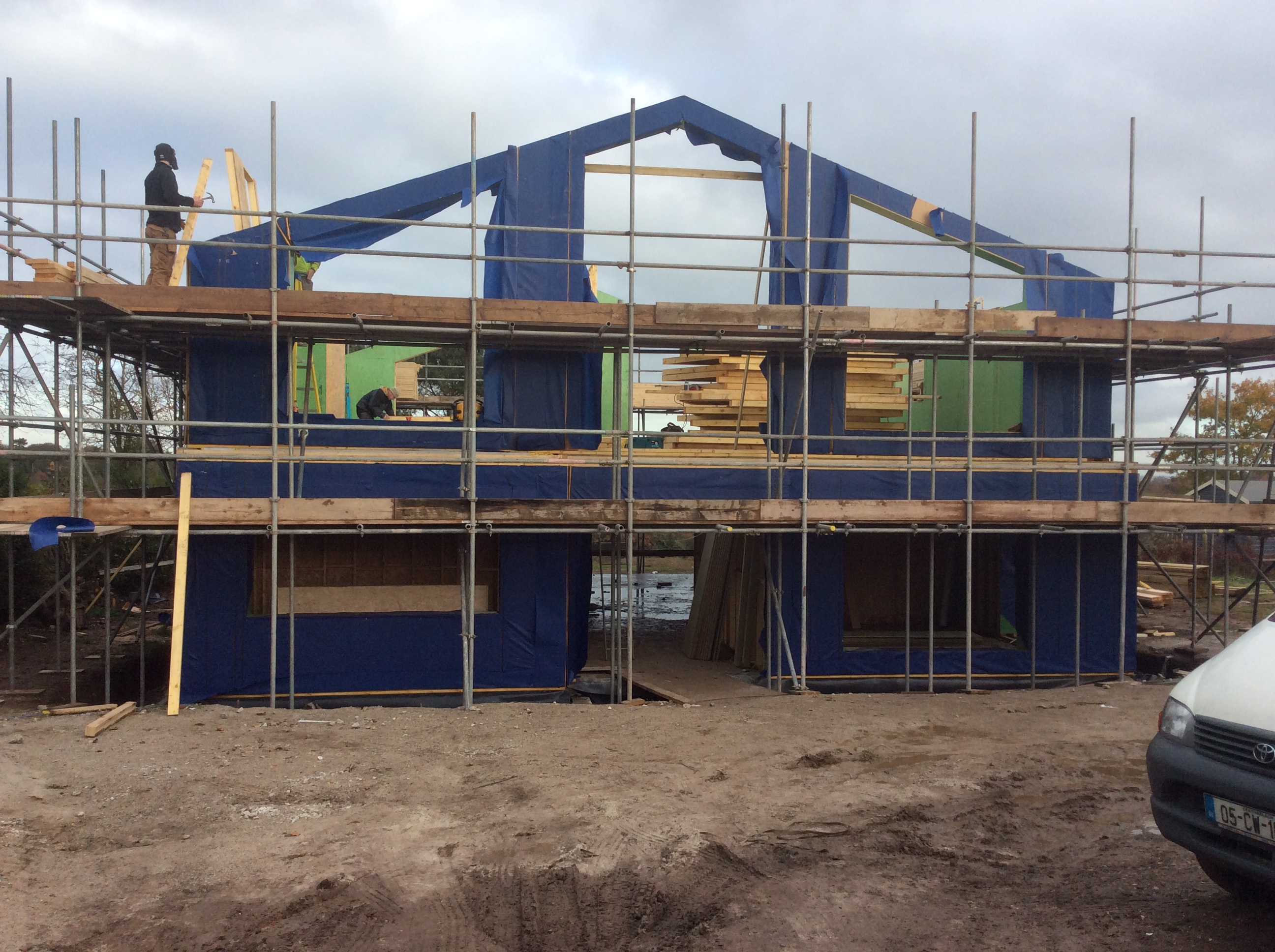

TerryE Posted September 28, 2016 Posted September 28, 2016 (edited) @worldwidewebs, I went through your blog. Very interesting. Thanks. I see that MBC have continued to evolve their cassette design and techniques. Your cassettes had the VCL OSB pre-fitted whereas our cassettes only had the outer Panelvent fitted; the VCL was delivered in sheet form and fitted by the erection crew. I know that Jeremy eulogised about the frame tolerances, but ours was out by ~1cm on a rear gable. I don't blame the crew and we are happy with the end result. (The frame was erected in shitty November weather.) One issue was that the cassettes were fixed directly to the slab, and getting these mm perfect is hard when its raining and a bit blowy. I thought on reflection that it would have been better if a separate sole plate had been laid first to register the exact cassette positions, and I see that they now do this. Good. But overall we are delighted with the final result, and I hope that you are likewise. Edit: Sorry this is a cross post as I also read @Alex C's blog Passive House Selfbuild, which you might want to compare with your experience. I will be very interested in the some of the frame detailing on your build. Edited September 28, 2016 by TerryE
worldwidewebs Posted September 28, 2016 Author Posted September 28, 2016 (edited) @TerryE - Sorry, I didn't understand much of what you said What's a cassette? VCL? Panel vent? Where are you getting your info from regarding the evolving design? I'm very much learning as I go along and so far they are just fitting the EPS. One problem is that there is only Tom on site plus a young chap on his second site! I'm not sure if this will affect the quality of the install or just the timescale, but it's not what I was expecting tbh. Edited September 28, 2016 by worldwidewebs

TerryE Posted September 29, 2016 Posted September 29, 2016 17 hours ago, worldwidewebs said: @TerryE - Sorry, I didn't understand much of what you said What's a cassette? VCL? Panel vent? Where are you getting your info from regarding the evolving design? I'm very much learning as I go along and so far they are just fitting the EPS. One problem is that there is only Tom on site plus a young chap on his second site! I'm not sure if this will affect the quality of the install or just the timescale, but it's not what I was expecting tbh. Cassette is the trade term for the individual panel, and you will see them being erected in @Alex C 's Youtube videos as below. Panelvent is the special breathable fibre board that covers the outside of each panel, and this in turn is covered by a special fabric of VCL (vapour control layer) which together let the frame breath and let moisture out but largely prevent it getting in/ The air tightness layer is the inner surface (the green stuff) which seals the frame so that your MVHR works effectively. I have an MBC frame myself as do a few other active members and I've been tracking their designs for 3 years. Some their earlier designs with Seamus O'Loughlin date back a few years before that. As far as the number of staff on site, the important thing is the quality. The site has to be properly levelled and the frame correctly constructed to the right dimensions. You should have a copy of the detailed slab design with key measurements edge and diagonals. Ditto UFH plans. @Alex C and others have posted Youtube time-lapses so you should watch these. The pour itself will require a minimum crew of 3 who are experienced and so you need to ensure that it will be correctly resourced before any concrete or associated kit comes to site. Some things to check: Frame dimensions and level Detailing of door openings Any foulwater and service pipes must be postioned to cm accuracy and foulwater gradients in-spec All rebar cages and mats must be correctly spaced off the EPS and tied The UFH layout must allow for partition walls and no-go areas such as under kitchen units During the pour all ring beam's should be properly vibrated down, and slab's tamped The final slab has to be power-floated in the correct window: the Goldilocks period, not too wet, not too firm. It should be level to within 2-3mm across the entire slab.
ADLIan Posted September 29, 2016 Posted September 29, 2016 VCL should be on inside of panel. Breather membrane is external to panel.

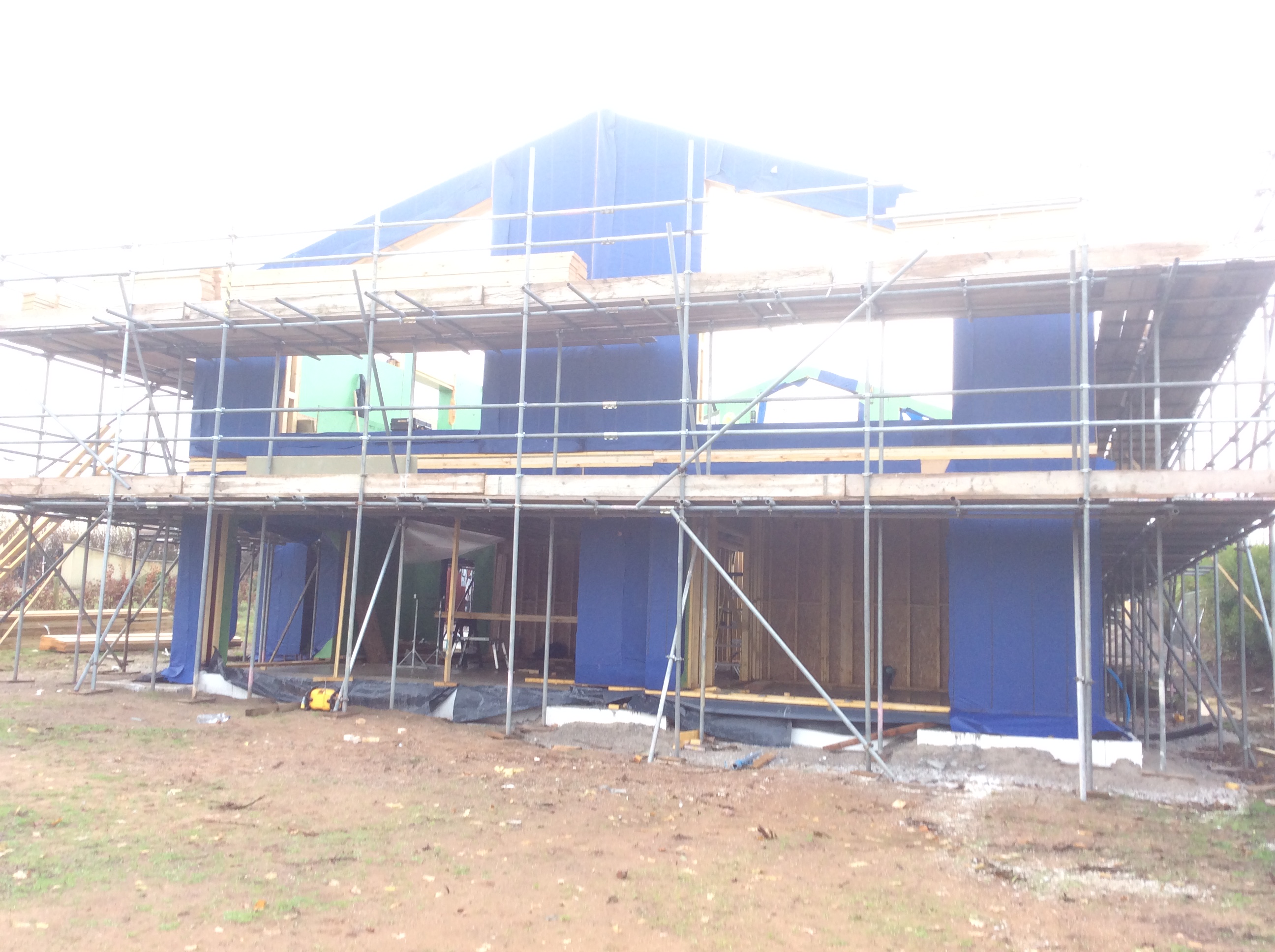

Stones Posted September 29, 2016 Posted September 29, 2016 On 9/28/2016 at 12:30, TerryE said: I know that Jeremy eulogised about the frame tolerances, but ours was out by ~1cm on a rear gable. I don't blame the crew and we are happy with the end result. (The frame was erected in shitty November weather.) One issue was that the cassettes were fixed directly to the slab, and getting these mm perfect is hard when its raining and a bit blowy. I thought on reflection that it would have been better if a separate sole plate had been laid first to register the exact cassette positions, and I see that they now do this. Our last house, the timber frame came with a tolerance of +/- 2mm IIRC. It was fitted onto a sole plate (which two joiners had spent the day getting correctly positioned, measuring and remeasuring critical dimensions. In comparison, our first house had a tolerance of 50mm and was subject to quite rudimentary adjustment on site! Timber Frames have come on a long way.
ProDave Posted September 29, 2016 Posted September 29, 2016 Another point often made is who is to blame iof the foundations don't match the timber frame? You get into an argument as to who got it wrong. I solved that by contracting the same building firm to build the foundations and supply and erect the timber frame, so if something did not fit it would be squarely (excuse the pun) their fault. As it happened the blocklayers measured and re measured to ensure they got it the right size, square and level. Then the joiners came and measured before making the frame just to be really sure. And it all fitted very well.

worldwidewebs Posted September 29, 2016 Author Posted September 29, 2016 Thanks @TerryE. Did you check all those dimensions yourself? I haven't seen the slab drawings (with diagonals etc) but might just get a peek tomorrow. I'll also phone the office and see what the plan is regarding resource on-site, so thanks for the advice. In terms of whether everything is done 'properly' I think this is where I'm a bit unsure. I've hired in a well-recommended and experienced company to do the works so there has to be an element of trust that they know what they're doing. In addition, I have no experience! That does beg the question of who to blame if things go wrong though
