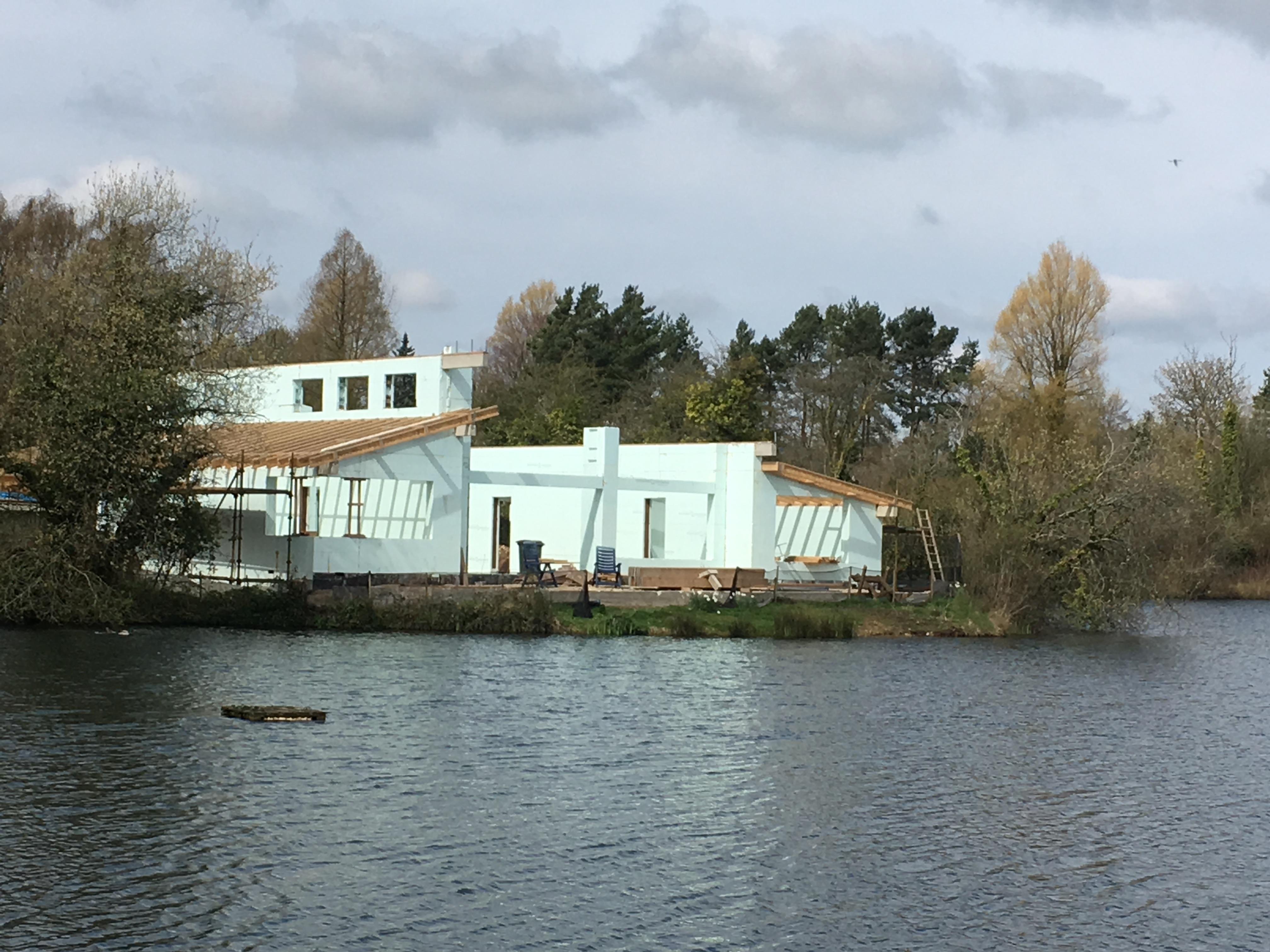

Russell griffiths Posted May 8, 2019 Share Posted May 8, 2019 So as normal the complexity of building this house is doing my nut in, piling no problem, foundations no problem, building the whole bloody house no problem, BUT how the hell do I heat it and produce hot water. My situation may be different to many people as we live on the banks of a lake (see pic ) so everything screams GSHP, or does it the quotes we are getting are stupid, not eye watering, just stupid so anybody got any thoughts, both quotes we have got look like they are based on the rhi payment not what the equipment is going to cost. So has anybody done this, can anybody shed any light on the rhi scheme. Im due to call the welsh wizard @Nickfromwales but have got tied up sorting out roofing quotes, I wish I could just get on and build the bloody thing. Any thoughts appreciated before I put the oil boiler back in. Link to comment Share on other sites More sharing options...

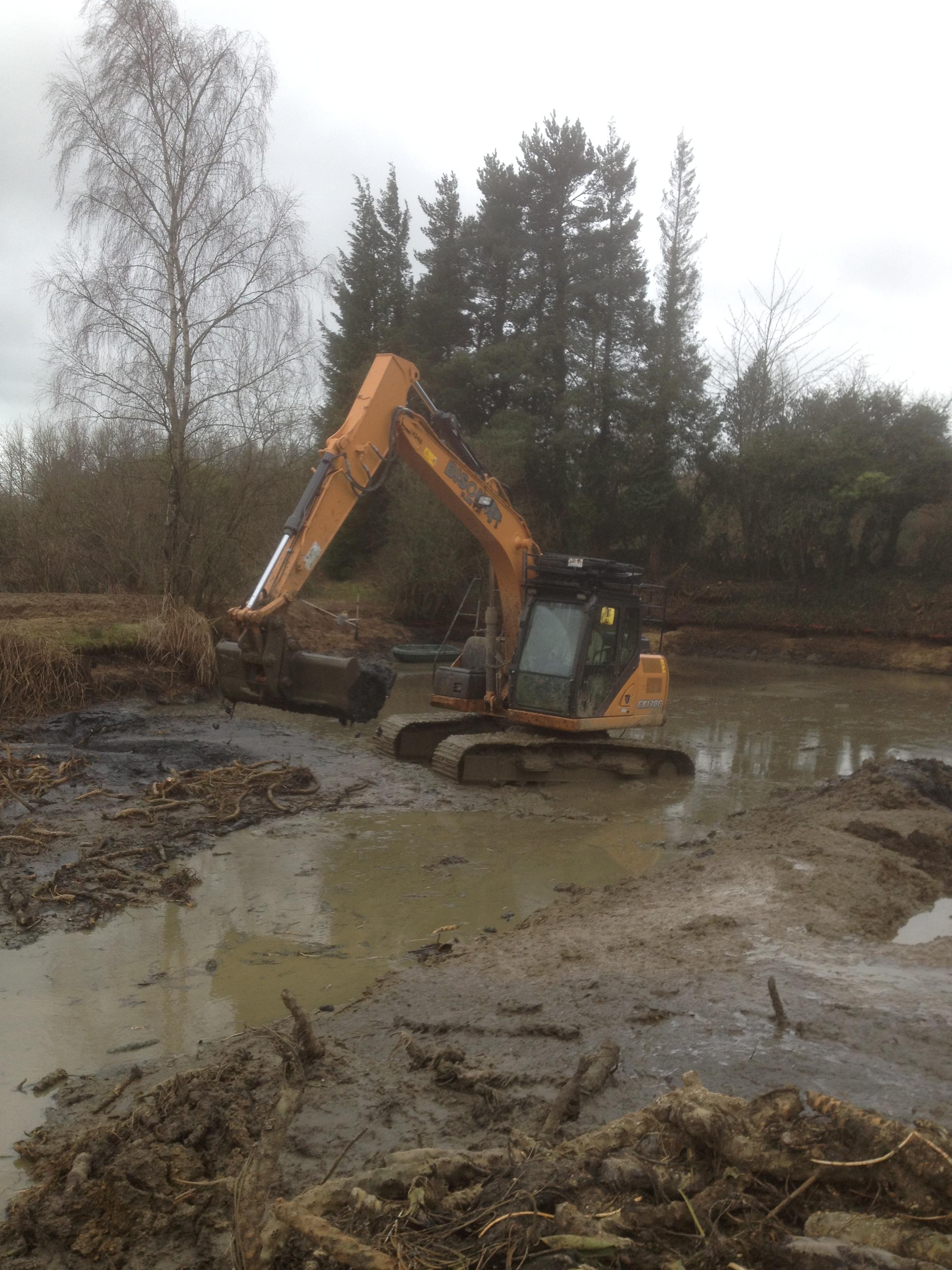

Russell griffiths Posted May 8, 2019 Author Share Posted May 8, 2019 Couple of things, my neighbours pipe work floated so he weighed it down with half an engineering brick every couple of m just cabletied on. Second funny and not connected bit, we have a small man made island in the lake that was built out of breeze blocks on top of 3 huge tractor tyre inner tube, the concrete blocks where all bonded together with expanded metal and once dry the tractor tubes inflated, it was then floated out to a shallow spot where the previous owner and 2 mates swam out with pen knives in their mouths like a royal marine commandos, on the count of 3 they all stabbed the tubes and down it went, still in position 30 years later. 2 Link to comment Share on other sites More sharing options...

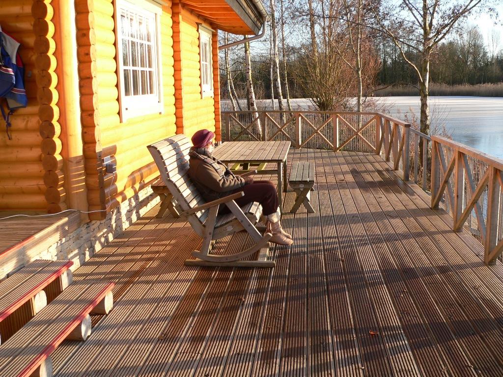

Jeremy Harris Posted May 8, 2019 Share Posted May 8, 2019 One effect of the water source heat pump collectors in the lake next to yours, @Russell griffiths, is that the areas of the lake over the top of the collectors freeze in really cold weather. We stayed there around New Year about 7 or 8 years ago, when it was really cold, and the heat pump in the log cabin was working hard to keep the place warm (made a hell of a lot of noise, too). The next morning it was clear that the section of lake over the top of the collector mat was frozen solid, whereas the area away from it was still unfrozen. This photo shows the frozen area, behind the silver birch trees, whereas the water right in front of the cabin was still unfrozen: Link to comment Share on other sites More sharing options...

Russell griffiths Posted May 9, 2019 Author Share Posted May 9, 2019 @Onoff, the lake is ours, not shared the lake in the pic is a smaller one that we cleaned out a couple of years ago. My neighbours lake has 800m of pipe, he has 4 pipes that are 200m long, 100m out and 100m return to the house, all 4 pipes return to a big manifold in a box in the lawn, then there are two larger pipes that enter the house. His pipe is 32mm. Onoff has has a good memory, when we dug out for the house we found 2 existing footings in the ground that we think may have been from a conveyor belt or something. Link to comment Share on other sites More sharing options...
