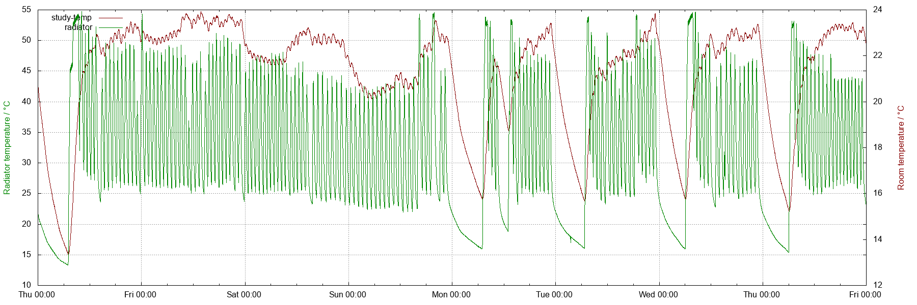

Ed Davies Posted April 27, 2019 Share Posted April 27, 2019 3 hours ago, ragg987 said: Are you using a ASHP? These are more efficient at low temperatures, and rads will need warmer water. Indeed you can run UFH at lower temperatures than radiators but I'm not entirely convinced that it makes that much difference in a well-insulated house if you run the radiators for long periods of time. E.g., in the leaky Edwardian house I'm renting at the moment the average temperature of the flow to the radiator in the study over December 2018 and January and February 2019 was 30.46 °C to kept the room around 22 °C most of the time it was occupied. (Maximum was 54.75 °C). Here's a particularly cold period from January 17th to 24th when I left the heating on overnight for the first few days (Thur, Fri, Sat, Sun). There are only a few short periods, when the house is heating from cold, where the radiator runs continuously; the rest of the time the heating is cycling on and off. For the days when the heating was on continuously (Fri 18th to Sun 20th inclusive) the average radiator temperature was only 29.17 °C. Radiator output is not quite linear with temperature so the output if it's just held at the average value will be a bit lower than if it's cycling up and down but I don't think this makes a huge difference, certainly not a much at the T⁴ effect that some people obsess on. 1 Link to comment Share on other sites More sharing options...
