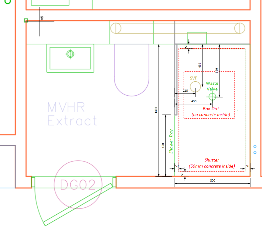

Visti Posted April 18, 2019 Share Posted April 18, 2019 We're stuck on how to incorporate a shower tray into the ground floor bathroom. It'll be a 75mm deep concrete slab on top of EPS (300mm), but that is it. Powerfloated and done as a finished floor. Ideally all continuous throughout the entire ground floor. How should we go about fitting the 1400x800mm tray? Finish the floor, then cut out the concrete where the tray will go. Place in a box frame before the concrete pour to make space for it (not even considering the risk of locating it correctly) Any bright alternatives? Link to comment Share on other sites More sharing options...
Oz07 Posted April 18, 2019 Share Posted April 18, 2019 Have you been told 75mm conc ok? Thought 80 was min for structural floor or are you on top of b&b? I've shuttered out before but not with a concfibished floor. I'd try to set a box up level with top ffl so they can polish over then set tray and thinner slab in afterwards if want flush. May need rods? 1 Link to comment Share on other sites More sharing options...

ragg987 Posted April 18, 2019 Share Posted April 18, 2019 We installed a Bette shower tray flush to the floor. The installation kit creates a box and the screed poured outside that. Works well. You might need something solid over the polystyrene to support the frame. Link to comment Share on other sites More sharing options...
Nick1c Posted April 18, 2019 Share Posted April 18, 2019 We hope to achieve the same end result & it has been bothering me too. My assumption was that we would have to shutter the exact void we want (I will buy the shower trays so they are on site to make sure it all works) and get the siting of the drain pretty accurate. Hopefully @Nickfromwales will sort it all out! A 75mm slab seems thin, our design arrived earlier & looks to have a minimum thickness of 150mm, with areas of reinforcement for areas under high load. 1 Link to comment Share on other sites More sharing options...
Onoff Posted April 18, 2019 Share Posted April 18, 2019 1400x1400 on plan, 100mm at the edges and about 80mm at the wall drain. Great fun too: Wall drain in: 1mm angle iron formers Exotic, very "resinous", SBR heavy mix with 10mm pea shingle as the aggregate: Tamped with two fall lines from corners to drain: You can see the slope here: Mark up the tiles: Dry fit: Etc 1 Link to comment Share on other sites More sharing options...

Mr Punter Posted April 21, 2019 Share Posted April 21, 2019 You can get a tray like that which is only 30mm deep and sit it on the concrete. You just need to box out the bit for the waste. You not notice the 30mm step. Get one that is slip resistant and easy clean. Link to comment Share on other sites More sharing options...
Nickfromwales Posted April 21, 2019 Share Posted April 21, 2019 On 20/04/2019 at 17:16, Visti said: Nick is help us too, so hopefully the experience will translate across! How about buying a pre-formed concrete tray ( Link ) and set in situ prior to the pour ? Then just let them polish to this and ask the polishers to blend it in as best as possible? I’d say go for a bigger area if no shower enclosure is to be used. 1500x1500mm. Getting closure to match may be controlled by asking what’s the sand comes from for the tray manufacture to forecast if there will be big differences between the two. Sounds a tall order unless you put a break at the door and address the room al-a- @Onoff‘s solution. Link to comment Share on other sites More sharing options...
Visti Posted April 28, 2019 Author Share Posted April 28, 2019 I think there's a solution following some more thought and Nicks help! Shutter 50mm all the way around from the tray edge and fill with up to 50mm concrete during the floor pout to accommodate the depth of the tray (30mm) so that it only sticks up by a few mm. The SVP / Waste value area is boxed off fully with no concrete poured in so that the pipework can fit. The diamond cut the slab to the tray outline after the pour and polish to allow the whole tray to drop into the recess. This way there's much more tolerance for inaccurate placement of the tray shutter prior to the pour, with accurate cutting out of the tray profile once the TF is up. FYI @Nick1c if you're considering the same. 1 Link to comment Share on other sites More sharing options...
