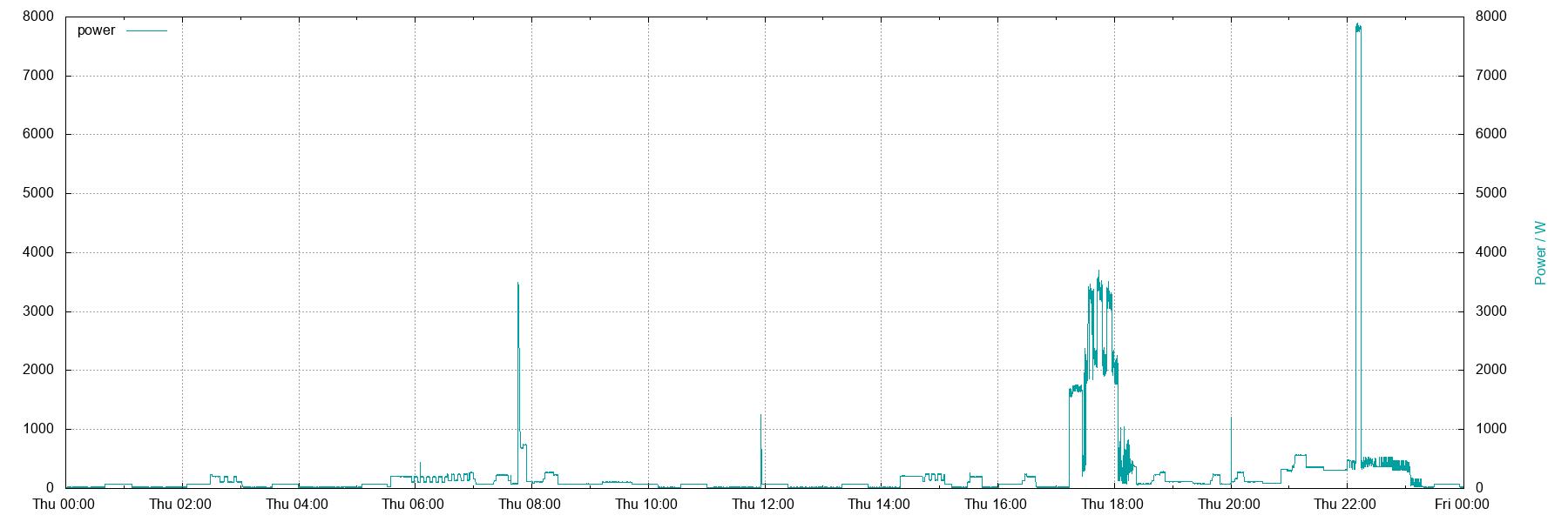

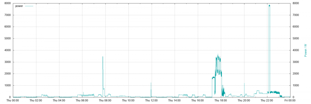

Ed Davies Posted April 12, 2019 Share Posted April 12, 2019 (edited) 3 hours ago, NeverEnoughCake said: We are low users..about 2000kwh a year! Going with 7 x 365 LG neon mono panels, Victron easisolar48/3000/70-50-230v-c/w integral mppt charge controller, BYD -B-PLUSL 2.56 kWh 48v lithium battery...any thoughts? I have similar thoughts. My usage is about the same (about 4 to 5 kWh/day). Still, to have much hope of coming close to meeting that demand I'm thinking of more than double the amount of PV (6 kW) and four time the battery capacity (10 kWh). Even then, around December it's not looking too great. As @JSHarris has cross posted as I'm typing this, PVGIS is a good tool to use. On another forum I collated people's reported outputs against PVGIS predictions on a monthly basis. Generally speaking PVGIS came out at the bottom quartile; i.e., 1/4 of the time the actual output was less than PVGIS, 3/4 of the time it was a bit better so it seemed, then, that PVGIS was realistic but a bit conservative. There's a new version of PVGIS now with a number of different solar-radiation databases which vary a bit but seem to be a bit more optimistic than the old database so I image it's pretty reliable now. For my site in NE Scotland with my proposed 6 kW facing just east of south at 60° elevation PVGIS predicts an output of 109 kWh for December (i.e., 3.5 kWh/day, 146 watts average). 2000 kWh per year (5.48 kWh/day, 228 watts) is obviously a bit more. Something to beware of, though, with PVGIS is letting it optimize the slope. It'll pick the optimum slope to maximize year-round generation whereas off-grid you tend to want to optimize for winter generation. Theoretically to maximize December generation this far north you want the panels pretty much vertical but realistically the more even generation with a bit of exposure to the overhead sky of a slightly shallower angle is probably worthwhile. If instead of setting 60° elevation for my site I leave PVGIS to optimize the slope it picks 41° which knocks December generation down from 109 to 91.2 kWh. Even shallower angles can really nail you. E.g., 10° (as I'm visualizing for a car-port roof) will only give 40.5 kWh in December. In a hilly place like Wales you need to run PVGIS for your exact site to see that effect shading by hills has. My plan is to see how it goes but with the assumption that it's most likely I'll finish up getting a small wind turbine to make up the difference. I too have no option for a hydro scheme but something my site is not short of is wind. (Packed up this afternoon when a chisel blew away - I exaggerate only slightly.) I too plan to use LiFePO₄ batteries. I'm not yet convinced by packaged solutions, though. The first search result for BYD B-Plus gives €1,183.00 for a single module which works out as €0.47/Wh whereas just buying individual cells can get prices around €0.35/Wh. Obviously that's without the battery management but I'm not convinced that the complex balancing systems people have are necessary or even a good idea. (You need to monitor the individual cells and some balancing at sometime is probably needed but I think it's not needed continuously and that doing it continuously might even be harmful.) Edited April 12, 2019 by Ed Davies Link to comment Share on other sites More sharing options...

Ed Davies Posted April 13, 2019 Share Posted April 13, 2019 (edited) 2 hours ago, NeverEnoughCake said: And to be honest, now just bored of thinking about it. That's a pity as it sounds like you're likely to fail and regret it all which will be sad for you and reinforce those who say to just get a grid connection. 1 hour ago, Christine Walker said: After living in a caravan for 6 months with the electricity supply coming from our neighbours garage which meant if we put the kettle on we had to turn off the water heater etc … My plan is 2 x Victron 3 kW inverters so a total of 6 kW available to use. I had all sorts of plans for automatically shedding loads to keep under that limit but in practice I find I don't actually use that much in the house I'm renting apart from when I use the 7 kW electric shower. Even running the washing machine while cooking dinner on Thursday evening it didn't go over 4 kW. It seems to me there's a split in the whole off-grid thing between fairly “hair-shirt” systems such as Maximus Ironthumper talks about (just watched one of his YouTube videos) vs some really expensive turn-key systems you'll get offered if you just phone people up and that, with a bit of research and understanding, you can build something in between which will be quite comfortable 10 months of the year but need some care and thought in December and January. Edited April 13, 2019 by Ed Davies Link to comment Share on other sites More sharing options...
