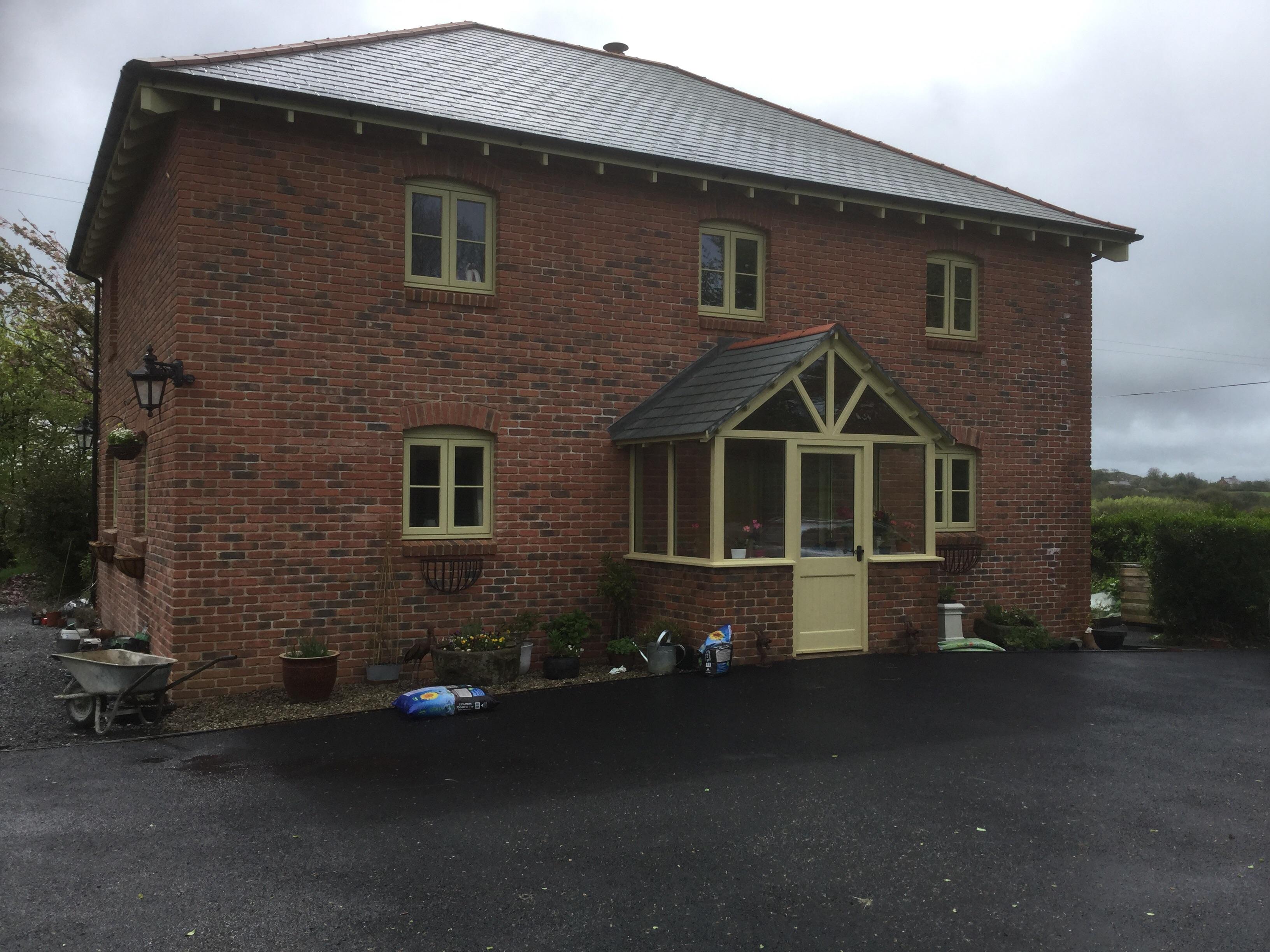

Moira Niedzwiecka Posted April 26, 2019 Share Posted April 26, 2019 @lizzie Your house is so stunning I didn't notice any cracks. My house was up for well over a year before it was boarded & plastered, maybe that is why I haven't had any, yet. My joiner friend said after a cycle of all 4 seasons it has mainly settled. One thing I would reconsider if I was ever mad enough to do this again is not to have the internal window frames in RAL 7016. It has been a bugger where the white walls meet them to get a really crisp, totally even & neat junction. I have achieved it but it was a real pain. Mind you, may not be an issue if a professional decorator was involved. Alas, that was not possible on my budget. 1 1 Link to comment Share on other sites More sharing options...

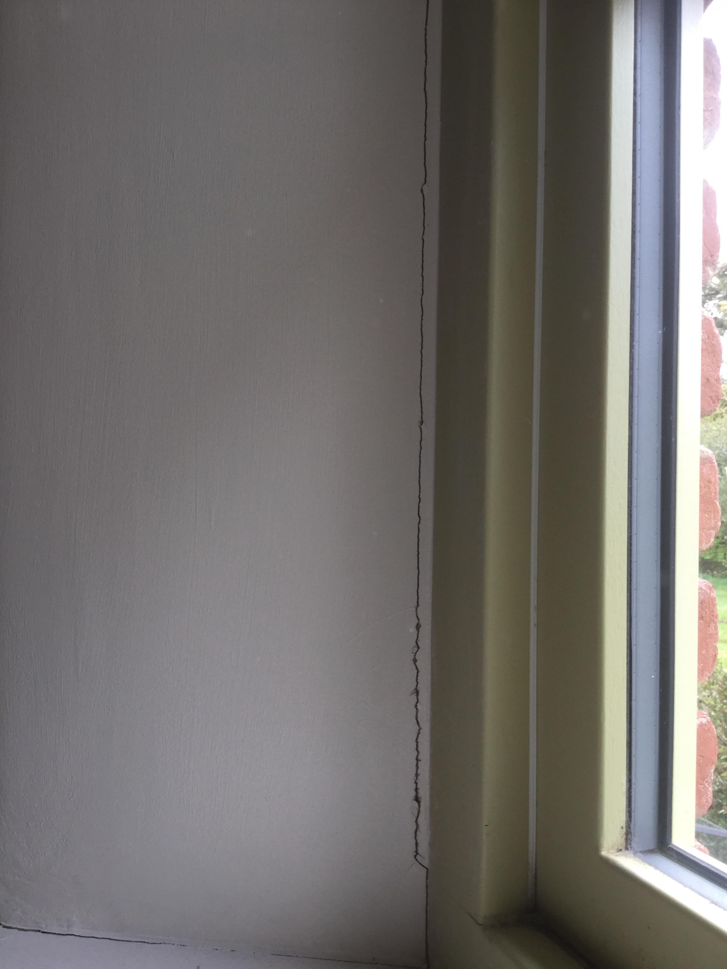

joe90 Posted April 26, 2019 Share Posted April 26, 2019 Regarding cracks, here is my tip fir the day regarding wooden windows. I built angled reveals (cottagey) and suggested the plasterer put a stop bead next to the wooden window, filled with non setting mastic to stop any cracking, he said it was not required......I wish I had insisted. 4 Link to comment Share on other sites More sharing options...
Jeremy Harris Posted April 26, 2019 Share Posted April 26, 2019 4 minutes ago, joe90 said: Regarding cracks, here is my tip fir the day regarding wooden windows. I built angled reveals (cottagey) and suggested the plasterer put a stop bead next to the wooden window, filled with non setting mastic to stop any cracking, he said it was not required......I wish I had insisted. We have cracks just like those around our frames, too, where the plaster has shrunk back from the frame edge as it's dried out. I've been going around raking the cracks out and filling them with flexible acrylic sealant, but it's a messy job to do and would have been better done as you suggest. 1 Link to comment Share on other sites More sharing options...
joe90 Posted April 26, 2019 Share Posted April 26, 2019 Yup, ain’t hindsight a wonderful thing, I did use a stop bead on the porch I built and it’s not happened at all. Going to do the same in the conservatory (if I ever get round to finishing it ?). Link to comment Share on other sites More sharing options...

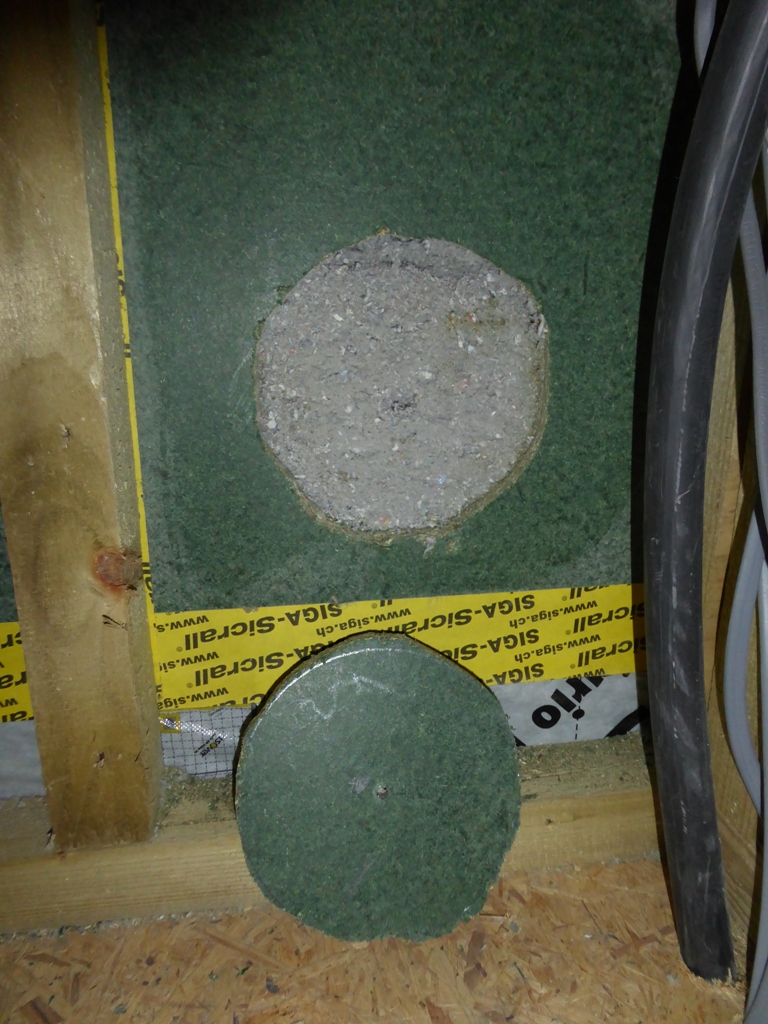

Simplysimon Posted April 26, 2019 Share Posted April 26, 2019 On 25/04/2019 at 12:47, scottishjohn said: blown cellulose insulation --how is ti stopped from gradually moving down the cavity and compacting? when it's pumped in at 50+ kg/m2 it won't settle much Link to comment Share on other sites More sharing options...
Jeremy Harris Posted April 26, 2019 Share Posted April 26, 2019 2 hours ago, Simplysimon said: when it's pumped in at 50+ kg/m2 it won't settle much Yes, it seems to form a very solid block inside the wall. I cut a hole for a duct near the top of one of our walls, and this is what it looked like after I'd used a jigsaw to cut a 150mm diameter disc from the inner board layer: Link to comment Share on other sites More sharing options...
