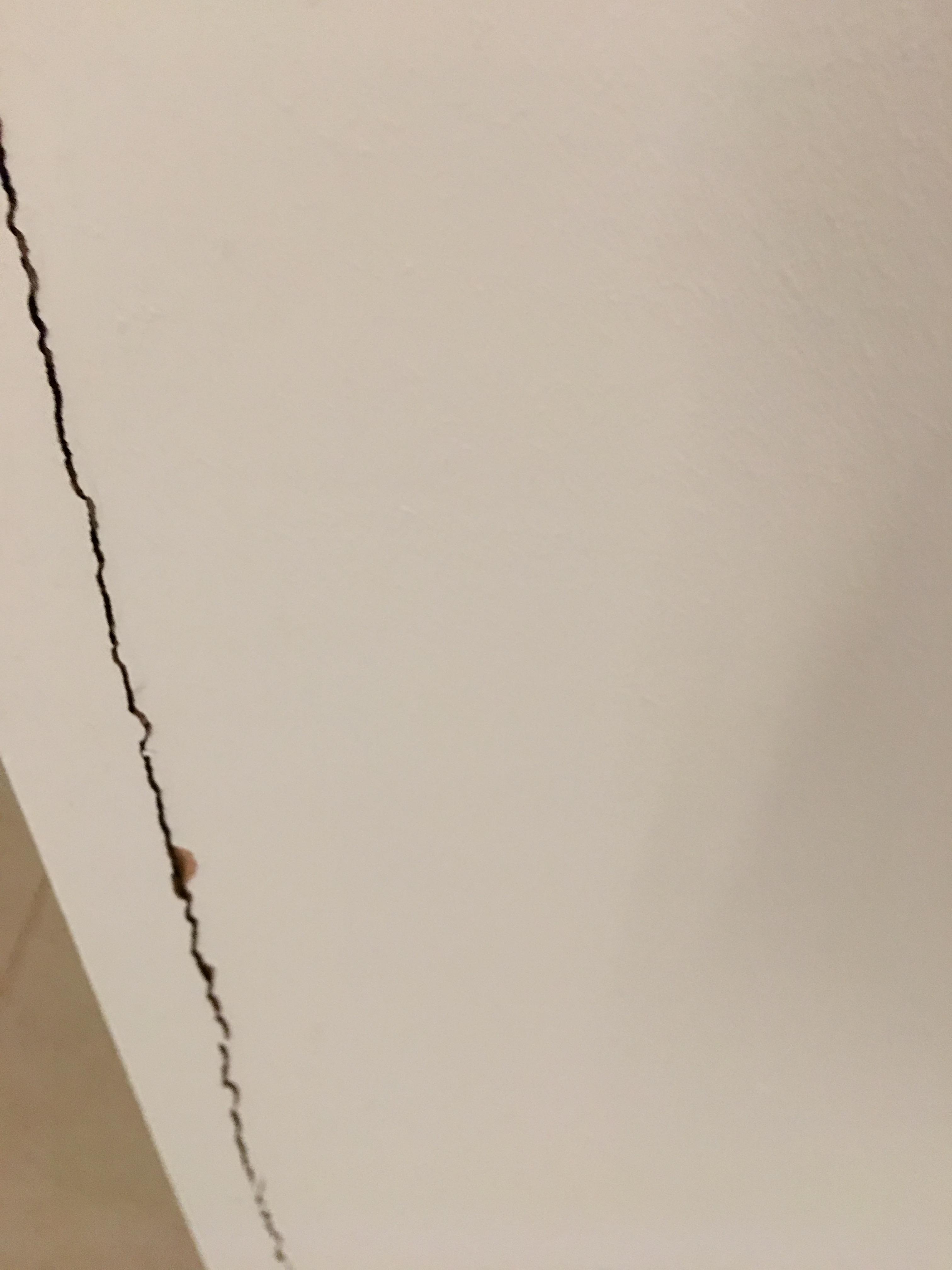

lizzie Posted April 26, 2019 Author Share Posted April 26, 2019 6 hours ago, newhome said: I haven’t got any cracking here and the frame has been up 9 years. It was boarded without being sat around too. My old house (developer built brick and block) had some cracking. I haven’t go any cracking here either.....I have bloody great crevasses its like the grand canyon in places. Mine was boarded and plastered whilst still not watertight. It was leaking literally like a sieve for air test and just had temp bits of tape put over to get a result and I was told I needed to sort it properly afterwards by air testers as even their temp tape was having problems sticking due to the wet. The leaks continued right through the whole house being plastered and the plastered walls and floor were wet around the leaking windows. However my cracking (and I have an awful lot) is not around the areas that were wet for so long. Prior to boarding and plastering the frame was sopping wet as we did not get the roof on and watertight for some while and it was very wet weather, then it turned warm and we had black mould growing on the frame we had to treat it with anti fungal and dry it out with dehumidifiers. I guess all thats the reason why my cracks are so bad. Pic just for interest. 1 Link to comment Share on other sites More sharing options...

lizzie Posted April 26, 2019 Author Share Posted April 26, 2019 1 minute ago, scottishjohn said: I think you are absolutely correct TF houses that get put up and get wet have to dry out and that would be my best guess why cracking in plaster seems to be such a problem - very new unseasoned wood +getting wet in transportation before and then during build process --then boarded which will trap it in so it takes time for it to dry out and then it shrinks /moves about same could probably be said for houses built from the lightweight thermo blocks . I had one in my garden --which got wet over a period --i moved it inside garage to use for something --then was suprised some months later how it had more than halfed in weight when i went to move it.. I worry when I see people doing a build and just stop at roof when membrane is on . Its no brainer to me you finish the roof completely as soon as possible ,not rely on the 3 months of waterproofing the membrane can give ,never mind the effect of UV on it and why leave cladding till later --all outsides --then move to inside has to be the right way uk climate is not like arizona - I would not even start the build If I could afford not get it to that stage in one hit ,even if it meant getting trades in I had trades in for everything I did not do anything myself and it was a complete money pit every week massive bills from 'trades'. Lack of funds or 'trades' were not the issue, planning and co-ordination was a factor of course as was terrible weather also TF provider could not do our roof frame we had to get it made by someone else and my carpenter then fitted each individual shaped truss to form our final roof profile, it was a heck of a job for him then the final covering was done by another specialist roofing company. We had some sort of membrane type thing on the boarding provided by TF company but apparently it was not waterproof as evidenced by the niagara falls of water coming in through the roof in the awful weather. This water then gathered in lakes on the uneven slab and so the cycle of wet warm mould etc was able to take hold. 1 Link to comment Share on other sites More sharing options...
