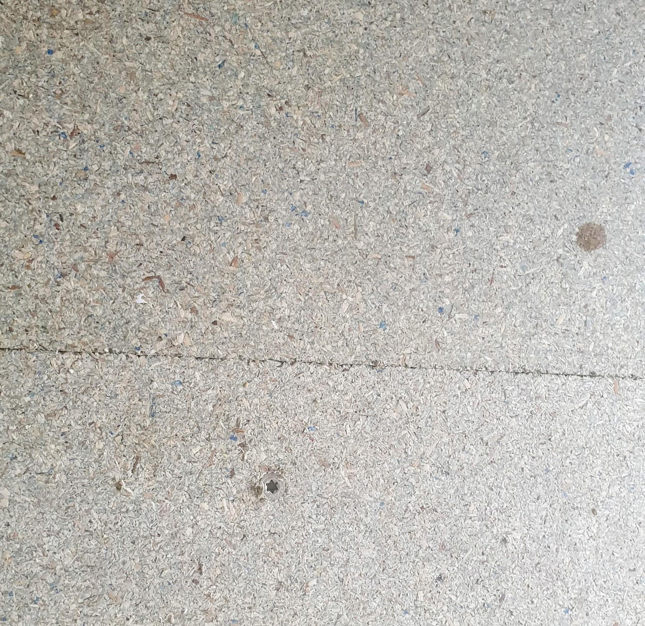

ToughButterCup Posted March 21, 2019 Share Posted March 21, 2019 It was all going well: too well - the laying chipboard flooring that is..... But some time or other I had to solve the problem of what happens when the joists change direction. Half the joists run north south, half east west. And they meet at the top of the stairs. That was the place where two cut edges have to sit side by side : and I tackled that little joker yesterday - Oh dear: North South joist on the RHS, East West joists LHS. They meet under the left-hand gap. Its the gap covered by the rule that I'm concerned about. The joint sits squarely across a wide joist. Both bits of floorboard can be adequately stuck down and screwed into place firmly. Debbie wants it to be covered with bamboo. The gap will not be seen. But I know the friggin' thing is there.... GGGGrrrrrr. I've worked really hard to get it all mm perfect. IGNORE : REPAIR : REPLACE? Knock down and start again? (Nein Danke) Link to comment Share on other sites More sharing options...
Declan52 Posted March 21, 2019 Share Posted March 21, 2019 What have you got going spare?? You could caulk it, use wood filler, mix some of the glue with the sawdust cuttings and put it in or just brush the saw dust in. Link to comment Share on other sites More sharing options...
joe90 Posted March 21, 2019 Share Posted March 21, 2019 You need to temper your OCD ( I have had to do this), yes you know it’s there but as long as it’s solid, as in fixed properly, there is nothing wrong with it., to make yourself feel better you could fill it with D4 glue and let it foam in the gap, (spray a little water in the gap to make it foam more) then trim it off flush with the flooring. 1 Link to comment Share on other sites More sharing options...
ProDave Posted March 21, 2019 Share Posted March 21, 2019 Why is there a gap? I would have sorted that as you laid the board. Probably too much work to change it now so I would just put several screws in each board either side of the gap to ensure they can't move. TIP In some cases when boarding at a change of joist direction, you can make boards interlock properly at the join by turning one set of boards upside down. Link to comment Share on other sites More sharing options...
Onoff Posted March 21, 2019 Share Posted March 21, 2019 Cut a sliver of board on thd table saw and glue it in if that fussed. Link to comment Share on other sites More sharing options...
Cpd Posted March 21, 2019 Share Posted March 21, 2019 3 minutes ago, ProDave said: Why is there a gap? And what’s under the gap, a timber of fresh air ? Link to comment Share on other sites More sharing options...
joe90 Posted March 21, 2019 Share Posted March 21, 2019 22 minutes ago, recoveringacademic said: The joint sits squarely across a wide joist. Both bits of floorboard can be adequately stuck down and screwed into place firmly. ? 1 Link to comment Share on other sites More sharing options...
Cpd Posted March 21, 2019 Share Posted March 21, 2019 As @Onoff said then. Link to comment Share on other sites More sharing options...
nod Posted March 21, 2019 Share Posted March 21, 2019 More glue It should be oozing out of each joint Link to comment Share on other sites More sharing options...
Pete Posted March 21, 2019 Share Posted March 21, 2019 It has run out somewhere but as long as it is fixed securely on both sides across the joists and it is LEVEL move on as you will have bigger problems in the future (as we all have ?) Link to comment Share on other sites More sharing options...
