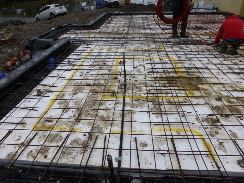

Dreadnaught Posted March 11, 2019 Posted March 11, 2019 Interesting comments. Very helpful. I think I will price up UFH, radiators, and skirting heating and see where it ends up. I won't base the decision solely on price unless the price difference is large. On DIY for laying UFH pipe, I have watched the pipe go in on a couple of builds and on video. With preparation and care (and the right equipment, such as a coil unwinder), it looks highly DIY-able. Food for thought. 1
Jeremy Harris Posted March 11, 2019 Posted March 11, 2019 DIY pipe laying takes a fair bit of time, and that means arranging for a break in the middle of the slab laying process. At a guess I'd say you need to allow a couple of days to mark out, lay and tie in the UFH pipes. This would be a fair bit quicker if there were two of you doing it. The guys that laid ours had a well-worked out system where they spent an hour or so accurately spray marking the locations of walls, doorways, the stairs, kitchen and utility room units, the WC etc, on to the EPS, just after the steel fabric and the ring beam steel was laid and tied in (a bit over a days work for our smaller slab). The UFH pipes were laid and tied in the afternoon before the concrete pour. When laying the pipes, one chap held the coil of pipe and paid it out as the other tied the pipe to the steel. Seemed to be an efficient way of working. Here's a photo showing how they did it: 1 1
JanetE Posted March 11, 2019 Posted March 11, 2019 Having lived in our MBC house with underfloor heating for just over a year I personally would never choose to go back to radiators. Nothing compares to the comfort and utility of underfloor heating and I am sure you will regret it if you decide to go down the conventional route. It was a no brainer as far as we concerned to get them to lay the pipes before the pour and if I recall correctly it was more than a half days job for the three guys as the pipes have to be cable tied to the rebar. I am sure it is also the cheapest and most convenient way to heat your house. Worth every penny. 1 2

Sue B Posted March 12, 2019 Posted March 12, 2019 We laid all the UFH pipes ourselves in the last house. We bought a designed system (too scared of getting the wrong things to buy the components separately ) from nu-heat so paid a premium for their design and supply but it was all really straightforward. Yes, the pipe was unwieldy and because it was a designed system, the pipe was cut to length which did make it more manageable. However, even now, 10 years older, I have no qualms about doing this ourselves again, buying all the bits we need separately, other than finding a cheap way to hold the pipe reel to make life easier. I intend to talk to Insulhub (Isotex supplier) about doing the passive slab largely by ourselves, buying in some labour from them to check what we have done before the pour. 1 1
Nickfromwales Posted March 12, 2019 Posted March 12, 2019 On 12/03/2019 at 07:14, Sue B said: other than finding a cheap way to hold the pipe reel to make life easier Expand Sue. We have a pipe decoiler in our Buildhub tool loan stock. Let me know when you are ready and you can reserve it. £10 donation to the BH coffers is the price, plus P&P to send onto the next 'borrower' or to return it to a staff member to hold. 1
