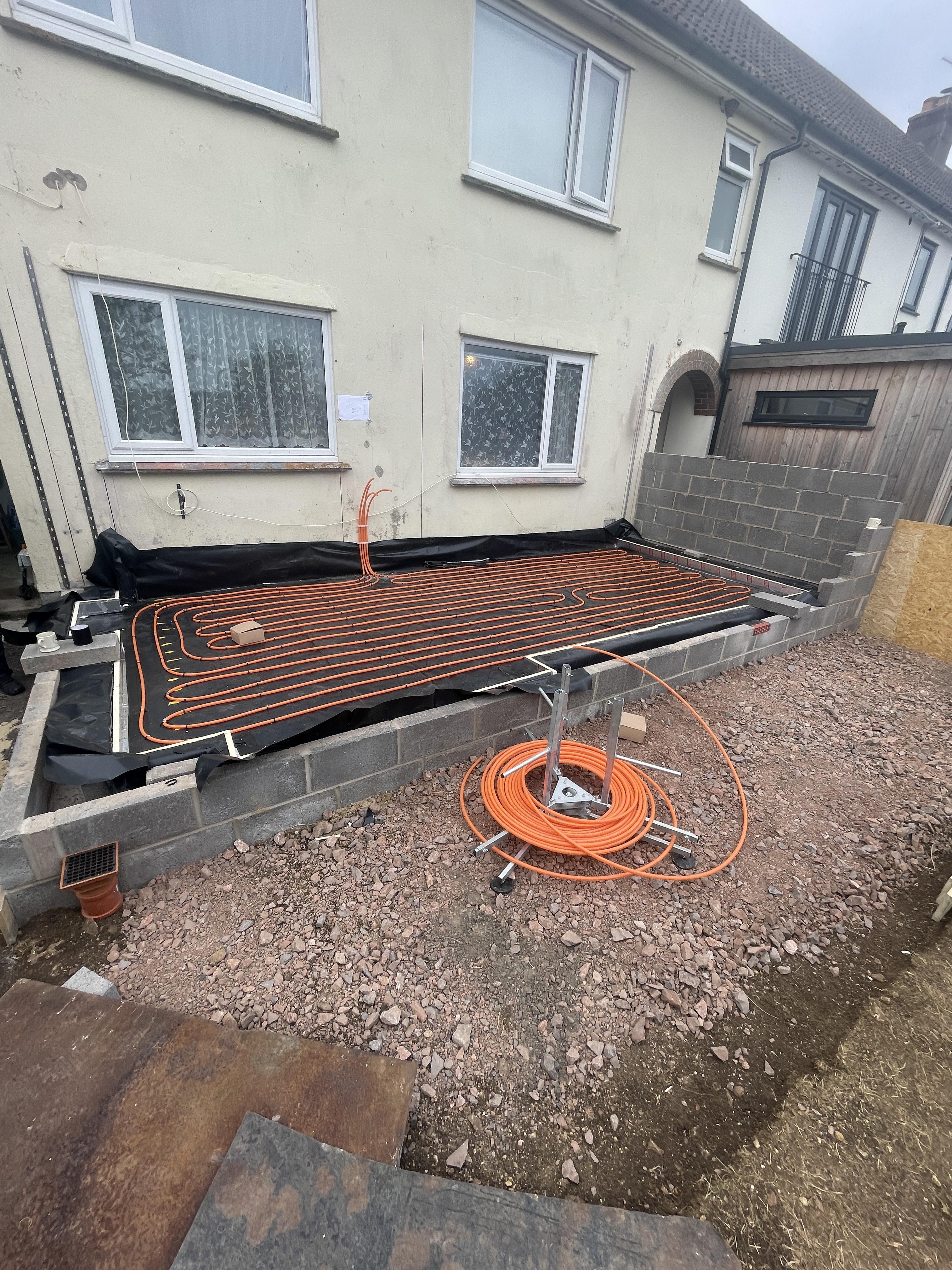

Just about to push the go button on a retrofit UFH in the slab.....any follow up experience/comments as its been a few years since these works were done??
Any and all input very much appreciated!

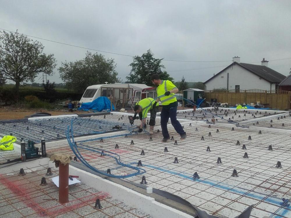

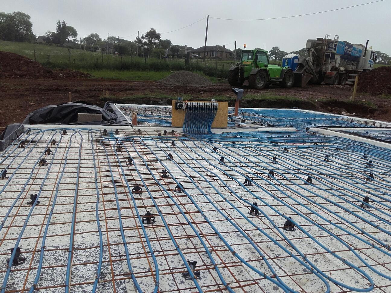

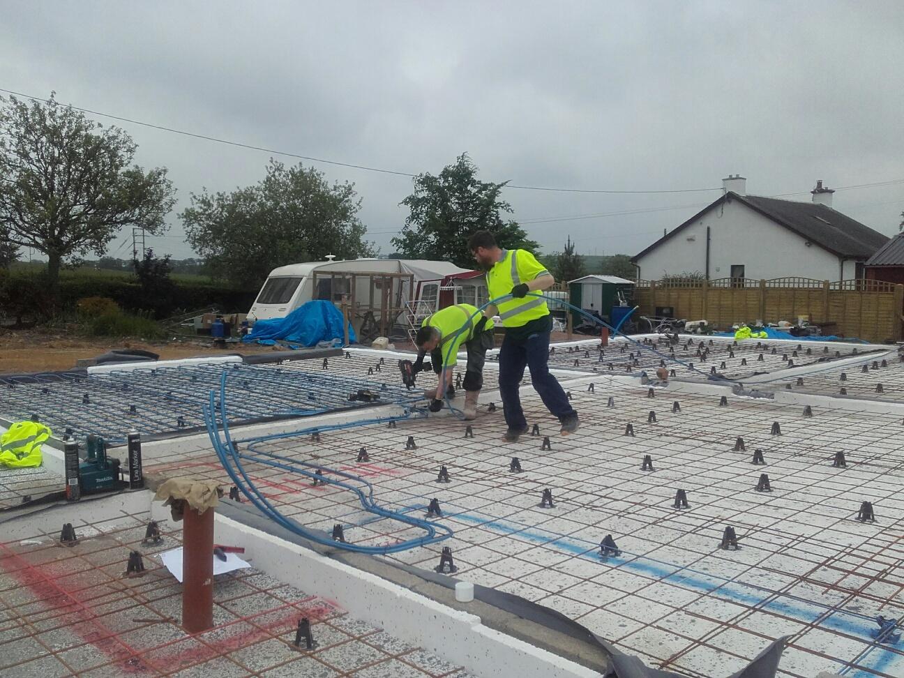

On 22/02/2019 at 15:49, recoveringbuilder said:
Ours was put in on the mesh and pipes were pressurised at the time, so mesh was sat 50 mm up on little holding things then pipes attached to mesh then the pour22DFA40C-DFD6-4926-87C9-BC4EFA20FCB1.thumb.jpeg.c3553c947dac690f0f55840245572fd2.jpeg9F436F7E-025F-4343-8276-4A3F1470E0AA.thumb.jpeg.29b37c1273d898619c9b2f9b9aefb9e1.jpeg
Thanks for this.  Makes much more sense doing the slab this way.  Did the contractors who did the slab also power float it?
Yes
