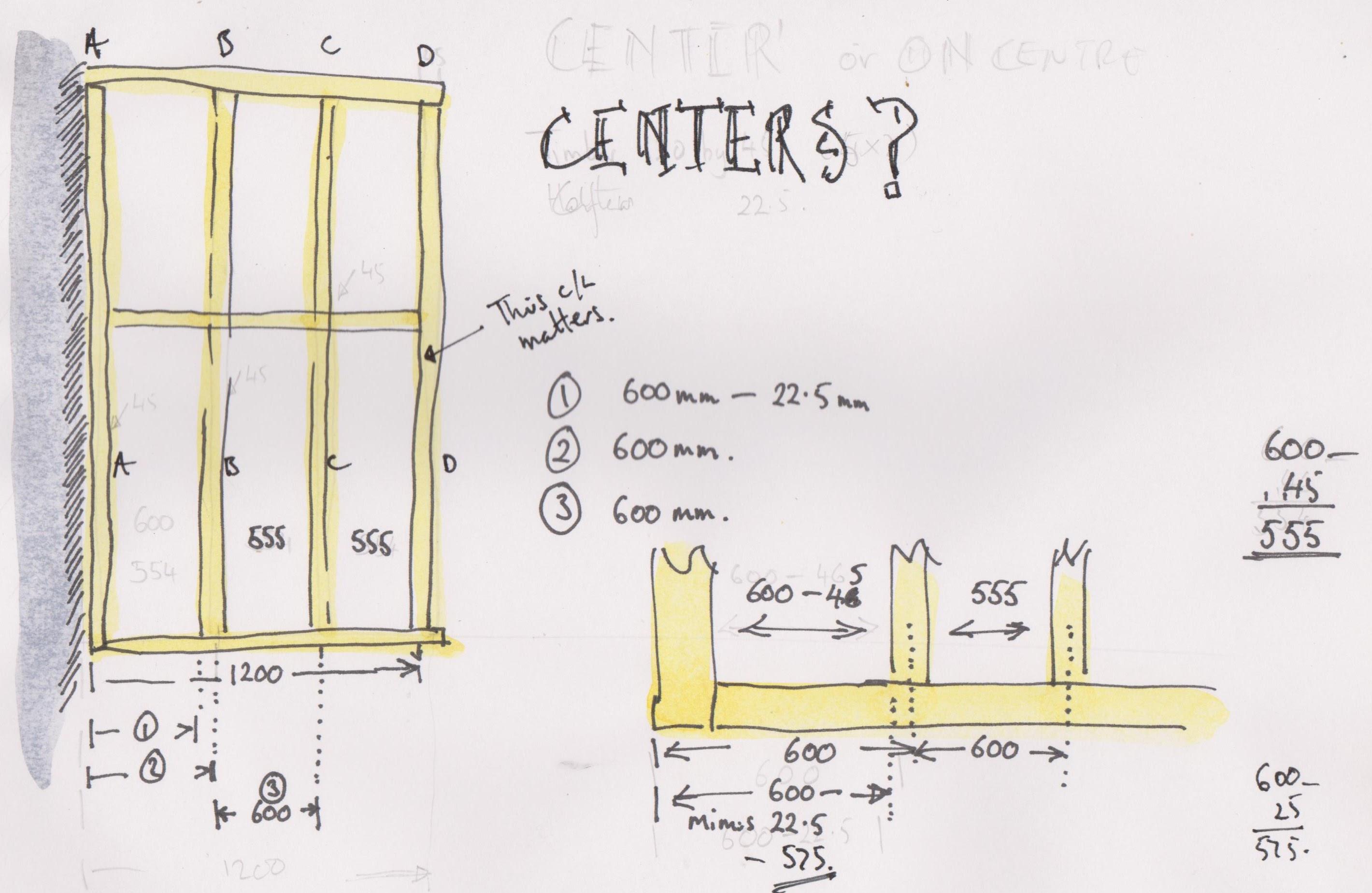

ToughButterCup Posted February 22, 2019 Share Posted February 22, 2019 Studding, framing, call it what you will has a lovely little trap in it for the unwary doesn't it? Consider the average recently retired so-called academic listening to the chit chat of chippies and the BH Commentatriat (very nice people) The trap is called ' ... centers ...' In any run of vertical timbers set on the bottom plate (timber) of a framed wall, it is traditional to say that the timbers are set at ' ... centers ...' of a certain value: commonly 600 or 400 mm. Liars. Here's why I'm so irritated. The first vertical (let's say the one fastened to a structural wall) labelled A here To set the center of vertical B, you (I am told) measure 600 from the wall. Using 45mm timber, I deduct 22.5mm left and right to Mark the edges of the timber I now have the center-line and both edges of vertical A From there on, I can measure 600mm lines to mark the subsequent C/Ls Why is the first center line marked 600 mm from the wall and not the center-line of timber A ? Eh? Tell me that? Link to comment Share on other sites More sharing options...
Cpd Posted February 22, 2019 Share Posted February 22, 2019 12 minutes ago, recoveringacademic said: Why is the first center line marked 600 mm from the wall and not the center-line of timber A ? I may be wrong.....l. But is it not because if your using 1200mm sheeting or plasterboard it will start against the wall and you want the joint to land in the middle of the stud........ 1 Link to comment Share on other sites More sharing options...
Big Neil Posted February 22, 2019 Share Posted February 22, 2019 13 minutes ago, recoveringacademic said: Why is the first center line marked 600 mm from the wall and not the center-line of timber A ? +1 as i had no idea this was the way it was fone. Are the 'centres' in a stud wall regulated or can you essentially do what you like so long s structure isn't an issue for you? This being the case, why not just have 400 or 600 spacing 'between' studs instead of measuring to the centres? Link to comment Share on other sites More sharing options...
Cpd Posted February 22, 2019 Share Posted February 22, 2019 I am doing my shed at the moment and there are three things that have dictated where I put my studs, 1. To make sure that my obs sheeting edge will fall in the centre of a stud 2. Designed spacing to accommodate rock wool insulation with minimal cutting 3. To make sure it’s as solid as I require it. Am am I missing something Link to comment Share on other sites More sharing options...
ProDave Posted February 22, 2019 Share Posted February 22, 2019 It's simple. All the intermediate joints in the wall board sit on the centre of a stud. But the very first (and last) sit on the outside edge of the stud. So think of it as the first stud is offset by half it's thickness to account for this. Don't forget this fact when cutting your noggins. If the "end" is a corner, then you also have to decide which board will overlap over the end of the first, which gives you another correction for the thickness of the board to make. 2 Link to comment Share on other sites More sharing options...
Construction Channel Posted February 22, 2019 Share Posted February 22, 2019 Oh the classic. I always measure 422 off the wall and put the cros on the wall side and carry on 822, 1222...... The classic mistake is they will leave the 1200 stud so the board finishes on the edge of the stud. Luckily you haven't made this mistake but I have had to adjust a lot of apprentices studwork from this old classic The first noggin is always short otherwise you get a 1/2" gap in the plasterboard. Link to comment Share on other sites More sharing options...
ToughButterCup Posted February 22, 2019 Author Share Posted February 22, 2019 10 minutes ago, Big Neil said: +1 as i had no idea this was the way it was fone. Are the 'centres' in a stud wall regulated or can you essentially do what you like so long s structure isn't an issue for you? This being the case, why not just have 400 or 600 spacing 'between' studs instead of measuring to the centres? I don't know. The other replies point to the importance of the center line of the one stud (vertical) coinciding with both ends of the plasterboard. The gap between the others matter for different reasons (which I have yet to find out about) @Cpd above summarises the main points elegantly. My point is that to the student chippie Centers does not describe the full picture. Centers for most - just not those verticals at the end of the run(s). Cheeky buggers chippies...... Link to comment Share on other sites More sharing options...

Declan52 Posted February 22, 2019 Share Posted February 22, 2019 8 minutes ago, Big Neil said: I'm sure it's a naive question, but why not just cut the board? I see examples of people cutting the board all the time. Is it simply a question of wastage? You will have cuts at one end but you don't want to be cutting each board because some joiner can't use a tape. Takes time plus the waste aspect. Cut a bit of lath at 1200 with marks at 400 and 800 and use this to help you set out you bottom and top stud. Link to comment Share on other sites More sharing options...
Construction Channel Posted February 22, 2019 Share Posted February 22, 2019 7 minutes ago, Big Neil said: I'm sure it's a naive question, but why not just cut the board? I see examples of people cutting the board all the time. Is it simply a question of wastage? Because the board won't be long enough. You would need it to be 1222 to reach the wall. Just wait until you get to a corner. (make sure you mark centers from the external side ?) Link to comment Share on other sites More sharing options...
Ed Davies Posted February 22, 2019 Share Posted February 22, 2019 1 hour ago, recoveringacademic said: The other replies point to the importance of the center line of the one stud (vertical) coinciding with both ends of the plasterboard. The gap between the others matter for different reasons (which I have yet to find out about) West gable of my house: spent ages working out how to put the studs exactly on 600 centres ready for portrait-orientation OSB sheets. It was all a bit of a compromise as the ridge beam is a about 30 mm south of exactly centre (my fault) and the south main post is about 30 mm north of where it should be (not my fault) so quite a bit of head scratching was involved. But I learned from it: for the other end of the house I realised only the studs on 1200 centres need to be exact, the intermediate ones just need to be roughly in the right place so I lined everything up to centre on the posts not caring that the centre stud up to the roof beam wasn't lined up as it went up the middle of a sheet. Much simpler and I've yet to find a problem with that. Link to comment Share on other sites More sharing options...
ToughButterCup Posted February 22, 2019 Author Share Posted February 22, 2019 1 hour ago, Ed Davies said: [...] But I learned from it: for the other end of the house I realised only the studs on 1200 centres need to be exact, the intermediate ones just need to be roughly in the right place so I lined everything up to centre on the posts - not caring that the centre stud up to the roof beam wasn't lined up as it went up the middle of a sheet. [...] Bingo. That's what the discipline of doing a drawing (above) taught me. [ annotation This C/L matters] Now, what's the crack with the intermediate studs? What matters? How accurate? Mr Harris? Mr Edward - carpenter extraordinary? Link to comment Share on other sites More sharing options...

Construction Channel Posted February 22, 2019 Share Posted February 22, 2019 29 minutes ago, recoveringacademic said: Bingo. That's what the discipline of doing a drawing (above) taught me. [ annotation This C/L matters] Now, what's the crack with the intermediate studs? What matters? How accurate? Mr Harris? Mr Edward - carpenter extraordinary? They don't really but you may as well make as many gaps the same size as possible so it's easier for cutting noggins Link to comment Share on other sites More sharing options...
Construction Channel Posted February 22, 2019 Share Posted February 22, 2019 Also for when you publish your illustrated book it's stud c that will be at 1200 not stud d ? Link to comment Share on other sites More sharing options...
Construction Channel Posted February 22, 2019 Share Posted February 22, 2019 Re reading your first post I suspect we use the phrase centres because apart from the first gap. That is what we are trying to achieve, x amount between center lines. If we used another phrase like spacing for example we would end up with a lot of walls that don't work boards at all. Link to comment Share on other sites More sharing options...

Construction Channel Posted February 22, 2019 Share Posted February 22, 2019 41 minutes ago, Big Neil said: Wasteage issue aside, is there any reason you wouldn't hang plasterboard in landscape orientation? Not at all. But that just means you move the accurate stud 1200 along the wall. Edit: one small issue is it tends to leave light switches on the joint but electricians moan anyway so hey ho Link to comment Share on other sites More sharing options...

Onoff Posted February 22, 2019 Share Posted February 22, 2019 (edited) FFS! Even @zoothorn managed to grasp the simplicity of stud centres! ? Be careful with the next walls coming off at 90deg you'll want to consider the plasterboard thickness at the start. Nice sketches again though. I think each should maybe have a bear's paw incorporated somewhere... Edited February 22, 2019 by Onoff Link to comment Share on other sites More sharing options...
