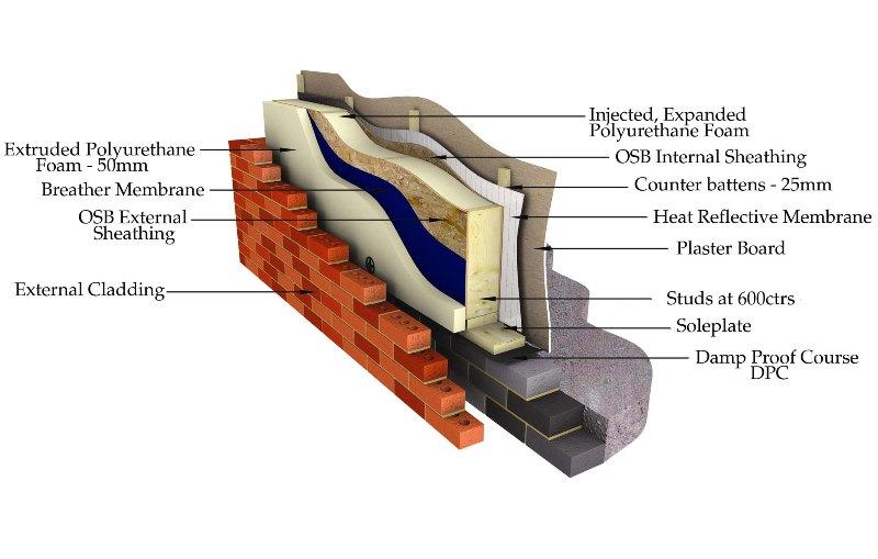

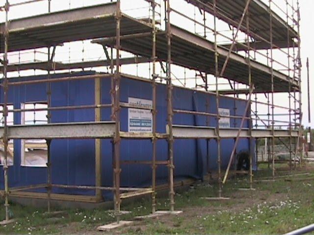

newhome Posted February 13, 2019 Posted February 13, 2019 So this is what I bought. The extra insulation on the outside is optional and takes the U value down from 0.14 to 0.11 so doesn’t form part of the delivered panel. Are you saying that if this had been delivered by a SIPs company it would be called SIPs? I’m wondering why the TF companies don’t use the term SIPs. Is that just a marketing thing, or is there a reason they want to avoid the term? I can see a wood frame in the photo showing the corner detail. Is that relevant?

Carrerahill Posted February 13, 2019 Posted February 13, 2019 (edited) 34 minutes ago, newhome said: So this is what I bought. The extra insulation on the outside is optional and takes the U value down from 0.14 to 0.11 so doesn’t form part of the delivered panel. Are you saying that if this had been delivered by a SIPs company it would be called SIPs? I’m wondering why the TF companies don’t use the term SIPs. Is that just a marketing thing, or is there a reason they want to avoid the term? I can see a wood frame in the photo showing the corner detail. Is that relevant? That is not a SIP. A SIP is just OSB/Insulation/OSB. They have connecting "spines" on them and they just push together like jigsaw pieces, no studs. The detail above to me looks like a fairly standard timber frame construction with foam injected between the studs rather than PIR foam cut and installed. A SIP is just a panel construction, these can just be bought as 8x4 panels and you can work them yourself to your build, or a SIP kit company will buy in SIPs and make them relevant to your build or indeed make the SIPs onsite themselves. You can make SIPS at home if you can be bothered. Edited February 13, 2019 by Carrerahill 1
ProDave Posted February 13, 2019 Posted February 13, 2019 You are missing the big difference. What you have @newhome is a timber frame where there are big structural timber members inside that gives the building it's strength. The fact your was supplied with the insulation in and the outsides closed in, does not stop it being a timber frame. A SIP panel has basically just sheets of something like OSB on both faces and insulation in the middle. There are no big structural timber frame members, the strength comes from the 2 skins bonded to the solid insulation. 1
Carrerahill Posted February 13, 2019 Posted February 13, 2019 (edited) I prefer what you have gone for. A good solid timber frame, fully injected with insulation makes for a good fill, no bad cuts and bits missing etc. Edited February 13, 2019 by Carrerahill

scottishjohn Posted February 13, 2019 Posted February 13, 2019 1 hour ago, Carrerahill said: That is not a SIP. A SIP is just OSB/Insulation/OSB. They have connecting "spines" on them and they just push together like jigsaw pieces, no studs. The detail above to me looks like a fairly standard timber frame construction with foam injected between the studs rather than PIR foam cut and installed. A SIP is just a panel construction, these can just be bought as 8x4 panels and you can work them yourself to your build, or a SIP kit company will buy in SIPs and make them relevant to your build or indeed make the SIPs onsite themselves. You can make SIPS at home if you can be bothered. the top picture looks like the main panel it is a type of SIPs ,but has wooden ends on each panel and therefore a slight cold bridge with the wood a modern sips would just use insulated splines ,so full wrap of insulation in the wall. that is probably why they added extra outer layer of insulation ,so there was no cold bridge caused by big wooden studs. so to all intents it is a sips . but do not think that all closed panel TF builds are done like that cos they are not ,most will use foam that has been cut to size and put into frame ,then another skin added ,but they will not glued to foam ,so it needs structural stud work to get strength - ,both systems will work fine if built correctly and all panels sealed together at build stage , If I was going to use either system I would probably go for sips ,unless there was big price advantage for closed panel,cos you rely on the makers making insulation a tight fit in framing with closed panel - so maybe if not going SIPS I would go open frame kit and make it closed myself with attention to detail of the foam and air tightness both systems need VCL on inside and breathable on outside --so very similar

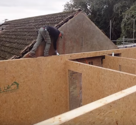

PeterW Posted February 19, 2019 Posted February 19, 2019 4 hours ago, oranjeboom said: A few install pics/vids here: Is it just me that looks at the use of a ratchet strap as a way of holding a panel to a scaffold pole slightly scary ..??!!

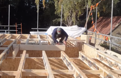

Mr Punter Posted February 19, 2019 Posted February 19, 2019 8 minutes ago, PeterW said: Is it just me that looks at the use of a ratchet strap as a way of holding a panel to a scaffold pole slightly scary ..??!! Or these bits (and I have certainly done far worse):
