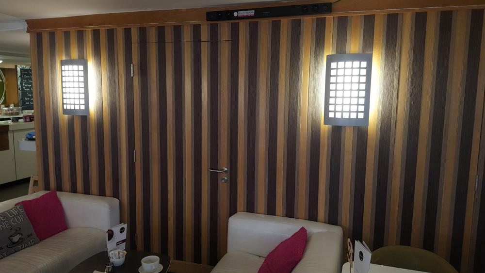

Ferdinand Posted February 11, 2019 Share Posted February 11, 2019 (edited) On 08/02/2019 at 12:52, recoveringacademic said: I've got 25mm left. Between the slab and FFL. And we want a wet room. Ain't gonna happen is it? Well anyway thats what the man from Topps tiles said. Yes, yes, I know. And if you look at some of my earlier threads (2 - 3 years ago) you'll understand why. Moving swiftly on, I need to dig out. By how much? (PS, I've got the drain hole in the right place - and for me thats a success) Weren't you planning to camouflage the door to this, @recoveringacademic? Another Example, by making the wall stripey. Male it full height and it would be completely hidden. Edited February 11, 2019 by Ferdinand Link to comment Share on other sites More sharing options...
Construction Channel Posted February 11, 2019 Share Posted February 11, 2019 1 hour ago, Ferdinand said: Weren't you planning to camouflage the door to this, @recoveringacademic? Another Example, by making the wall stripey. Male it full height and it would be completely hidden. Apart from the clearly visible door handle and hinges I can barely see the door at all ?. Not a bad effort though Link to comment Share on other sites More sharing options...
