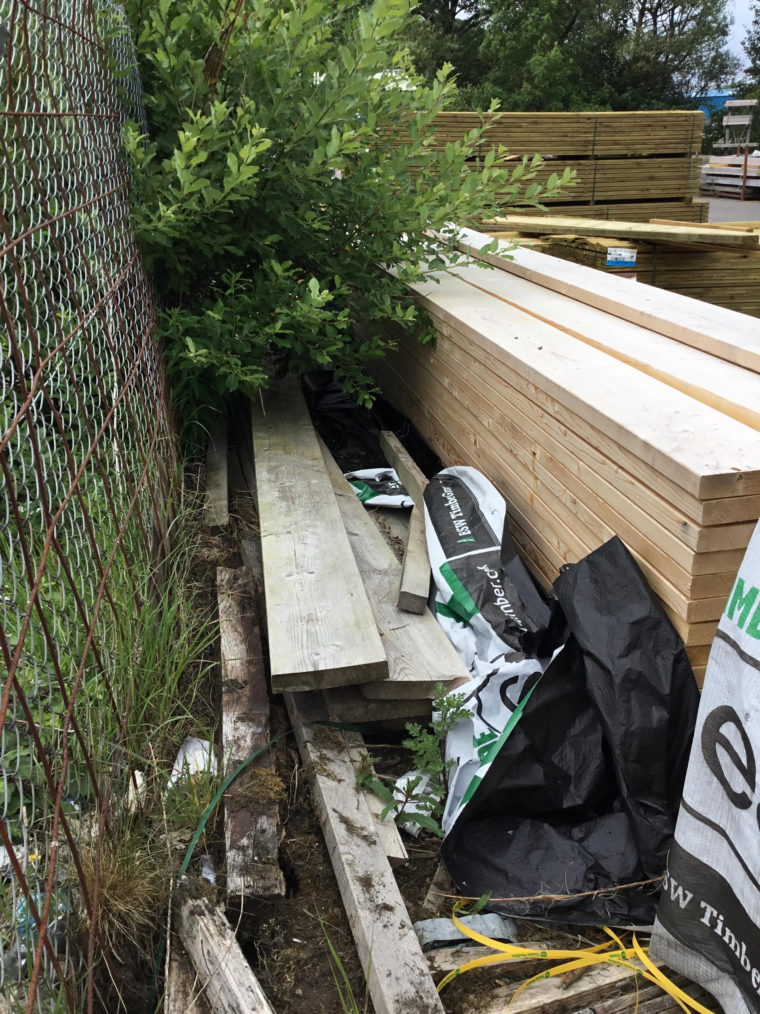

Onoff Posted January 18, 2019 Share Posted January 18, 2019 (edited) Whats the existing ground floor to first floor rise? 6x2 and 8x2 as in rough sawn or treated with the rounded edges like mine in the pics? Is it actually 195x45 & 145x45? Edited January 18, 2019 by Onoff Link to comment Share on other sites More sharing options...

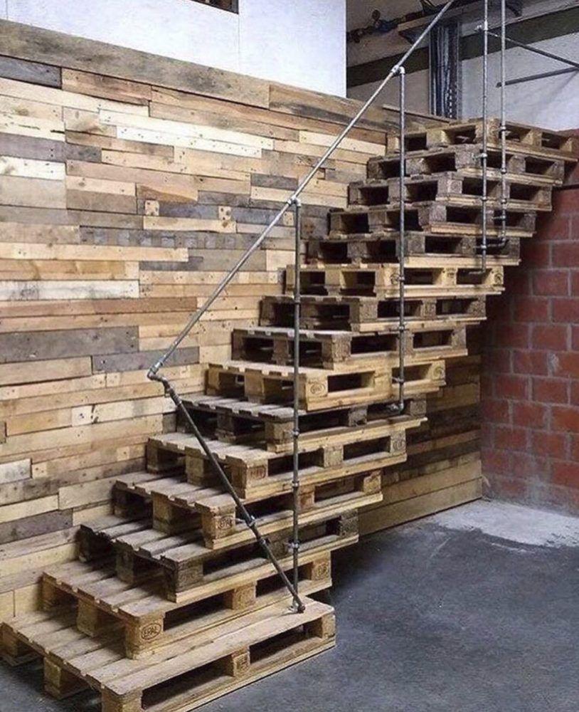

Onoff Posted January 18, 2019 Share Posted January 18, 2019 Pallet stairs... Depends whether the figures stack up... 1 Link to comment Share on other sites More sharing options...

Construction Channel Posted January 18, 2019 Share Posted January 18, 2019 I think the pallets sound like a great idea, personally I would go for two per rise just so it feels more "normal". Plenty of bracing and a hand rail and it may end up being a permanent feature...... But seriously the transition from a ladder to stairs really is a great day ? 1 Link to comment Share on other sites More sharing options...

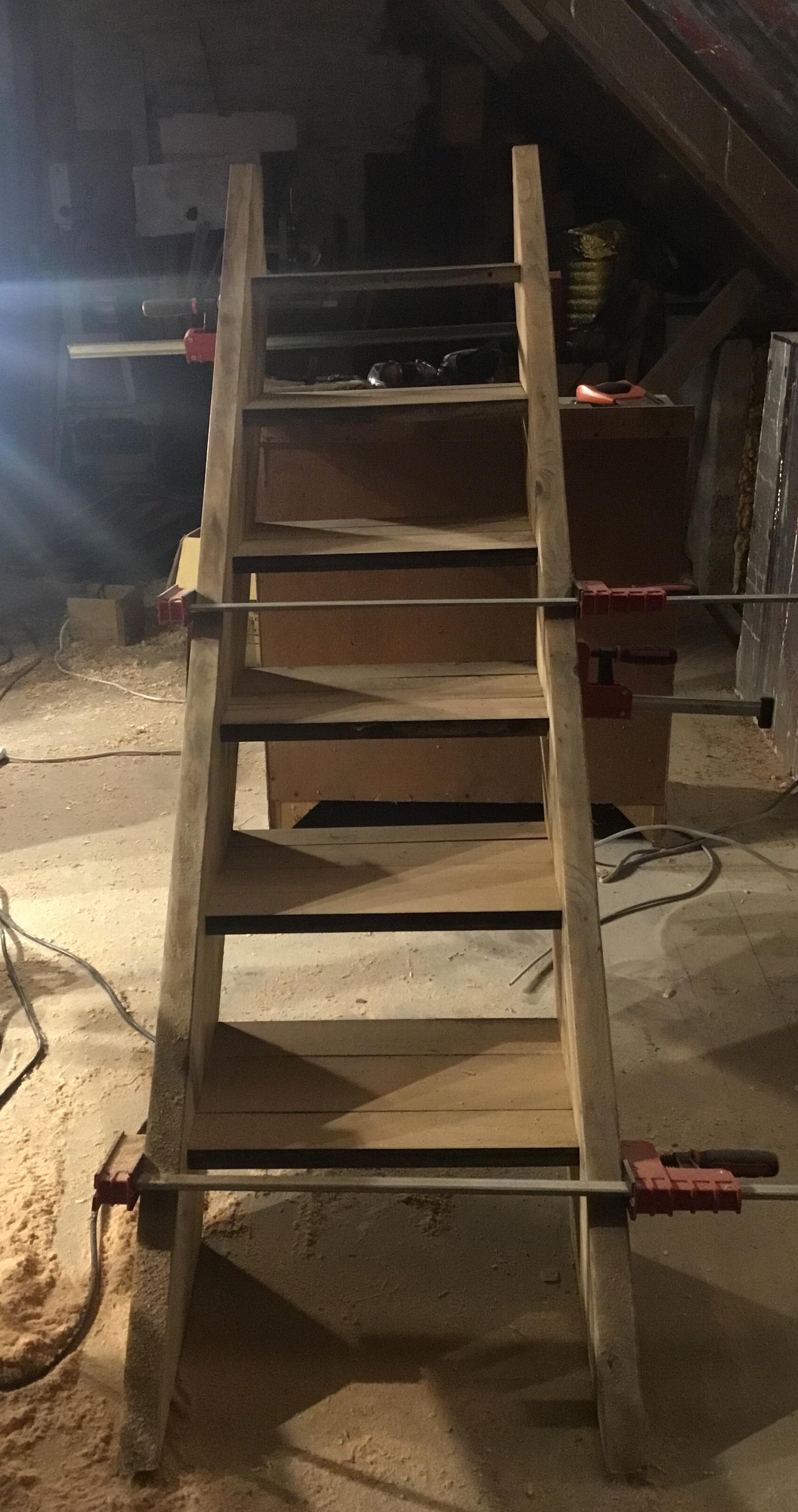

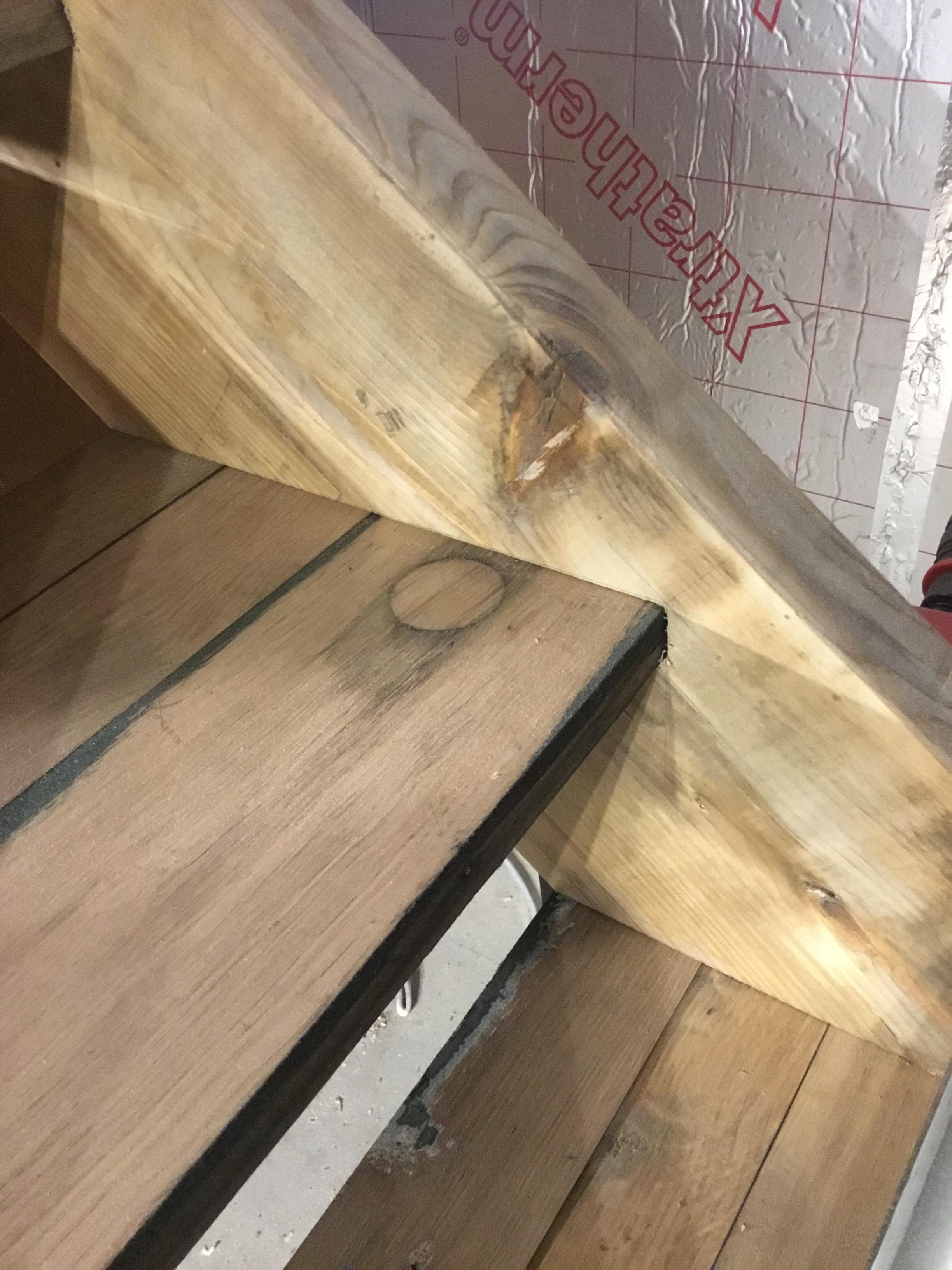

Cpd Posted January 18, 2019 Share Posted January 18, 2019 Just making a staircase for my shed, made out of salvaged 10x2 for the stringers (back of the stack at builders merchant) and oak whisky barrel lids for the treads (also free) , will be 6 steps @200mm risers then a small platform and another 4 steps @200mm. It’s only 600mm wide and goes up to a walkway between two mezzanine storage areas. Should be installing them tomorrow or the day after. Cost £0 (but I did wear out a set of planer blades cleaning up the barrel lids..... time spent building it...... two days...... maybe three. But it was a great training exercise for when I have to build new stairs for the cottage. Link to comment Share on other sites More sharing options...
