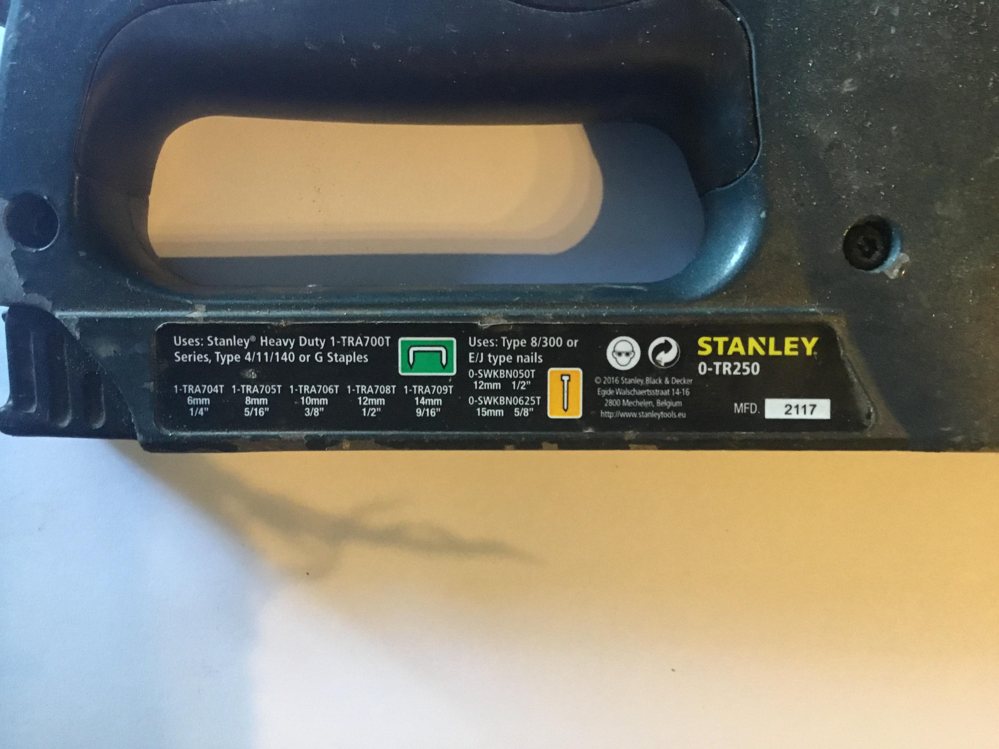

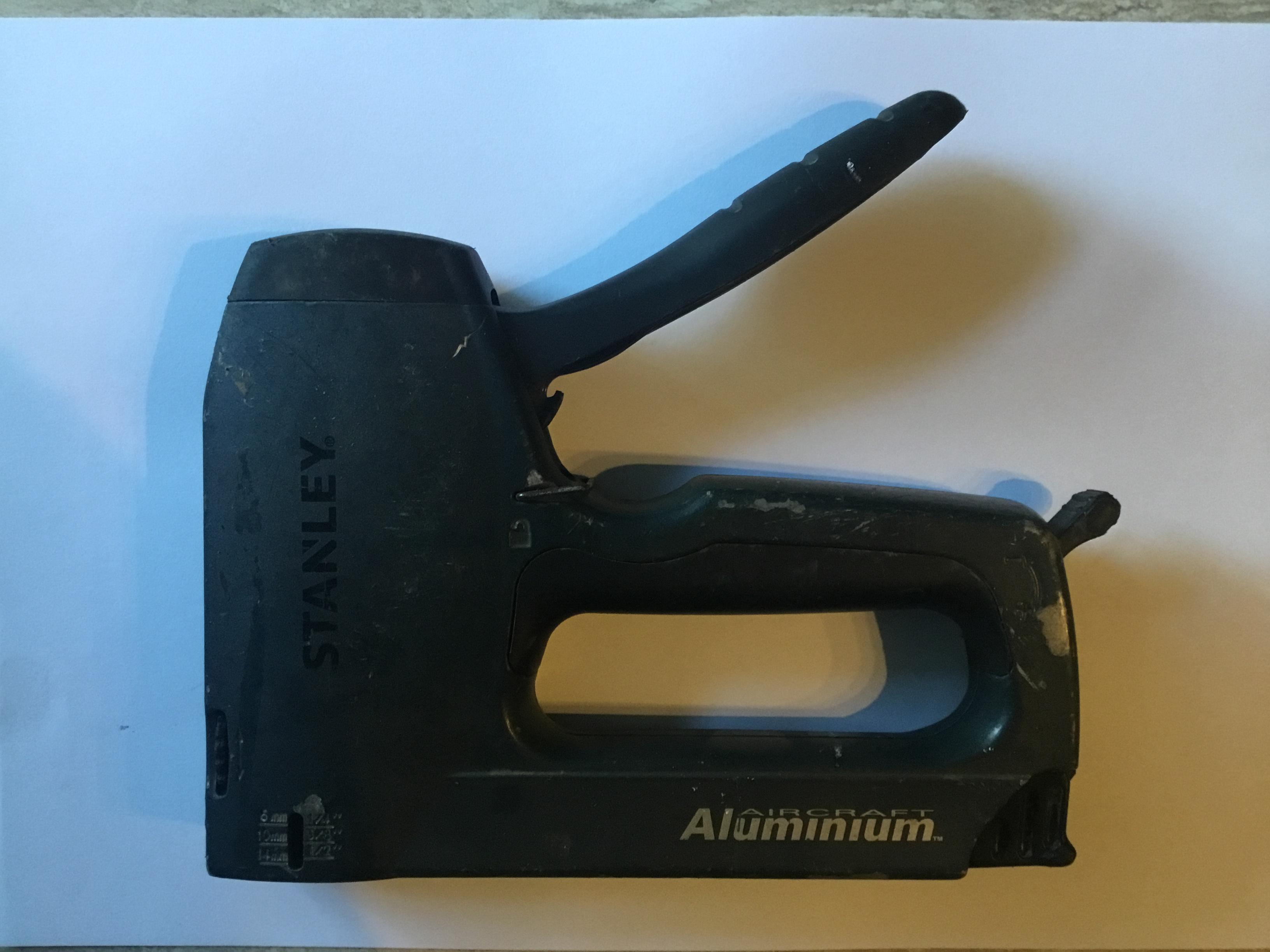

Cpd Posted January 16, 2019 Posted January 16, 2019 I have got this Stanley, it’s VERY good and has worked faultlessly for over 2 years. I have dropped it of many a roof without a problem...... I have also got a hammer tacker but really don’t like using it, personal preference. 2
Ed Davies Posted January 16, 2019 Posted January 16, 2019 I have a few, none of which is satisfactory. A little electric stapler/brad nailer which would probably be fine for furniture stuff running off mains but hardly tacks at all running off either my inverter generator or 1200W inverter - I assume it takes too large a pulse for the inverters to ramp up and give the necessary power. A little Powerfix (Lidl) one which would again be fine for furniture. An Arrow one bought from the local builder's merchant which looks appropriately chunky but usually doesn't drive the staple right in to membrane/OSB, though a quick tap with the hammer sorts that, but worse jams a lot and is a pain to take apart to unjam - have to take off a small nylock nut. Not a happy thing up scaffolding, wearing gloves in failing light. So @Cpd's Stanley looks very tempting. OTOH, I'll need a second-fix nailer too fairly soon so a cordless brad nailer/stapler might be a better bet. I find that it's best to staple two handed with the Arrow stapler as otherwise squeezing the lever can pull the staple emitting bit away from the surface and suspect the same might be true of the Stanley. Not a problem in ideal circumstances but reaching into awkward corners, etc, can make that a bit tricky. So a one-handed electric one might be better. Still, the Stanley's quite cheap so worth having in the tool box, I suspect.
Gone West Posted January 16, 2019 Posted January 16, 2019 +1 for the Stanley stapler. I've had mine for years and easy to use.
Triassic Posted January 17, 2019 Author Posted January 17, 2019 Just ordered the Stanley staplers, £15.49 inc delivery.
Ed Davies Posted June 11, 2019 Posted June 11, 2019 Used the Stanley stapler on and off over the last few weeks including a lot yesterday. Very happy with it - easy and comfortable to use and a lot more reliable than the others I have. 1

Triassic Posted June 11, 2019 Author Posted June 11, 2019 On 17/01/2019 at 07:39, Triassic said: Just ordered the Stanley staplers, £15.49 inc delivery. It’s so good we’ve just ordered a second one. The joy of membrane placement!
