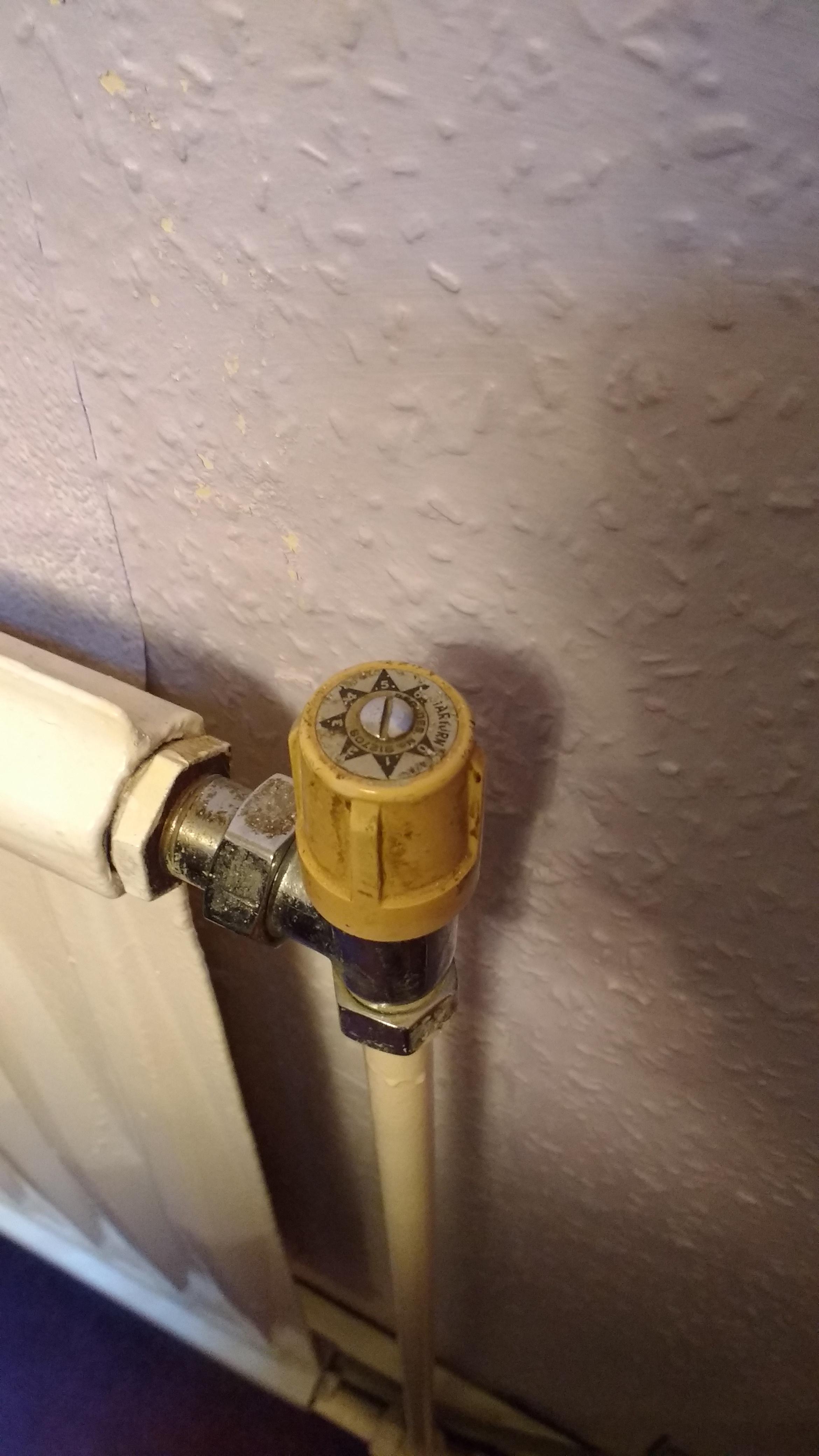

Onoff Posted November 7, 2020 Author Posted November 7, 2020 The modern rads, 4 upstairs and one downstairs, all the rad valves are open. The old rads downstairs, the remaining 7, I can't move any of the valves at all:

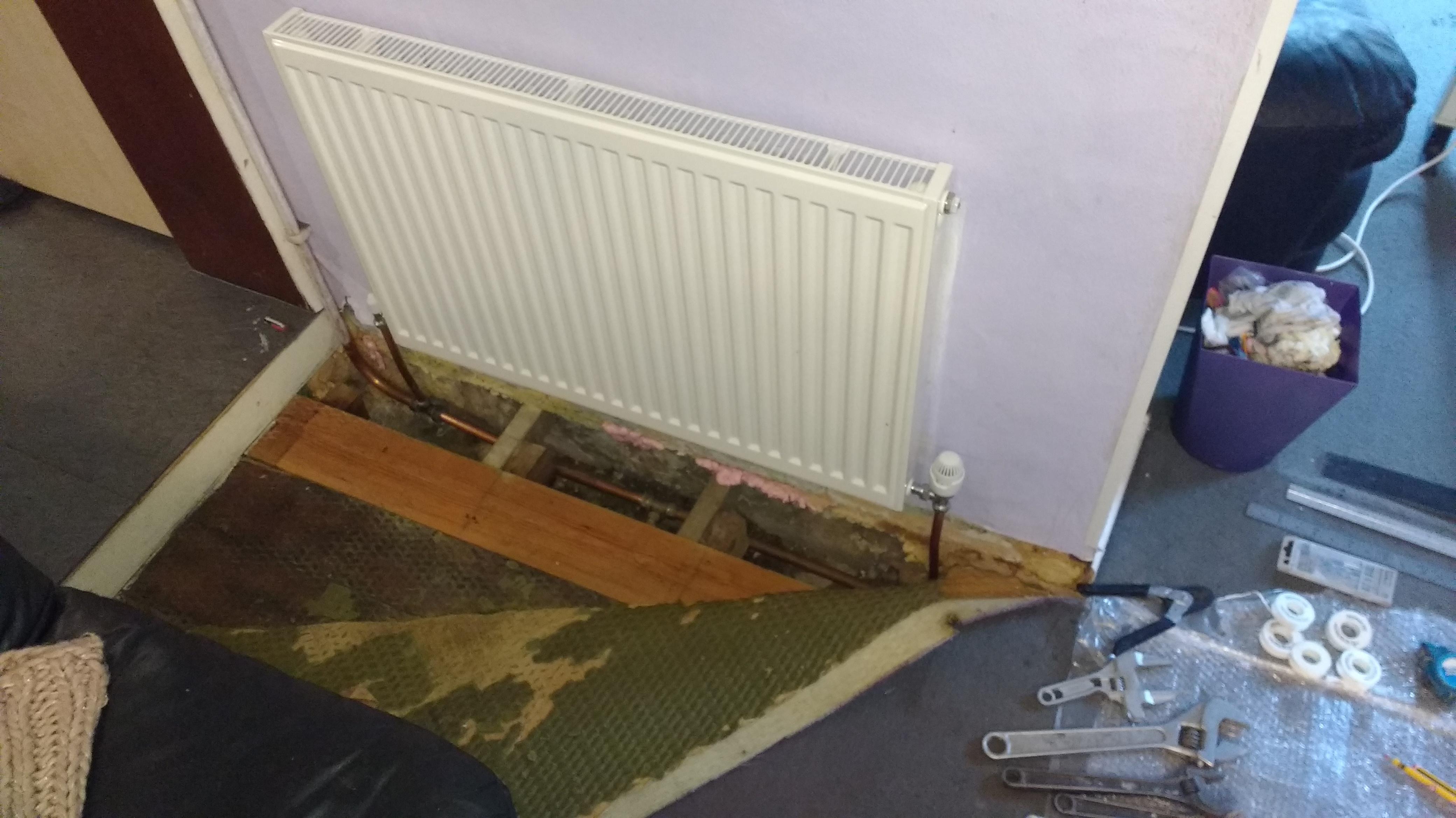

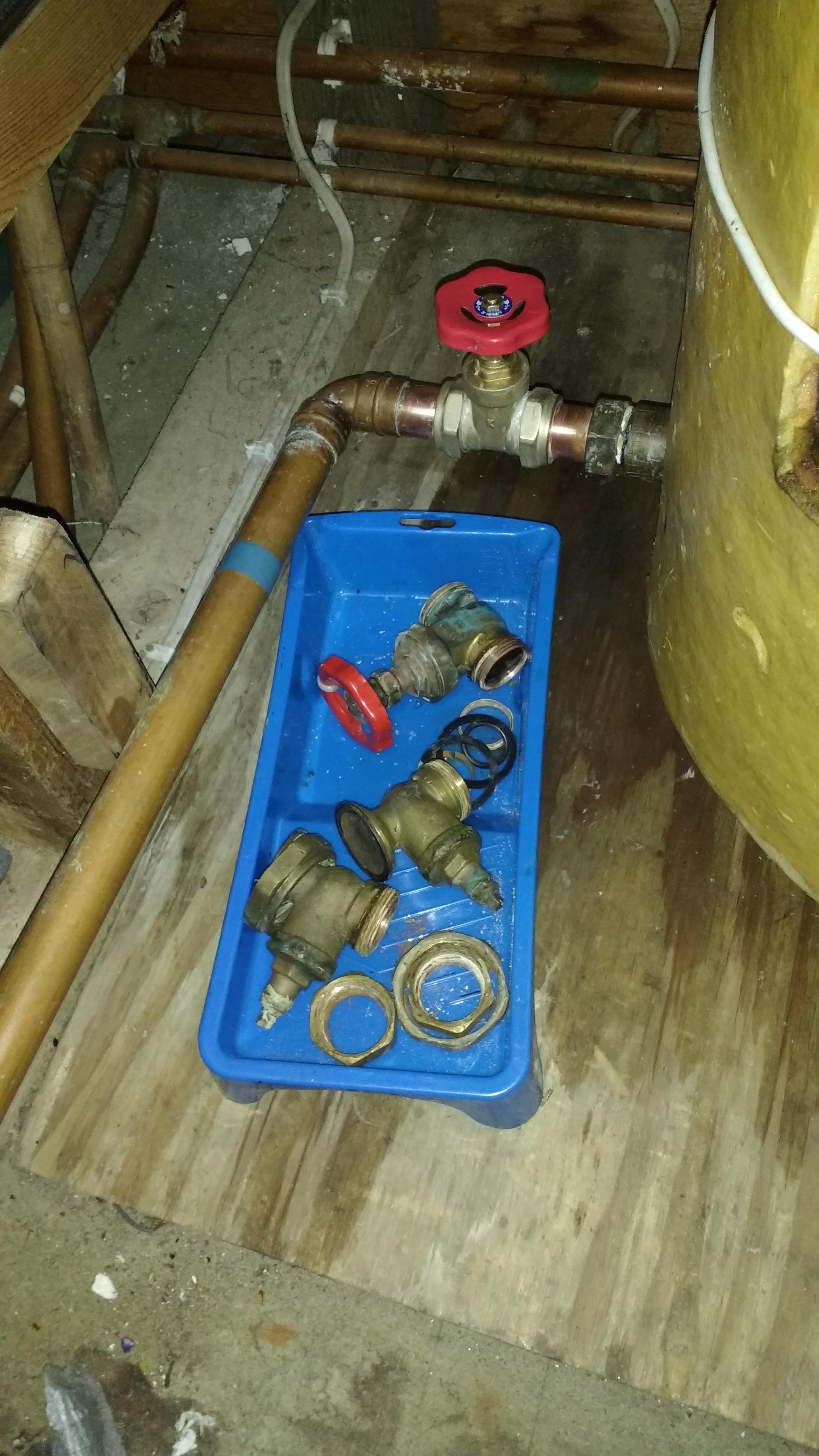

Onoff Posted November 8, 2020 Author Posted November 8, 2020 New rad in, a tad on the pi$$ but then it matches everything else! It wasn't but it's ended up so... The first two coach bolts that came with the SF rad sheared in the SF supplied red plugs in the rad kit. 8mm hole my ar5e, the top half inch of the plug is a bigger dia! Blue plugs now and my coach bolts, 6 in total. So that's 8 compressions made/remade as I had to tweak one of the T's on the single pipe. I'll be watching them for leaks. Plus the 2 rad rails with 15 turns of PTFE tape on each. Off to do the balancing valve at the base of the cylinder now.

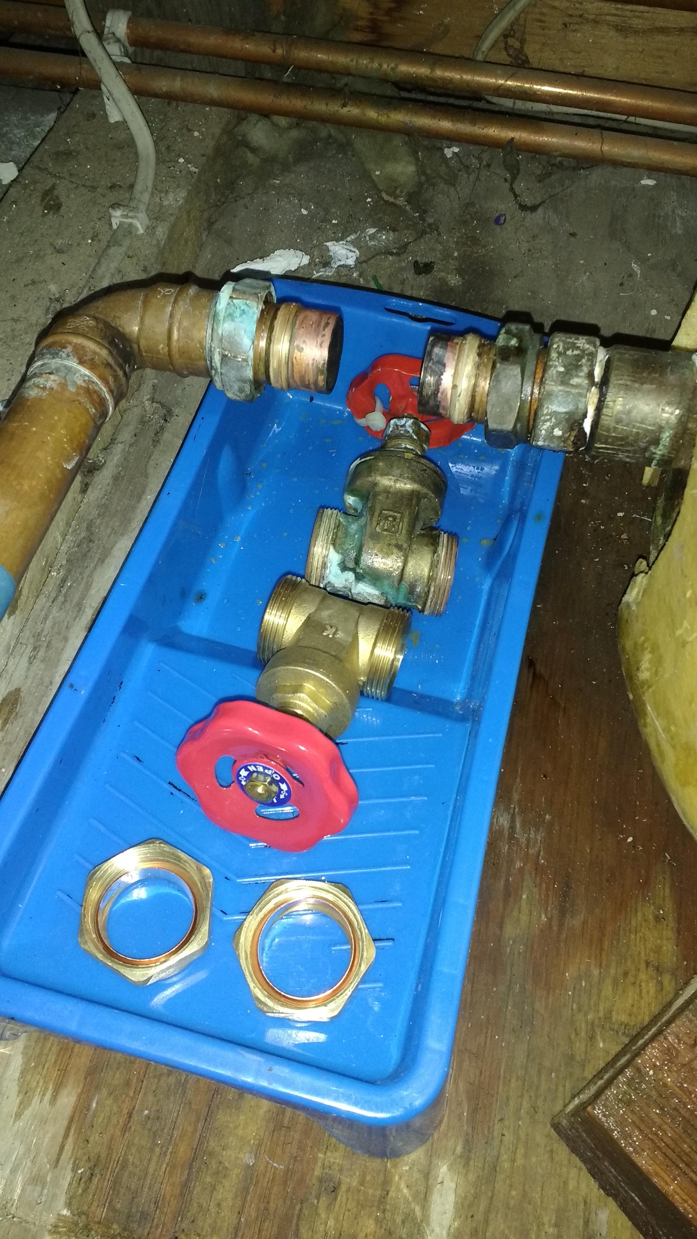

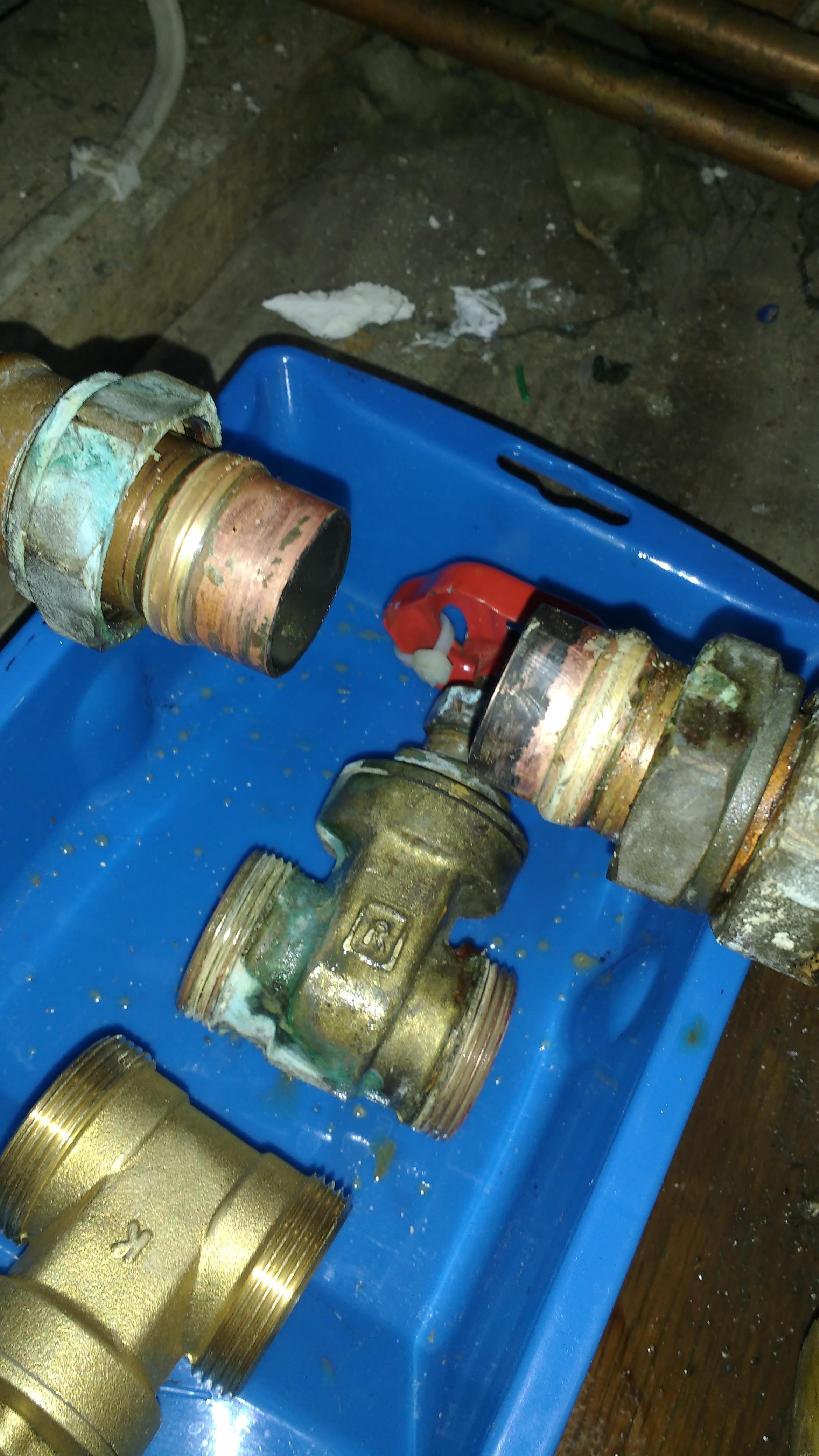

Onoff Posted November 8, 2020 Author Posted November 8, 2020 (edited) Is it a bad idea to reuse olives? Or is half hour with the multi tool the answer? ? I wouldn't usually but no original fittings here were done up using for instance Jet Blue Plus which I use now. That lubricates as well as seals and allows you to get the joint a bit tighter. New valve's a tad shorter! Edited November 8, 2020 by Onoff
MJNewton Posted November 8, 2020 Posted November 8, 2020 It's preferable not too, particularly if the replacement component is of slugjtly different dimensions. A diagonal cut across the olive with a junior hacksaw 3/4 of the way through (being careful not to nick the pipe) and then twisting with a screwdriver will remove the old ones in no time at all.
Onoff Posted November 8, 2020 Author Posted November 8, 2020 Well it's about bleeding time! Answering my own questions here! ? Multi tooled off the 28mm olives. New valve on. Had to "ease" over the copper return pipe in the left. Hence the wooden packer. Nice fresh water, from a nice clean F&E tank, now refilling the system. A cuppa & something to eat then off leak hunting then bleeding! Just hope the tank fitting and soldered joints where I eased the pipe over hold up. Soul destroying if not. Just realised why occasionally an electric shower is worthwhile.
PeterW Posted November 8, 2020 Posted November 8, 2020 Threads in the nuts look different. As @MJNewton said, junior hacksaw and 2 mins and they will be off
