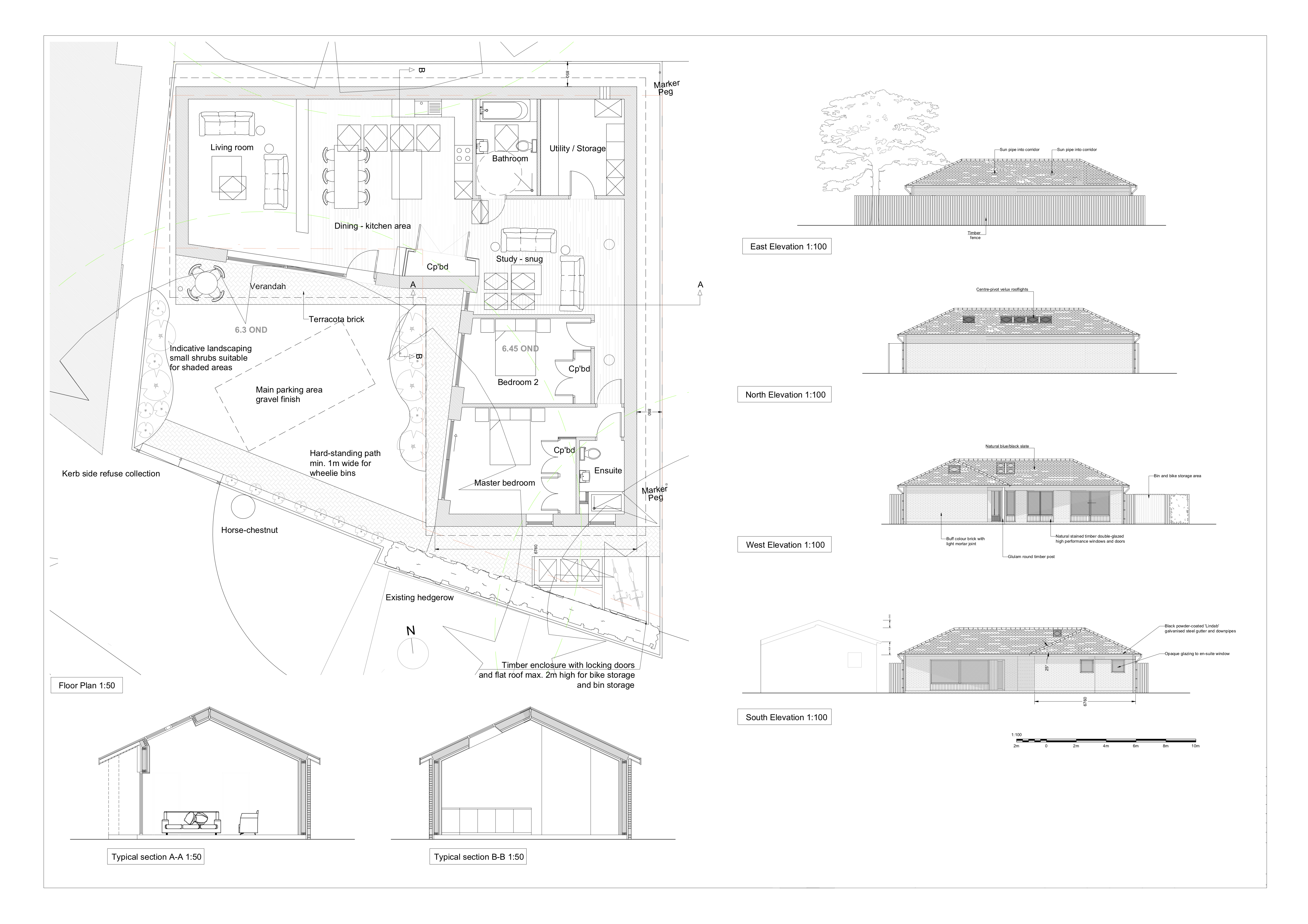

This is what has gone to planning for approval. I would welcome people's opinions, observations and suggestions for floor plan tweaks.
  • The aim was to design a floor plan with an eye on saleability
  • The constraints are that we are forbidden to overlook to east or north. Even roof windows are not allowed on the east but are allowed on the north. We are limited in height. And we cannot remove any trees.

Any particular preference for having the utility room and bathroom that way round?
It seems a bit crowded where the snug is, perhaps swapping this around with door now opening inward might be better?
Also the roof lights above the snug, is it worth going for two large ones rather than four individual ones? Would probably save some installation time and allow more light to come through with less frames.
Does the Verandah/outside sitting area have any privacy/view or is principal job to create a break between the parking and the building?

Excellent plan for saleability. Well designed to the planning constraints imposed.
1 - I am not sure you need the wall between the living room and the kitchen at all, given that you have a snug.
2 - I would put a storage loft, designed so as also to be a possible sleeping platform, above the utility/bathroom area. Probably storage above the utility, perhaps more open storage/sleeping above the bathroom.
3 - Given the location and that it is a bungalow, I would add a large wheel-in shower in the bathroom and verify that there’s space for a hoist - check location of roof beam or have a stronger bit of wall?, even if it meant moving the utility room wall by 200mm or so. Ditto disabled friendly cooking facilities in kitchen.
4 - I concur on rooflights with the above.
5 - I might have a layout in my back pocket demonstrating how it had originally been a 3 bed proposal that I had had to modify in ways that could be reinstated in order to get approval ?.
6 - Are you sure you cannot have translucent roof lights instead of solar pipes on that side? Or is that personal insurance rather than planning condition?
7 - If I was living in it I would take a careful look at that horse chestnut for the longer term; they are notorious.

You hit a bulls eye on the main compromises.
Natural light. The bathroom has a skylight. We could not fit one in the roof in the corner so moved the utility room there.
That areas is a bit of a compromise. It's a flexible space. We could even enclose it in walls to make an office.
Possibly yes. My architect thinks four in a grid looks better. I am open.
Privacy yes. View: not really, just sky. It exists because of a window in the building to the left which as a high-level (above head height) window there (just visible marked on the plan). By pushing our wall back it prevents even the impression of obstruction of that window but in doing so creates the small sheltered area, which is a flexible space with could be used for outside seating or even just sheltered storage. That's the idea.
Pleasing to hear. Thank you.
Good point. The snug however could conceivably be contained by walls to make an office/library. What do you think of that idea?
Very interesting idea. I would like to explore this at timber-frame-design time. Note that the area above the bathroom area is constrained by its skylight.
Good point. Will do that.
Fair challenge. Aesthetically better having them in a cluster? Or is that overridden by reduced cost/less frame of having fewer? Unsure.
Oh, interesting thought. I don't know how planners view number-of-bedrooms for a site like this. Is more always better? I imagined two was plenty for the site.
Yes sure. It was like drawing teeth to negotiate even the solar pipes. That neighbour, the seller, is (understandably) concerned by unsightly light pollution on that side. It is close to his house.
Notorious for? Unfortunately for those who are fans of that tree (and there are many) its quite sick. The tree specialist says it has bleeding canker and honey fungus. I (a non expert) suspect it wont last more than 10 years. But it is in a conservation zone and has an army of fans. Its located just off my property in the unadopted road (no known owner).

If it's only a 2 bed for now, might there be anything to be gained with chopping out the communal bathroom, throwing another en-suite at it and then moving things around with that in mind
  • Thanks 1
Posted
If you put walls up in the snug could that be a study / bed 3? Mine is a 5 bed but we decided not to put the stud wall in to make bed 5. It’s an open plan upstairs seating area currently but has been designed so that a single stud wall and door opposite the family bathroom would make the 5th bedroom again.

For me that bathroom is in the wrong place - I would swap study/snug and bathroom positions make the utility smaller to give more room for study/snug and build a ceiling in the utility to give some roof storage space as storage is very limited in the house and no garage.  I would take down the wall between the kitchen and living room.
Having said all that is there some rule that habitable rooms have to have an opening window?  Roof light in present bathroom may not suffice to swap it into study/snug if so.
Glad to see you have incorporated a tiny outdoor space for a table and chairs.

Not too keen on having the front door directly into the main living space.  Did you see @AliG's plans for a bungalow?
I thought you could do similar and incorporate the hall and study space by moving the front door.plan.thumb.png.8051b8c645e945c38f02c8f41b234877.png

Here are my thoughts using those check points mentioned in another thread.
Does the plan clearly convey an objective?
Yes.
How well does the plan achieve that objective?
Pretty good.
Would I enjoy a short holiday let in the property?
Strong yes with its walking distance to central Cambridge but mostly it is a refreshing alternative to most British domestic house design.
Would I want to own or build this property?
Strong yes. I think the market would financially reward the builder, it provides a non car based lifestyle in a global ivy league university city. The design provides something different in a city where buyers should be receptive to innovation. As a buyer of the property I would start discounting from the asking price to fix the elements of the internal design that do not work for me.
Specific comments:
  1. Like others I had a bad reaction to the sky light arrangements. The sky lights look like adhoc retro fits implemented to fix a design error, the net result is a roofline that resembles a maintenance depot shed. Suggest fewer larger non square roof lights. Having said that I do appreciate that black and white technical drawings tend to over emphasize detail and in real life these skylights might visually melt way.
  2. I would want to rework the landscaping to create a late afternoon patio outside the main bedroom to catch the late afternoon sun though I appreciate your current focus might be internal privacy from the road.
  3. The snug simply does not work and it would take some particularly creative internal decor to improve this. I cannot think why I would head for the snug when leaving the kitchen because the living room is the same number of steps away with much more window area. If you wish to retain the snug you could adopt some ideas about creating a cosy space by looking at traditional rural spanish houses that have a hunker down for the winter inner living room.
  4. I would swap the utility room and bathroom around and have the bathroom door facing down the bedroom corridor. The occupants of bedroom-2 should find the bathroom closer and this will also improve the coupling of utility room and kitchen.
  5. Keep the kitchen/living partition wall. The design is already open plan enough and that wall helps specialize the spaces.
  6. Finally and a biggie. I don't like the 1960's aspect ratio of the principal windows. I would subdivide them with pillars though I fear this would cause havoc with you carefully crafted solar gain calculations.

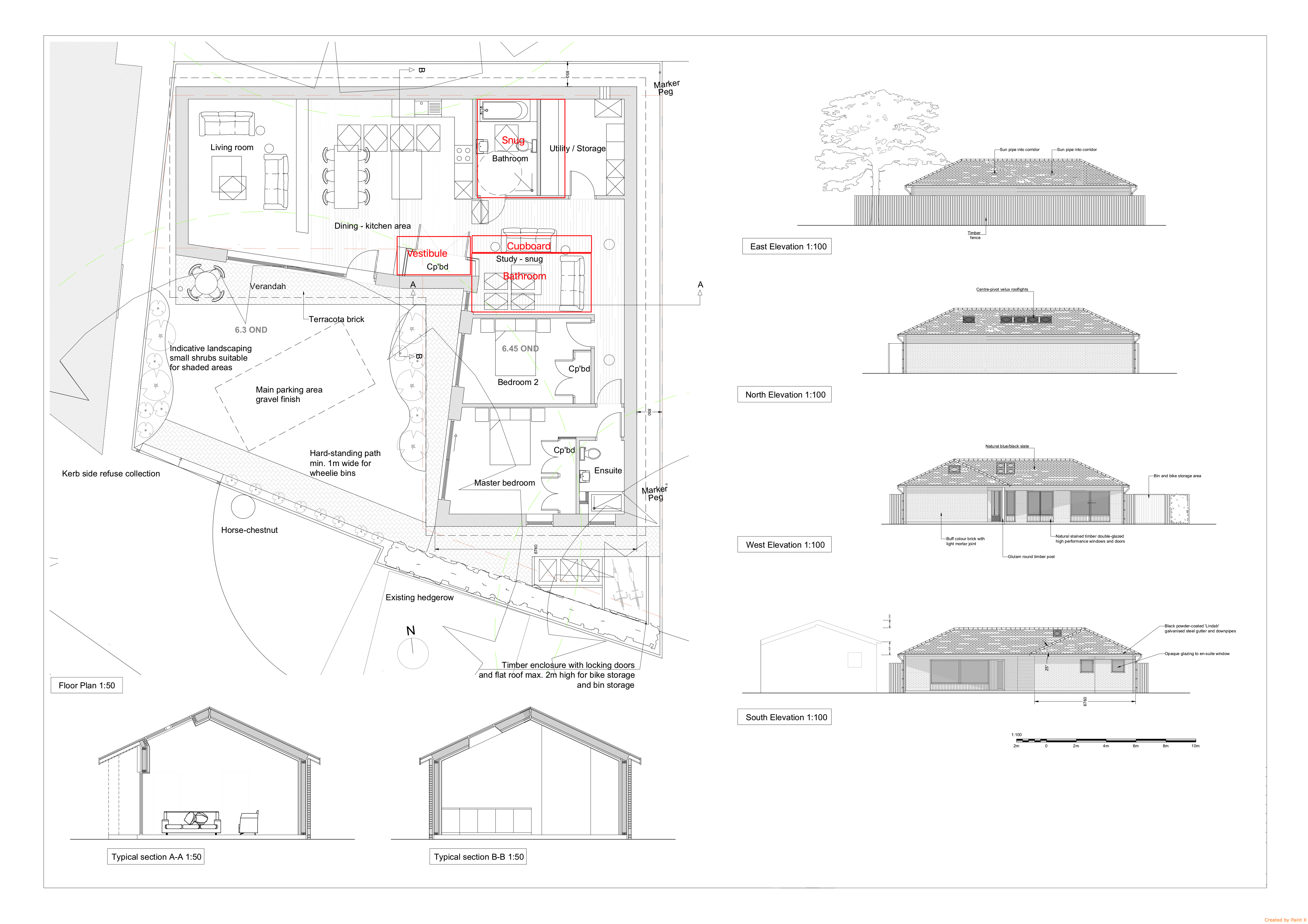

I came to this when my parents' house was referenced.
The design makes good use of space, by not having a hall you maximise living space, but it is not a design for everyone and I do think you have to be careful. It is easy to create a feeling you are inhabiting a hall/pass through space and not feel comfortable.
I think some of the comments re the snug reflect this. Also I tend to agree that I would not like the front door opening into the kitchen. I would feel quite uncomfortable if people make a delivery and we are all sitting down to dinner for example.
I am very curious why that cupboard has been put in next to the front door on one of the places that you can have a proper window, it seems a missed opportunity.
Having looked at it, I have very roughly annotated the plan.
Basically swap the snug and the bathroom. The bathroom will be nearer the bedrooms, it could have a door to bedroom 2 also if you like. Put a large cupboard along the bathroom wall and take away the current cupboard to allow another window. Actually even better, you could move the front door towards the corner and have a vestibule so that it doesn't open directly onto the kitchen rather than having an extra window.You would probably make the utility a bit smaller which you could do with a larger cupboard.
The snug could be incorporated into a much larger kitchen, you might want to change the kitchen plan or separated by a wall. You could still leave it open to the hall but people would be walking past not through it.
This fixes the roof window issue that people have as you just continue the row across the kitchen roof, The small window in the wall will be enough for the bathroom. It could save you a couple of roof windows also. You also won't have the roof lights on the front of the house anymore, they will all be at the back.
This would also allow storage above the bathroom as there won't be a roof window there now.
