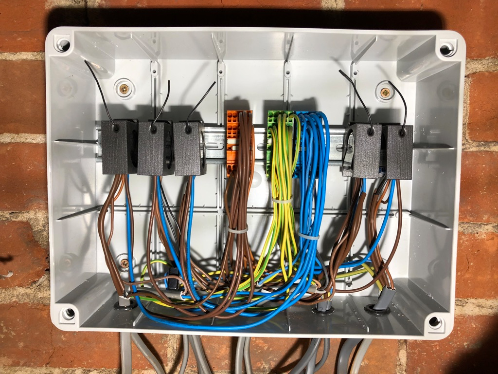

Heres an example of a wiring point (this one covers upstairs). It's not pretty so you may want to avert your eyes if you are of a nervous disposition...
Essentially you've got power in, a 3C+E from each switch point and then T&E out to each lighting set. This one also does the bathroom fan. I expect @jack can post some pictures of a properly wired Loxone system to show how it should be done.
N.B - This looks horrible, please please don't copy. If in doubt get a qualified spark in etc etc.
That is nothing remotely like mine!
It could be that because I have no ceiling void (single storey) that mine is different.  I have all led a mix of wall lights ceiling downlights, floor uplights, pendants and led tape.  I also have a 5 amp circuit for lamps. All run by dynalite system.  Have wall switches and app control. Have also some lights on pir sensors not on automated system.

This is mine in the plant room.
On outside lighting have it on auto as well as pir so if its off on auto it will come on if sensor activated.
Is there a cover over the top of all that exposed wiring?  I hope so, as it looks to me as if there are exposed single insulated conductors to the right hand side of the modules there, and they need to be covered, or be double insulated, in order to comply with wiring regs, unless they are ELV/SELV compliant.

@JSHarris yes its all safe, certified and compliant. Its a professional installation not only certified by installing electrician and inspected by building control for sign off but in addition installer had his annual professional competence check inspection here.  May be not a good photo for detail.
I think it's OK. The top boxes in each pair seem to be these:
https://power.sager.com/hlg-150h-48a-2525351.html
Mains to 48 V DC power supplies. Presumably SELV though all the spec says is UL approved for wet applications. This datasheet  does say: “ISOLATION RESISTANCE: I/P-O/P, I/P-FG, O/P-FG:100M Ohms / 500VDC / 25 / 70% RH”.
The lower boxes seem to be quad dc-dc DMX drivers so won't have mains voltages though the iDrive name seems to be used for multiple boxes none of which look exactly like this. Presumably the DIP switches on the left set the DMX address. Or maybe they're some other protocol than DMX but something similar. Whatever, they presumably feed off the 48 V input.
So the only voltage above approx 48 V will be the flex from the switched connection units to the power supplies which will, of course, be double insulated.

13 hours ago, lizzie said:
plus pic of conventional installation for non automated install in bedrooms which I think may be more the type if thing @JSHarris is mentioning.
That's the one that had me concerned, as it shows LV colour coded single insulated cable, with no second insulation layer, as required for any LV cabling.  From what's been written above this isn't LV wiring, but is either ELV or SELV, with the wrong colours.  As such, if it's really ELV/SELV then it doesn't need double insulation.  However, it shouldn't really be using LV colour coding, as the chances are others will look at it and jump to the same conclusion I did.

Just realised I've been guilty of the over-use of acronyms...
LV = Low Voltage, which in this specific context means 230 VAC nominal, i.e. normal mains voltage, where the line conductor is identified by being brown and the neutral conductor by being blue.  The full LV voltage range is over 50 VAC up to 1000 VAC, over 120 VDC up to 1500 VDC.
ELV =  Extra Low Voltage, not greater than 50 VAC or 120 VDC, although the EU LV Directive applies to anything over 75 VDC
SELV = Separated (or Safety) Extra Low Voltage, as for ELV but with isolation from any Protective Earth (PE).

My understanding of ELV wiring colours:
Brown - polarity not connected to earth (usually positive).
Blue - other polarity which is connected to earth (so ELV but not SELV).
Grey - other polarity also not connected to earth (so SELV).
Any corrections to that?
So if they earthed those blue cables elsewhere (making it PELV or FELV rather than SELV) that'd be OK, but I suspect they don't. But this is all getting pretty picky, frankly. Power over Ethernet would, I imagine, typically be SELV but uses blue and brown (and blue/white and brown/white) - I doubt building control is ever going to tell people to rip that out as non-compliant.
Edit to add: in summary, my understanding is that ELV colours are the same as LV, first power voltage not referenced to earth  is brown (like line or phase 1) then the next is grey and presumably black if there's a third one, but they'd need labelling by that point, whereas a power voltage referenced to earth (like neutral) is blue.

Can I just say my lighting was professionally designed and then installed by a specialist electrician.  There were reams of technical drawings and the installation was inspected by the design company, certified by the installing electrician, passed by his professional competence inspector (our install was used for his annual site inspection check) and signed off by building control.
I cannot conceive that all those professionals would have closed their eyes to something that did not meet regulations.
My lighting and electrics are one of the few areas on this build that have lived up to expectations of the comptence of so called professional trades.
I wasn't for a moment suggesting otherwise.
The confusion comes from seeing what to all intents and purposes in a photo appeared to be LV wiring that wasn't double insulated, that's all.  Without being able to read what was on the boxes (assuming that they are labelled to indicate that the voltage on those wires is really ELV/SELV) then the only safe assumption anyone could make would be to assume they were LV; i.e. at mains potential.
FWIW, I used to teach electrician apprentices years ago, and the golden rule was never, ever assume that anything is safe until you have positively identified and tested it to be so, and to always assume the worst case until you have proven beyond doubt otherwise.
