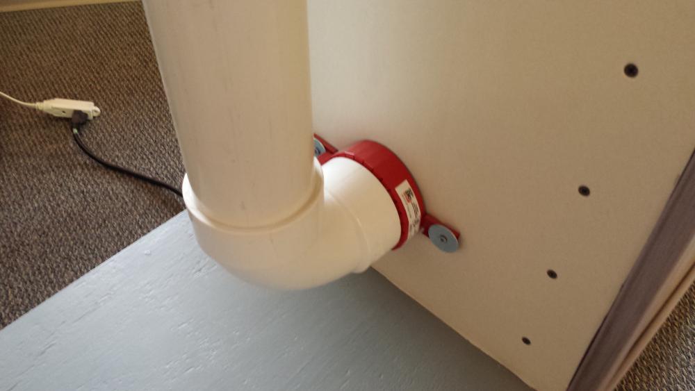

No special pipes are required, we have some installed just as a safety precaution becuase I brought a load of intumescent seals for the external cladding I went overboard when ordering fire protection stuff
http://www.ironmongerydirect.co.uk/products/intumescent_and_fire_control/intumescent_accessories/436/pyroplex_4_hour_pipe_closing_collar_stainless_steel/258507.

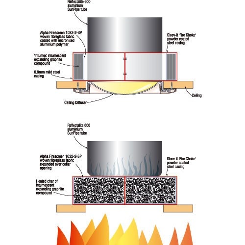

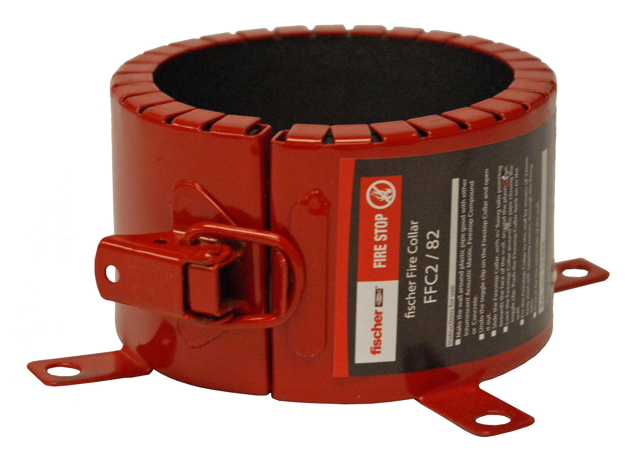

The ones I fit are identical, mostly required on HMO / student rental refurbishments. They are steel belted and have a robust buckle / hasp arrangement so re the comment about them being surrounded by bricks / similar I'm not entirely sure that's the case. These are capable of expanding during a fire, and provide that force by means of expanding against said collar.
Expanding entirely to close an opening is only possible when the pipe itself deteriorates ( eg the heated / melting plastic of a soil pipe softens and aids the total closure / compression ) but I'd certainly not use the term 'crushes' tbh as it's possible for someone to wrongly assume that it has the strength to do so to any random pipe. One of metal construction for eg will not crush as it will have immense strength when force is applied equally to it's outer diameter ;)  Only nit-picking that statement as this is a particularly important subject :)
I've fitted these collars under the watchful eye of BCO's and I can tell you that they're accepted even when fitted to two layers of fire rated plasterboard, with no other mechanical fixing, and no brick / block work / similar solid construction. These will work in a TF house as well as in any brick built house, AS LONG AS THEY'VE BEEN FITTED CORRECTLY.

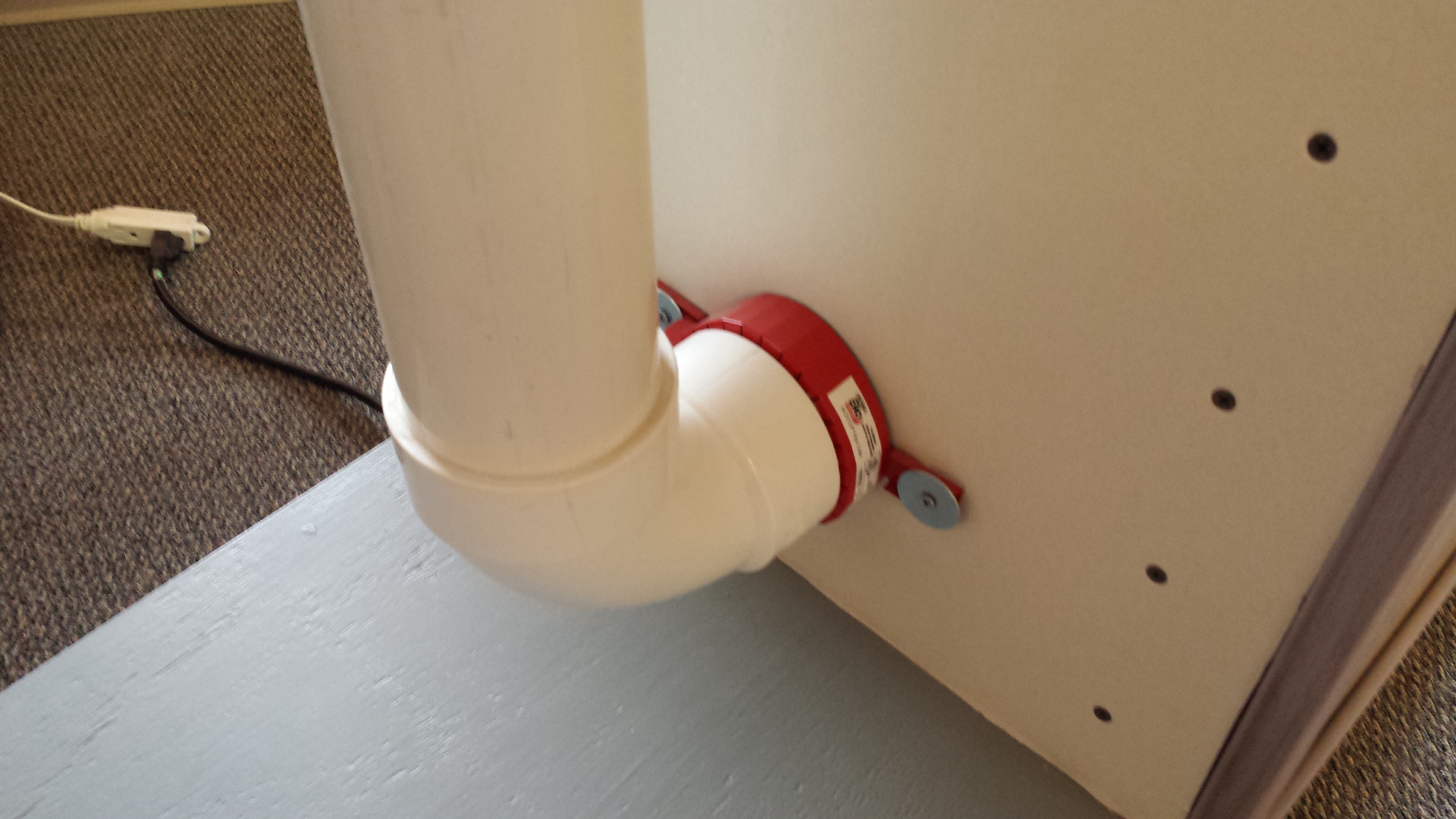

Heres a random internet photo to demonstrate such an instance.
The only requirement that the BCO wanted, on the couple of holes where these were fitted into solid walls, was to insert these into the void and cement them in. Then for the mechanical fixings ( screws / other ) afterwards ;)
Good to see that confirmed.  I'm sure I saw one that was only for use in brickwork - obviously a different beastie to this.
Yes, this was the bit that concerned me.  I suppose that at the sorts of temps required to activate the intumescent material, a semi-rigid MVHR duct should be soft enough to be squashed closed by it.

A typical installation for ceiling penetrations ( duct / light ) etc.
