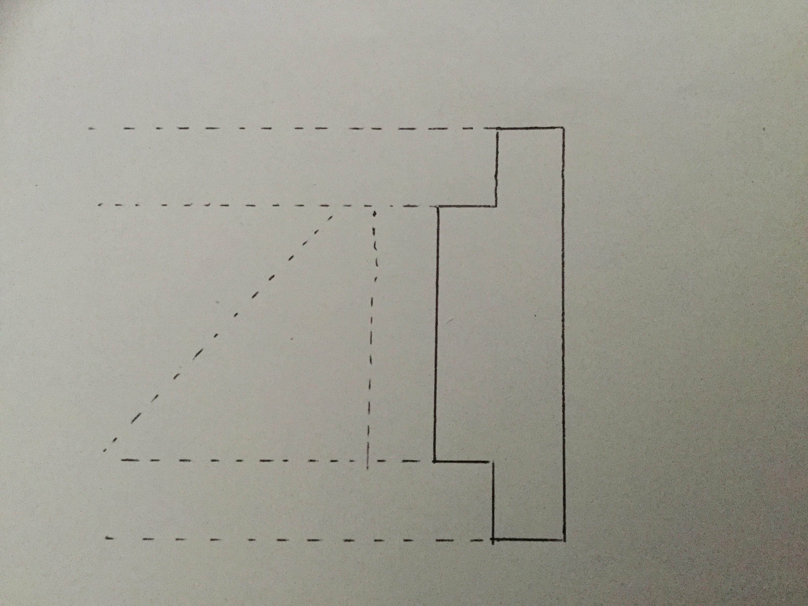

joe90 Posted November 28, 2018 Share Posted November 28, 2018 I really hope the manufacturer delivers new ones, if not I would simply extend them by cutting a block like this each end and glueing it in place, add a plywood gusset either side after fitting in joist hangers if you want belt and braces. 2 Link to comment Share on other sites More sharing options...

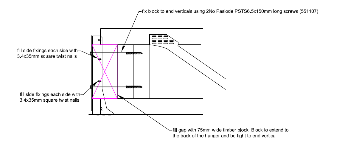

ToughButterCup Posted November 28, 2018 Author Share Posted November 28, 2018 Weeeeeeeeeeelllll now: just heard back from the manufacturers. Cullens (the joist hanger chaps) have come up with this approved solution, have a look What do you all think? What sort of timber should I use? Treated C24? Ian Link to comment Share on other sites More sharing options...
Mr Punter Posted November 28, 2018 Share Posted November 28, 2018 I don't quite get it. It looks like the screws are going through the back of the hanger. Also you would probably need to screw through the chords into the block first so it is set the right distance. Fairly odd but I am sure they know what they are doing. Link to comment Share on other sites More sharing options...
Onoff Posted November 28, 2018 Share Posted November 28, 2018 19 minutes ago, recoveringacademic said: Weeeeeeeeeeelllll now: just heard back from the manufacturers. Cullens (the joist hanger chaps) have come up with this approved solution, have a look What do you all think? What sort of timber should I use? Treated C24? Ian You've got to do it? How much are they paying YOU? Link to comment Share on other sites More sharing options...
joe90 Posted November 28, 2018 Share Posted November 28, 2018 That’s nearly what I suggested. Link to comment Share on other sites More sharing options...
Nickfromwales Posted November 28, 2018 Share Posted November 28, 2018 Do you have to do both ends equally? Link to comment Share on other sites More sharing options...
Mr Punter Posted November 28, 2018 Share Posted November 28, 2018 Yours looked a bit better as it was the full height of the joist. 1 Link to comment Share on other sites More sharing options...
Jeremy Harris Posted November 28, 2018 Share Posted November 28, 2018 Personally I prefer @joe90 's solution, with the "T" shaped infill, as structurally that it very much better, as is restrains the outwards load in the lower joist structural member. When loaded, the upper member is in tension, so wants to pull away from the wall plate, and the lower member is in compression and wants to push in towards the wall plate. Having end restraints positively stops the lower member from trying to cripple the lower edges of the hanger. 1 Link to comment Share on other sites More sharing options...

mvincentd Posted November 28, 2018 Share Posted November 28, 2018 Sorry to hear the outcome, but good that they have this suggestion for remediating the existing joists rather than entirely new ones. Like others, I too think @joe90 has a better design...to the point that i'd bet this is what they really mean but have drawn badly. Its a wholly unqualified opinion but i reckon their drawn idea won't work, but Joe's will. Good luck. Link to comment Share on other sites More sharing options...
