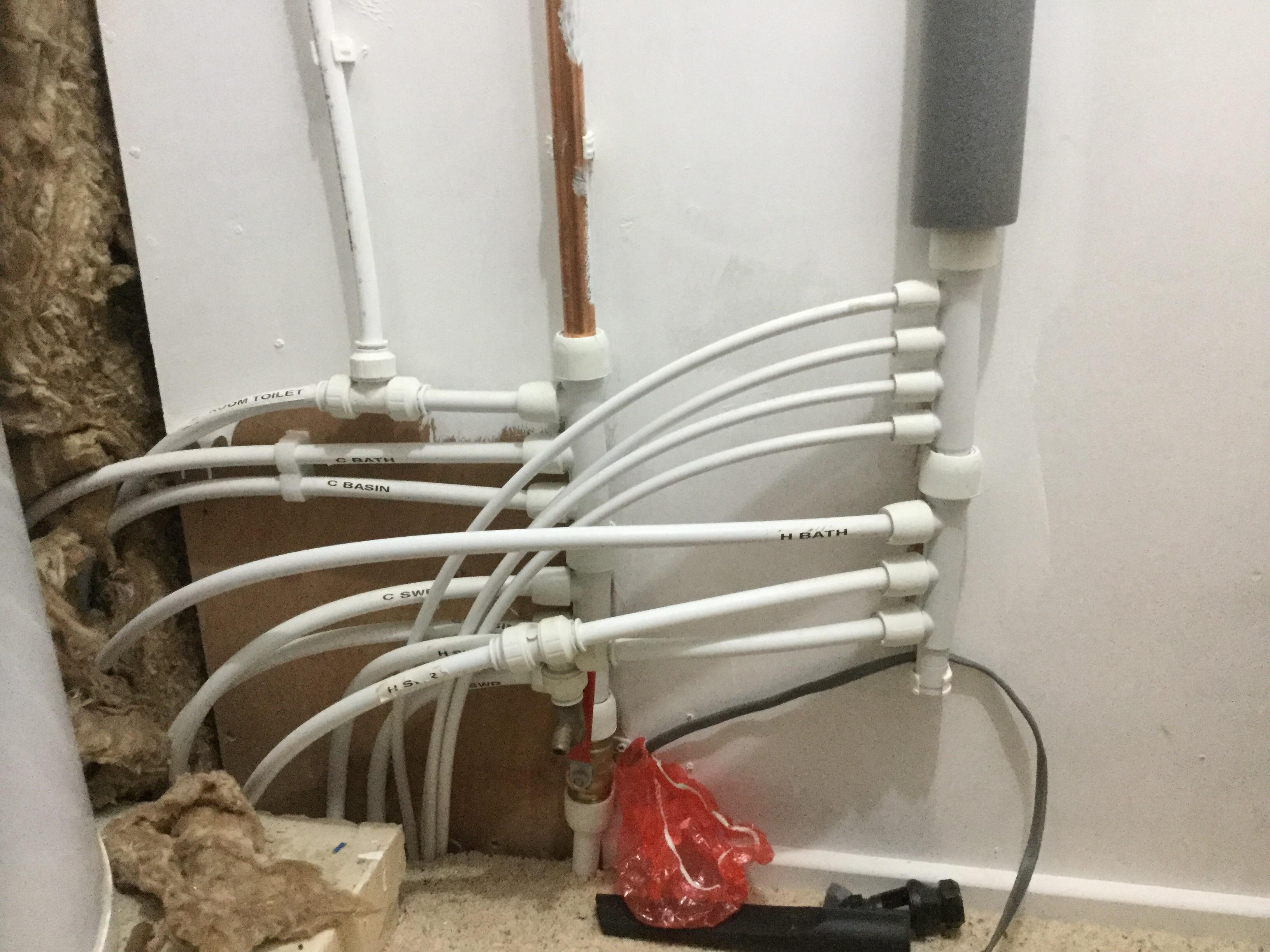

I sort of have, by using hep 20 bits, no isolation valves but good for distribution.

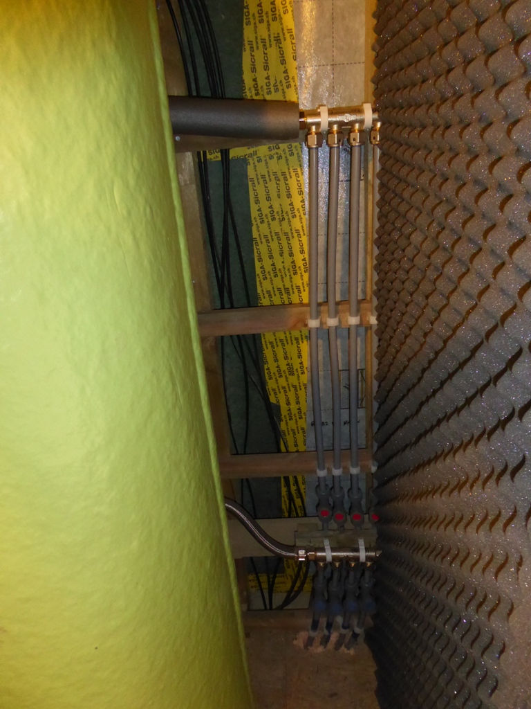

I made my own.
This is positioned above the ceiling in the utility room and will be accessed via a small "loft hatch"
The overriding objective was to enable individual isolation while piping the hot water runs as short as possible without adding extra length to any circuit.  Putting the manifold anywhere else, e.g in a cupboard would have made 1 or more hot pipe runs longer than necessary.

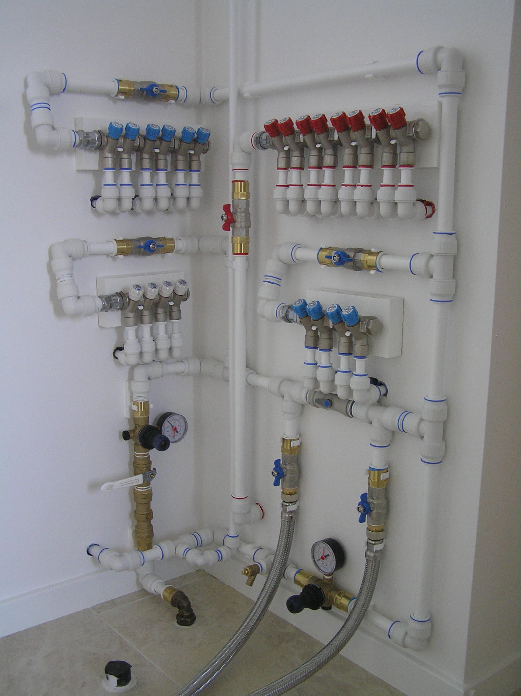

That is pretty!!! It's not at all what I had in my head, but i like it. I just imagined there would be one big pipe in (the supply from the mains), then one row of blue and another of red (hot and cold obviously) with various pipes going to outlets. Can you clarify for me please what I see here, from maybe top to bottom and left to right?

This is one taken before I insulated the pipes and when we still had the big thermal store fitted, rather than the Sunamp (hot manifold is at the top, cold at the bottom, and there are no flexi pipes on them any more, they were a temporary bodge to get water on quickly for testing):
That's essentially what it is, but because of the lack of space I had to split the cold feeds into two manifolds. There is a 25mm main coming up through the floor into a 28mm double check valve, then 22mm stop cock and pressure reducing valve. The pipe bends right, round the corner and tees off to the manifold with white taps which is hard water for drinking and toilet cisterns. The braided pipes are for the water softener which then goes through a pressure reducing valve to the Genvex Combi hot water tank and to the other two cold water manifolds. All manifolds have a ball valve to isolate them.
