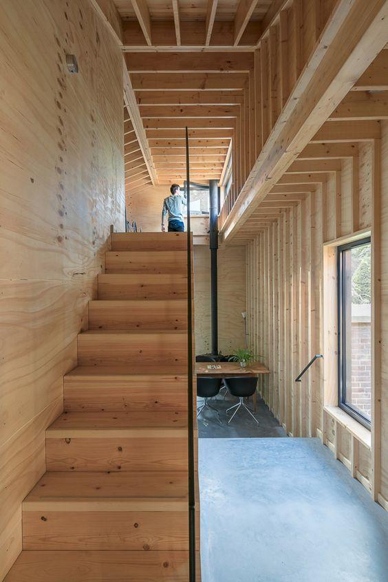

Tony C Posted November 6, 2018 Author Posted November 6, 2018 Thank you for the comment! This is not my house plan, but it is good reference, I think. 1

Ed Davies Posted November 6, 2018 Posted November 6, 2018 That'd presumably need some coating to prevent surface spread of fire? 1

Tony C Posted November 7, 2018 Author Posted November 7, 2018 CLT(cross laminated timber )was no no due to the restricted access being on the backland. As the house is single story (+ one room basement), the building control is happy without any fire instrument paint.
PeterW Posted November 7, 2018 Posted November 7, 2018 13 minutes ago, Tony C said: CLT(cross laminated timber )was no no due to the restricted access being on the backland. As the house is single story (+ one room basement), the building control is happy without any fire instrument paint. That doesn’t make sense to me ..??? CLT, Steel and posi joists are all going to be the same length no matter what you do - it’s only the depth and weight that will differ. What access do you have to the site as muck out and concrete in are your two biggest issues and if you can get a wagon in for muckaway, you can get some big bits of timber in ..!
ProDave Posted November 7, 2018 Posted November 7, 2018 11 hours ago, Tony C said: Thank you for the comment! This is not my house plan, but it is good reference, I think. That is going to be a "marmite house" and personally I would be on the "I hate it" side. It just looks un finished. I wired a house a while back where the owner wanted OSB sheeting as the finished wall. The joiners did a very good job of making the OSB very neat, but again it just screamed not finished.
Mr Punter Posted November 7, 2018 Posted November 7, 2018 14 minutes ago, Tony C said: the building control is happy without any fire instrument paint. Very odd as the regs make no mention of number of storeys in regard to Internal fire spread (linings)

Ed Davies Posted November 7, 2018 Posted November 7, 2018 Mine's single storey (plus loft space but that's not habitable) but still requires fire retardant on timber surfaces.
