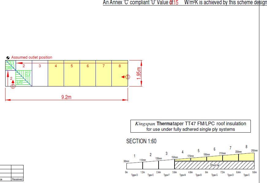

Kingspan have a standard product called ThermaTaper
And here is their quote for exactly that....
Blocks 4,5,6,7  and 8 are the ones I have been told I need to cut to shape.
So you reduce the thickness of the slab insulation and make that stepped using standard thicknesses built up - 30mm would do it I think in layers..??
Hmmm, as ever a pragmatic approach,  but how do I get a perfect gradient? I expect I'm being thick.....
Roughly chop it to profile and then use a Surform rasp ?
Anyway, why can't Kingspan just cut it for me FGS? They are cutting blocks 1,2 and 3 after all.
ThermaTaper comes in standard thickness, standard sizes.
So ThermaTaper is available in 1:60 and 1:80. You want the 1:60 stuff so that is 30/50 over 1.2m, or a 20mm rise.
So under the whole deck, you put a full flat deck of 80mm, and add your first tapered board so you have 110-130 over the width.
Now you lay another layer of 20mm across the next 1.2mm, stack the sloping one on top and you have 130-150 which now butts up to the first layer... you could just keep building with 20mm, or could be clever and buy a selection of 20/40/80 and build up from there.

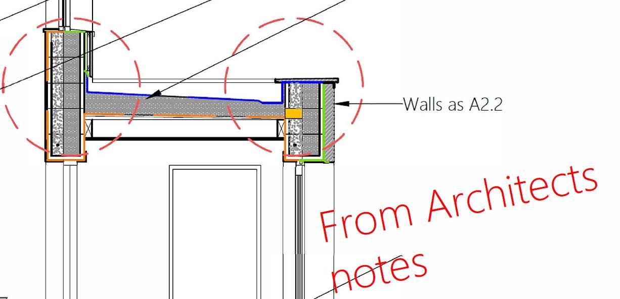

  • Do you have a section drawing of what is going on in the roof?
  • Yes: but my eyes watered at the cost of shaped insulation: and local 'advice' ? told me it could be done more cheaply.
  • Neither am I : I think it's a case of     'S Passiv'ous innit mate - load a shite that '
  • The planning conditions: the parapet has to remain where it is in terms of level. Maybe its me, maybe I take Planning Conditions too seriously: when the very local evidence is that others couldn't give a stuff and just do what they want.
  • Here you are
Thats as detailed as it gets (got).

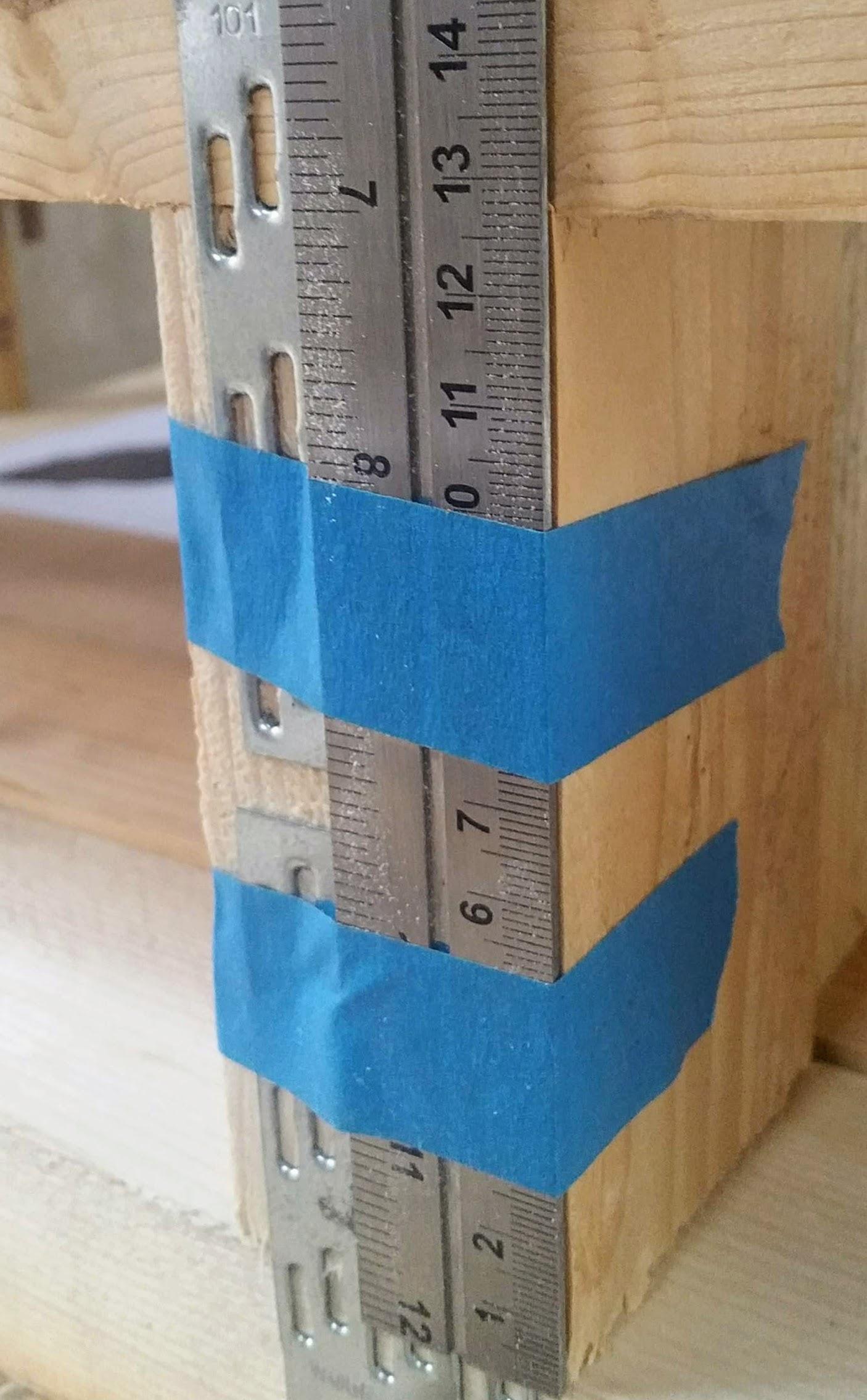

Just been out to measure the gap in the POSIs
126 ish mm.....
Originally the MVHR quote required a space of 165 between the top and bottom chord of the POSIs. Well, we've got 125ish . Rather than a Genvex which we'd set our hearts on.  Bum.
If we use this system instead, magically we can shove the pipes between the top and bottom chord and the height problem goes away . The ducting is 75mm.

Tapered insulation is more expensive for such a small amount. It's fine on a large area but not worth it for such a small quantity. Multiple ways to fix this.
  1. Was the original MVHR for rigid ducts with branches? That's not necessary. Use radial semi rigid ducts and you can still use whatever heat recovery unit you want. You can use 75mm Outer diameter which has 68mm internal diameter (I think) or you can use 96mm outer diameter which has 75mm internal diameter. The 96mm is better for longer routes. Both these will fit very comfortably in the 125mm space you have.
  2. The drawing shows the parapet capping as flat. It will either slope in or out a few degrees. If you slope it out with a nice 30 degree pitch you'll gain another 50mm height in the parapet on the inside while it stays the same outside.
  3. Build the whole parapet up - nobody will notice and I don't think I'd worry about this.
  4. Build the parapet in timber. It doesn't need to be a block parapet and building it in timber will give you more room to insulate.
Option one is by far the easiest and a potential saving on everything if you do the semi rigid radial ducts yourself which is very easy to do.
