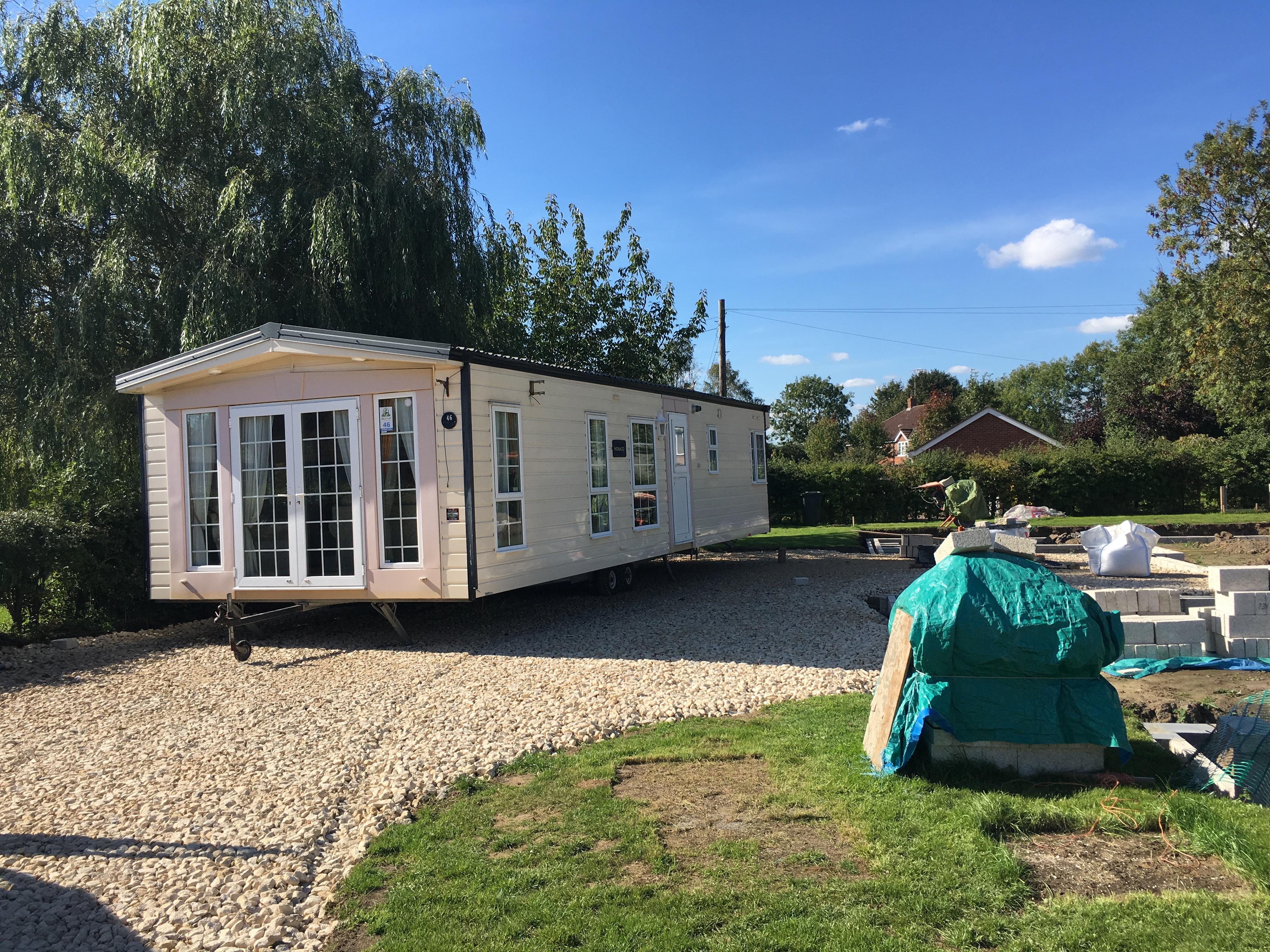

Russell griffiths Posted October 1, 2018 Share Posted October 1, 2018 Not on my bloody site there’s not as the seasons start to change I thought I would add my opinion on mud on site nope don’t want it, your trades will walk it through your new house, their van will drag it down the road, and it makes for an unhappy environment to work in. When I did the site scrape I extended it for 5-6 m in all directions from the hose footprint, I removed all topsoil and replaced it with recycled crushed hardcore and a blinding of local stone, the cost was 3 truckloads of crushed at £145 per load and 1load of stone at £165 the outcome is priceless not a drop of crud anywhere. 4 Link to comment Share on other sites More sharing options...

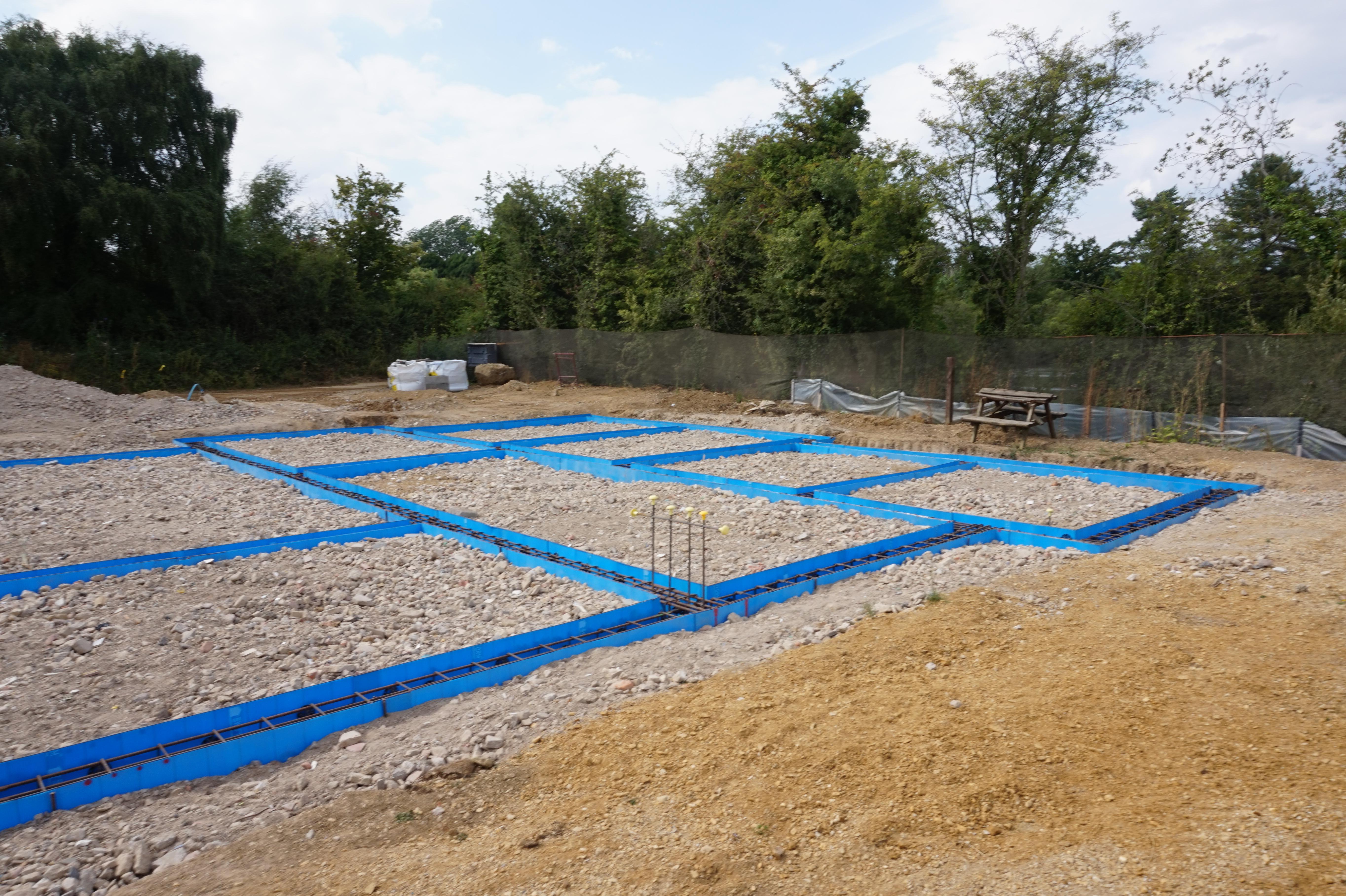

epsilonGreedy Posted October 1, 2018 Share Posted October 1, 2018 Lorries in Lincolnshire must be smaller, my three loads of hardcore only went this far. 1 Link to comment Share on other sites More sharing options...
lizzie Posted October 1, 2018 Share Posted October 1, 2018 Nice....we had a lot more than that down lost count if how many loads and we had do go down circa 1.5m over the whole site so no top soil left anywhere.......we kept topping up the hardcore must have been a foot thick by the end but the weather beat us and no matter how hard we tried mud became a fact of life through the wettest winter. Fingers crossed it remains dry and pristine, it looks lovely. Lucky you are not on clay either, vile stcky stuff. Link to comment Share on other sites More sharing options...
Ferdinand Posted October 2, 2018 Share Posted October 2, 2018 5 hours ago, Russell griffiths said: Not on my bloody site there’s not as the seasons start to change I thought I would add my opinion on mud on site nope don’t want it, your trades will walk it through your new house, their van will drag it down the road, and it makes for an unhappy environment to work in. When I did the site scrape I extended it for 5-6 m in all directions from the hose footprint, I removed all topsoil and replaced it with recycled crushed hardcore and a blinding of local stone, the cost was 3 truckloads of crushed at £145 per load and 1load of stone at £165 the outcome is priceless not a drop of crud anywhere. My previous experience with a long drive in the country says you have 3 or 4 years to build it before that all vanishes into or under a layer of mud. Long enough, I hope ! Link to comment Share on other sites More sharing options...

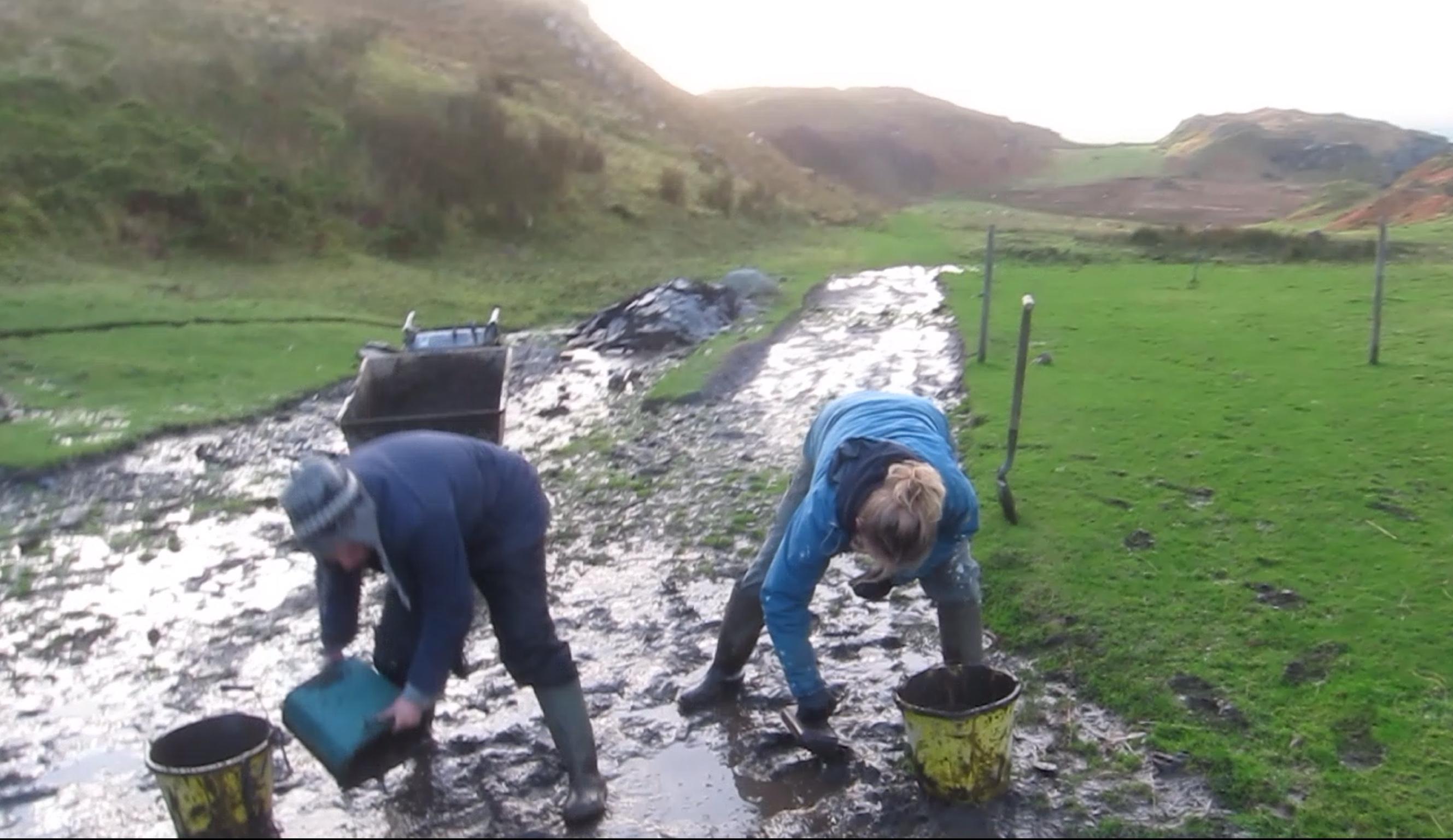

Cpd Posted October 2, 2018 Share Posted October 2, 2018 Mud...... when I first got my place it was mud hell, a few hundred years of neglected drainage and livestock using the buildings as shelter...... I did not have a digger.... but I had lots of willing helpers and we just spent a few weeks shovelling it up in buckets.... into even bigger buckets..... into a power barrow and then tipped it into a low area out the way. There were pre existing roads and hard standing but it had not seen the light of day for at leat 100 years....... once the mud was cleared the rains and lack of drainage cleared the rest and we were able to repair the hardstanding and roads. It was a great feeling when one day we realised that we were no longer traipsing mud around and could wear our boots in the house again ! 1 Link to comment Share on other sites More sharing options...

Russell griffiths Posted October 2, 2018 Author Share Posted October 2, 2018 15 minutes ago, Cpd said: Mud...... when I first got my place it was mud hell, a few hundred years of neglected drainage and livestock using the buildings as shelter...... I did not have a digger.... but I had lots of willing helpers and we just spent a few weeks shovelling it up in buckets.... into even bigger buckets..... into a power barrow and then tipped it into a low area out the way. There were pre existing roads and hard standing but it had not seen the light of day for at leat 100 years....... once the mud was cleared the rains and lack of drainage cleared the rest and we were able to repair the hardstanding and roads. It was a great feeling when one day we realised that we were no longer traipsing mud around and could wear our boots in the house again ! OMG that looks horrible, what a bloody legend dealing with that. Link to comment Share on other sites More sharing options...

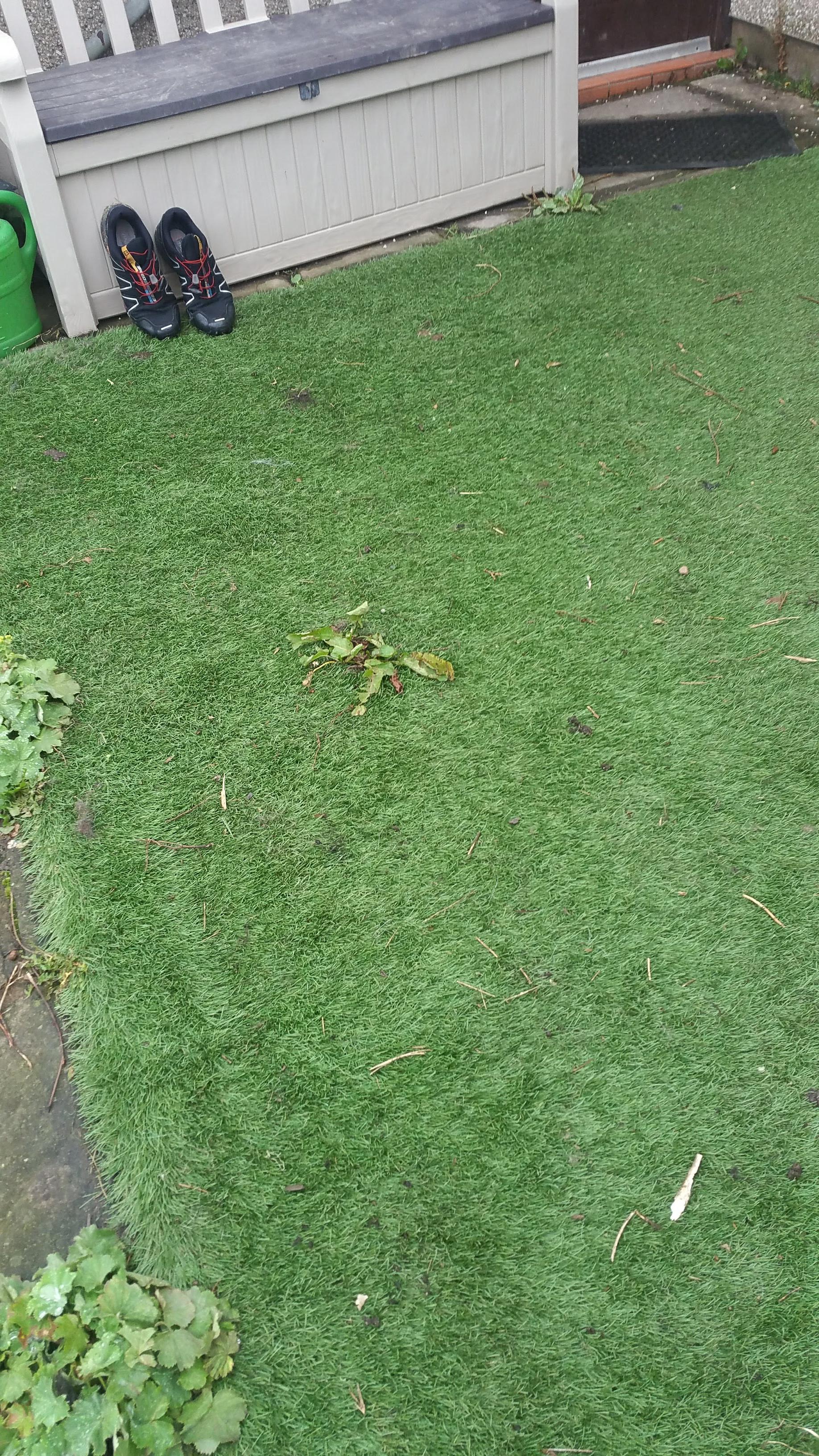

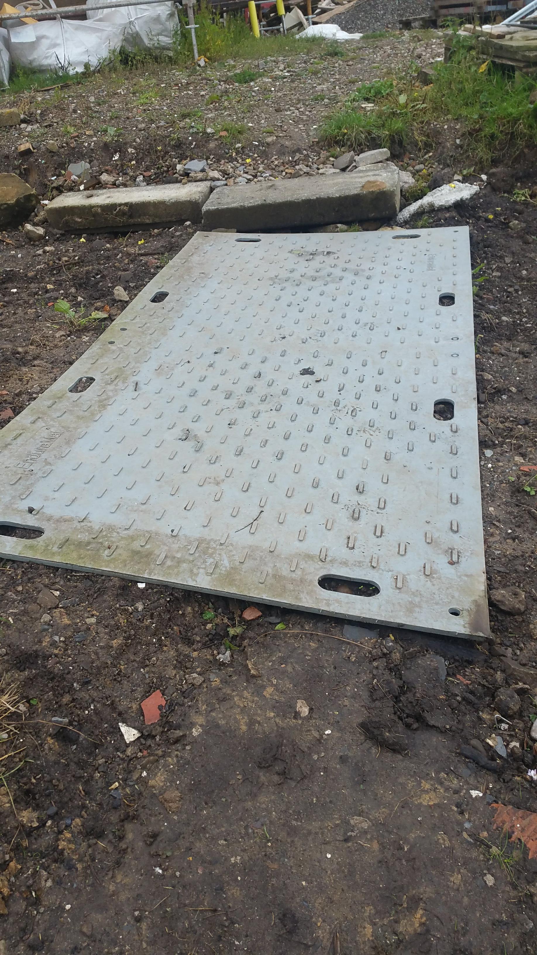

ToughButterCup Posted October 2, 2018 Share Posted October 2, 2018 Not being as well organised as @Russell griffiths, but having an inkling that mud would be a foe, this is what we did..... First, try not to get it on yer shoes in the first place I found that if I laid the mat(s) at a slight angle, the rain rinses the mat clean. An occasional brush with the same stuff we use to rinse the dog pens is perfect. Next: accept the the inevitable - so I bought a 5 meter off-cut of Astro Turf and put it down in front of the door; put a hose sprayer and brush next to the sluice..... Yes, that's a Dock leaf growing through the plastic. You can scrape your boots to your hearts content on Astro Turf. Best £50 I ever spent. Ashamed to admit I asked Rollo to mow it. ? 1 Link to comment Share on other sites More sharing options...

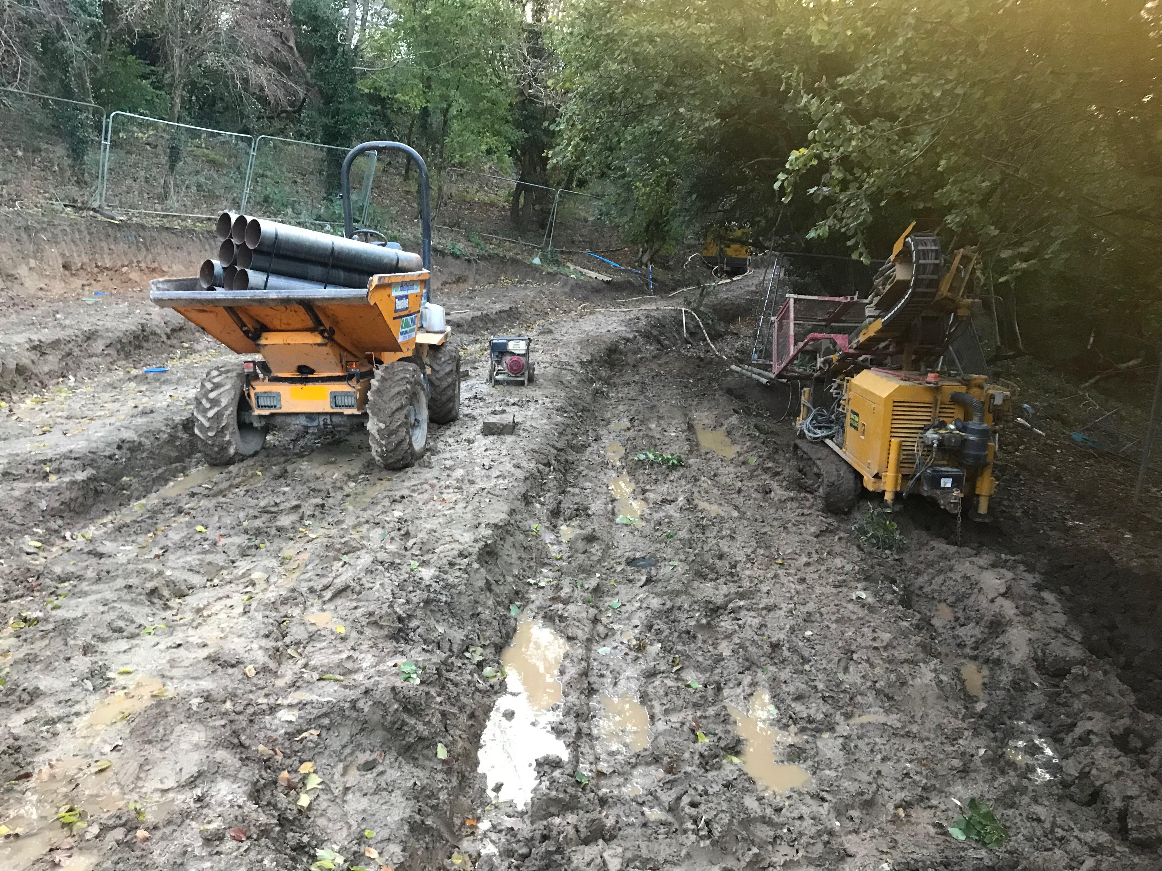

redtop Posted November 13, 2019 Share Posted November 13, 2019 an old topic, but talking of mud... Link to comment Share on other sites More sharing options...
scottishjohn Posted November 13, 2019 Share Posted November 13, 2019 at least thats one problem i will not have as its all granite -- but i think it will work out worse in the long run --could be a lot of "pecker " work for drains etc we will see -- Link to comment Share on other sites More sharing options...
redtop Posted November 13, 2019 Share Posted November 13, 2019 photo was 2 days ago, got worse since then. Groundworkers keep scraping slop and dragging the drilling machine out but its a bit of a losing battle. Think we are going to get more stone on the ground, not easy as narrow access means lorry parking 800m away and 3 t dumper doing runs up and down the hill. Oh and where the lorry would park the council are doing road works... arghh Link to comment Share on other sites More sharing options...
