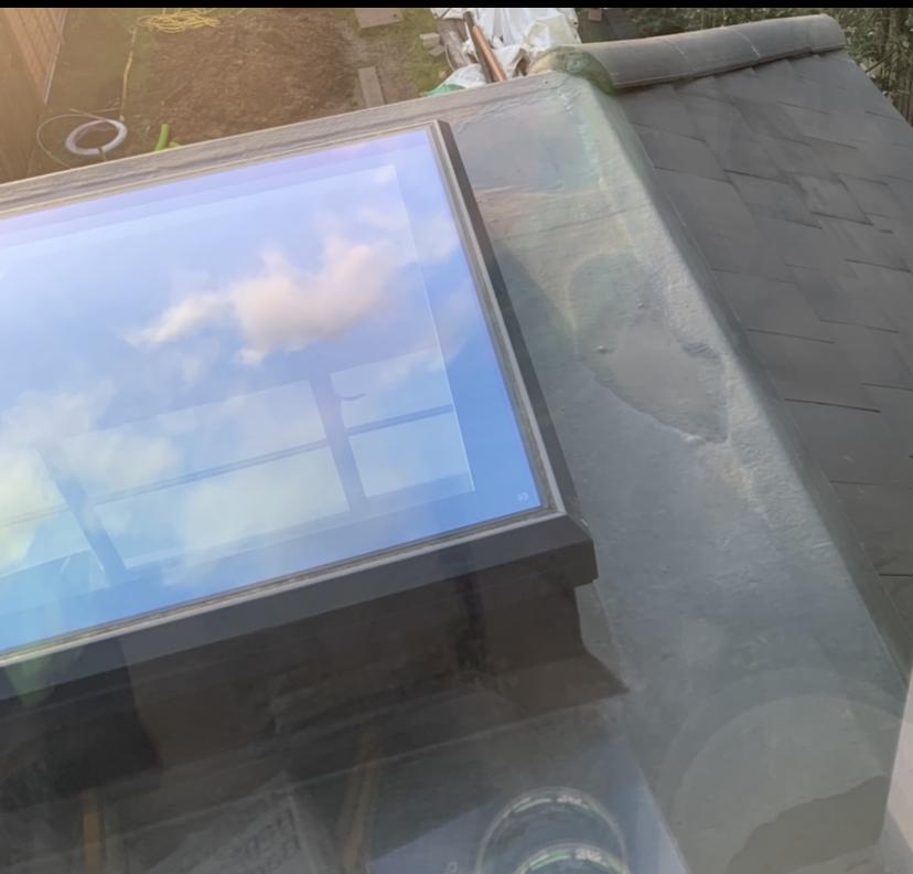

January 10, 20224 yr I discovered a very similar issue on my new first floor extension flat roof. The GRP was probably applied 2 or 3 months ago. It never occurred to me to check this ad the builder is really experienced and in the whole had been very thorough and careful (to the point that I get frustrated that things take longer than I would like). But we have pooling! The photos show either side of the rooflight: on the left of the roof light there is quite a large puddle that is about 1m in length and 20cm or 25cm in width. On the right of the rooflight, there is a much smaller puddle, maybe 15cm by 20cm. What concerned me was that these photos were taken yesterday afternoon at about 3:15pm, after a full day of sunshine (albeit the puddles would only have been in the sun for maybe 3hrs as this roof is on the west of the house and shaded by the second floor loft conversion before midday. So I sent them to a RICS surveyor who specified some other parts of the build (though not the roof, so he is independent ) and his view was that there was nothing to worry about in terms of leaks. He mentioned that this puddling can cause moss to grow which can then dislodge and block gutters, but I am trying to view it positively as just another trainee to get gutters cleaned once a year. Our build still isn’t finished, so I will raise it with my builder, but I suspect he won’t accept there are any issues. It’s a brand new GRP roof, so it should be pretty impermeable… I hope!
January 10, 20224 yr Author I always remind myself that green roofs must surely remain pretty soaked for days after any decent amount of rain?
