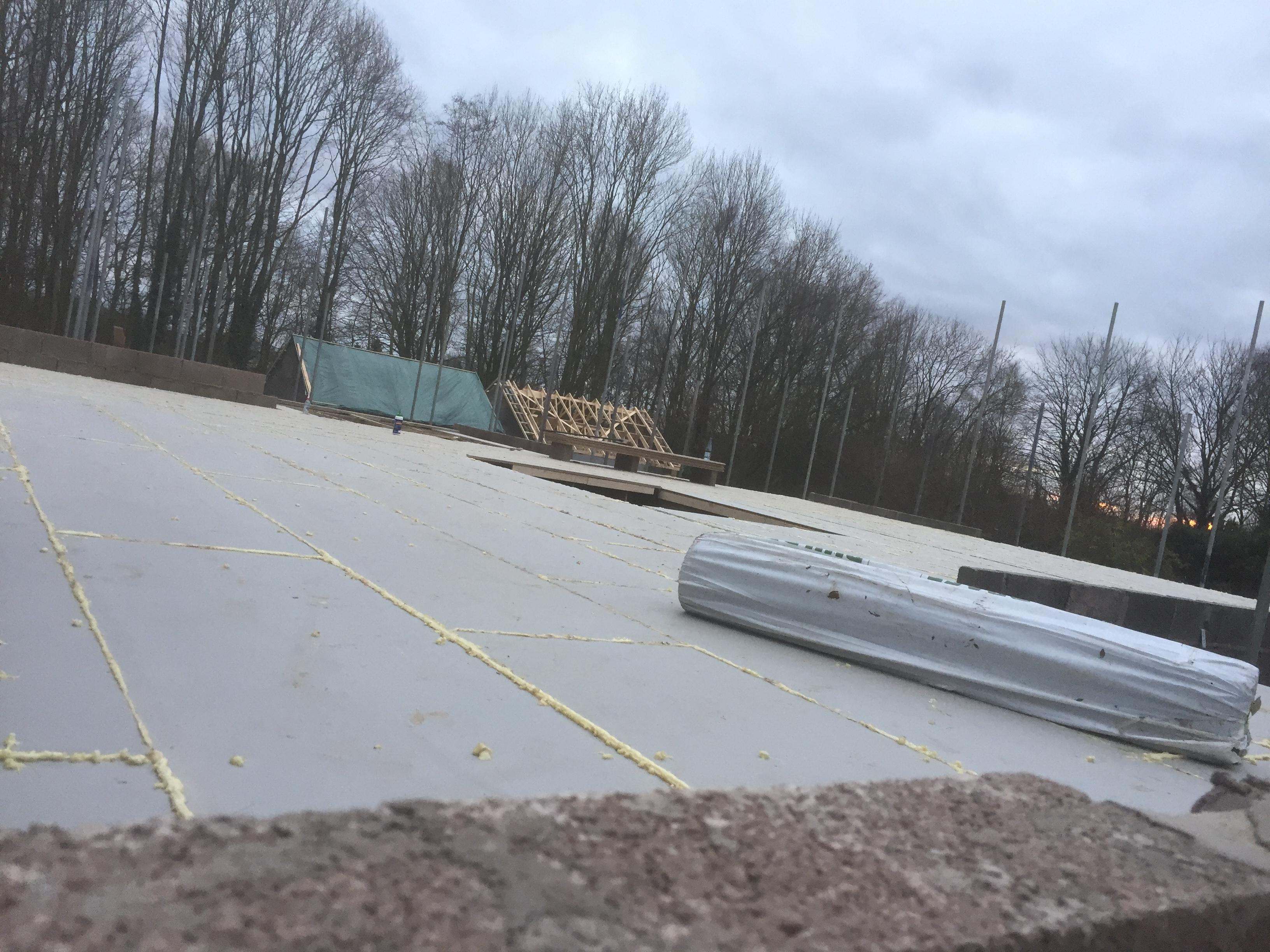

nod Posted August 30, 2018 Posted August 30, 2018 12 hours ago, Declan52 said: Just build the garage and then it can act as your storage area for all the materials you will use. Can also be an office, tea hut and maybe even a toliet area if your putting one in it. Will be a practice run for you to fine tune how your build might go. That’s exactly what we did It acted as shelter store And brew room office We put the trusses on in half a day and draged a sheet over and battened it down Boarded the front and put a temporary ply acces door on
nod Posted August 30, 2018 Posted August 30, 2018 Just now, nod said: That’s exactly what we did It acted as shelter store And brew room office We put the trusses on in half a day and draged a sheet over and battened it down Boarded the front and put a temporary ply acces door on Â

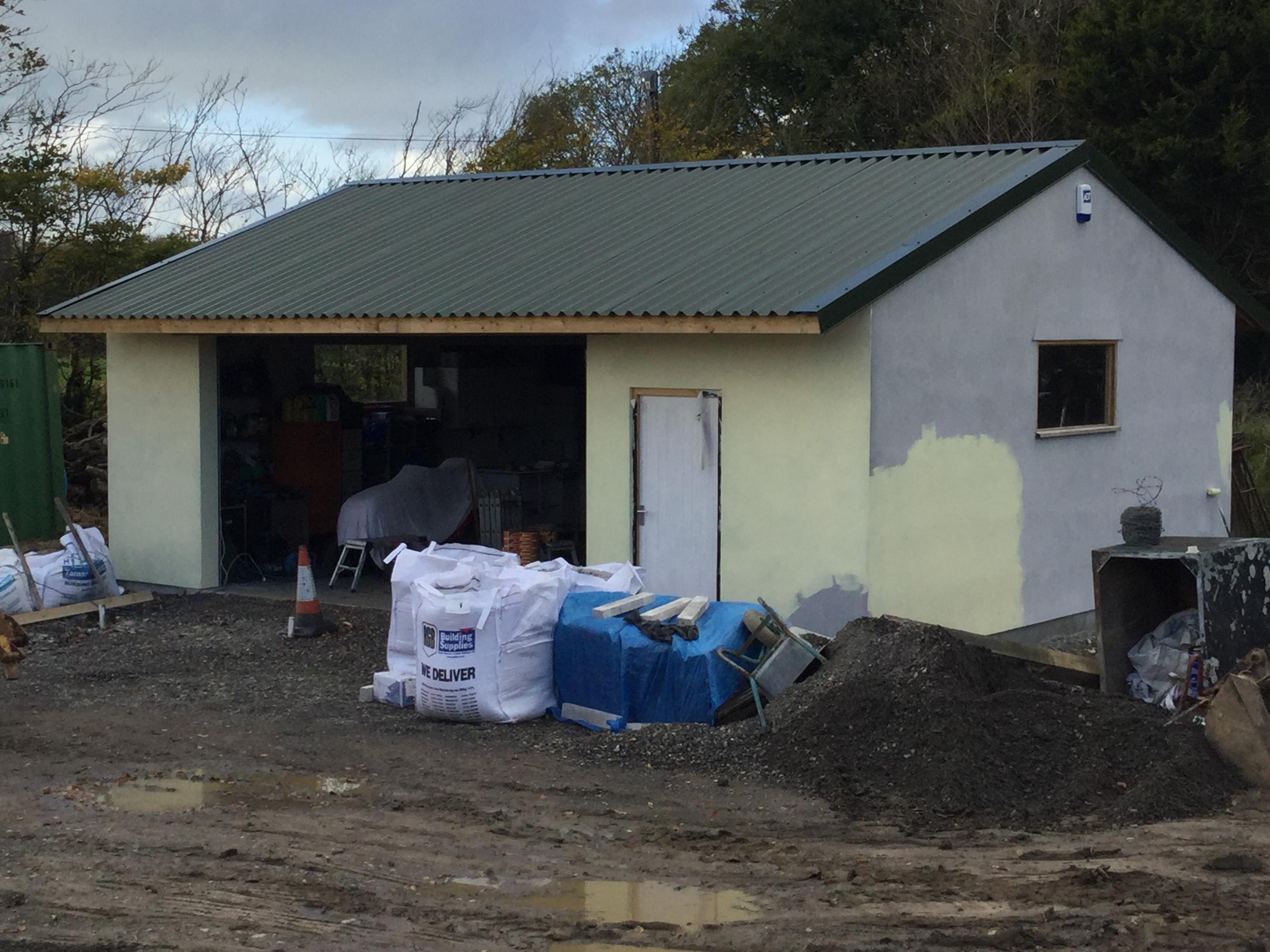

joe90 Posted August 30, 2018 Posted August 30, 2018 I built my garage first under permitted development as a building existed before we demolished (although our stroppy council fought me on that one as well). And it was something to do while i fought the council over our planning application (and won ?). It was the right thing to do as it gave me safe storage, and somewhere to work.
