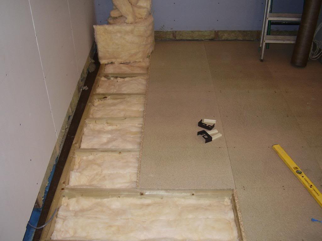

Trw144 Posted July 19, 2016 Posted July 19, 2016 (edited) Need to get my first floor flooring down this weekend as the ufh has been laid. Quick question as I need to order it asap in the morning.. Floor build up is currently joists, osb, 25mm battens with knauf insulation between, ufh spreader plates. Leaving the chipboard and final wooden floor to go on. The question is, is standard chipboard ok or are there better choices. I ve heard of weyroc mentioned - was nt sure if this was just a brand or an entirely different product. The house is watertight if that makes a difference to the answer. No rush in your answers but I need to know for the morning to get it in time! Edited July 19, 2016 by Trw144
Barney12 Posted July 19, 2016 Posted July 19, 2016 I wouldn't go with standard chipboard. I'd go for the moisture resistant stuff, standard chipboard is like a sponge. Glue the joints to prevent any later squeak and screw down well. Also I like the 22mm stuff, feels nice and solid over 18mm. http://www.jewson.co.uk/timber/sheet-materials/chipboard/flooring-chipboard/products/FH22C4TA/moisture-resistant-caberdek-chipboard-22-x-600-x-2400mm/ the only down side is its darn heavy

Trw144 Posted July 19, 2016 Author Posted July 19, 2016 18 minutes ago, Barney12 said: the only down side is its darn heavy Not too much of a worry for me as I m on holiday til next week and just have to order the stuff and arrange chippies. ? Final floor is some going to be engineered wooden flooring - I have ordered samples for when I get home. I ll ask the chippies to glue and screw the floor. I think it's 22mm but will double check my drawings. Would you suggest a 50mm screw would be about right or should I go a little longer and screw into the osb below the battens?
ProDave Posted July 19, 2016 Posted July 19, 2016 2 minutes ago, Trw144 said: Not too much of a worry for me as I m on holiday til next week and just have to order the stuff and arrange chippies. ? Final floor is some going to be engineered wooden flooring - I have ordered samples for when I get home. I ll ask the chippies to glue and screw the floor. I think it's 22mm but will double check my drawings. Would you suggest a 50mm screw would be about right or should I go a little longer and screw into the osb below the battens? I am planning something like 75mm screws, to screw the boards, batten, osb and into the actual joist, to pull the whole sandwich together to avoid squeaks.

Nickfromwales Posted July 20, 2016 Posted July 20, 2016 22mm P5 is what you need to ask for. Rock sold, and not expense enough ( compared to P4 ) to complain about. Get the guys to use PU glue and screw it down.
Trw144 Posted July 20, 2016 Author Posted July 20, 2016 (edited) Done - caberfloor p5 ordered. £7.10 a sheet. Just checked and osb sub floor was nailed - would therefore try and screw through this into the joists but as my battens run perpendicular to my joists, I m unlikely to find them again. I will have to settle for screwing through the battens into the osb. Will now get on the case of the screws and glue. Any idea on glue quantity? Screws I was going to assume 150mm centres - so 64 per 2.4 x 0.6 sheet? Is this overkill? Edited July 20, 2016 by Trw144
PeterW Posted July 20, 2016 Posted July 20, 2016 Thats a lot of screws !! What are your batten spacings..?? If its 600mm then you will get 24 at most. For 78m2 of flooring, my supplier has quoted for 13x 500ml D4 glue - thats to do the board to joist and all T&G
Trw144 Posted July 20, 2016 Author Posted July 20, 2016 400 centres - seemed a lot of screws to me for 150m2 of flooring hence I thought I would check!

Onoff Posted July 20, 2016 Posted July 20, 2016 Late to the party but I used 22mm chipboard straight onto joists at 400mm centres and the Spax flooring screws jack linked. I DIDN'T glue the joints. Floor is a solid as a rock and no squeaks whatsoever!
Trw144 Posted July 20, 2016 Author Posted July 20, 2016 (edited) What spacing on the screws? and will 60mm be sufficient. Would put me 10mm into the osb sub floor. Edited July 20, 2016 by Trw144
Onoff Posted July 20, 2016 Posted July 20, 2016 1 hour ago, Trw144 said: What spacing on the screws? and will 60mm be sufficient. Would put me 10mm into the osb sub floor. D'you mean me? I "lined" our old step down into, boot room / coal shed type thing. BEFORE I had ever heard of eBuild etc. I brought the floor up in mass concrete (no UFH! ) then made a "stud" wall o/of 4"x2" laid it on the concrete floor sitting on slivers of ply packed to suit and glued. Just 4" of fluffy stuff then 22mm chip. Looks to be about 300mm ctrs on the screws? Solider than a solid thing I kid you not and not a squeak from it. Like walking on a concrete floor tbh. From memory the floor was all through housed and glued /screwed too & not a nail in sight. Angular ring nails are the spawn of the Devil. (AND.....it's as clean under the floor as it is on top.....just 'effin COLD! )
Onoff Posted July 20, 2016 Posted July 20, 2016 Just now, Onoff said: D'you mean me? I "lined" our old step down into, boot room / coal shed type thing. BEFORE I had ever heard of eBuild etc. I brought the floor up in mass concrete (no UFH! ) then made a "stud" wall o/of 4"x2" laid it on the concrete floor sitting on slivers of ply packed to suit and glued. Just 4" of fluffy stuff then 22mm chip. Looks to be about 300mm ctrs on the screws? Solider than a solid thing I kid you not and not a squeak from it. Like walking on a concrete floor tbh. From memory the floor was all through housed and glued /screwed too & not a nail in sight. Angular ring nails are the spawn of the Devil. (AND.....it's as clean under the floor as it is on top.....just 'effin COLD! ) EDIT: Those SPAX flooring screws are the best thing ever. Very clever design the way they work too.
Trw144 Posted July 20, 2016 Author Posted July 20, 2016 (edited) Yes, sorry, should have addressed the message. I m going to go with 300mm centres on the screws so about 30 per board, plus glue to battens and joints. 60mm putting me 13 mm into the osb. Let's see if screwfix have 3000 in stock..... Edited July 20, 2016 by Trw144
