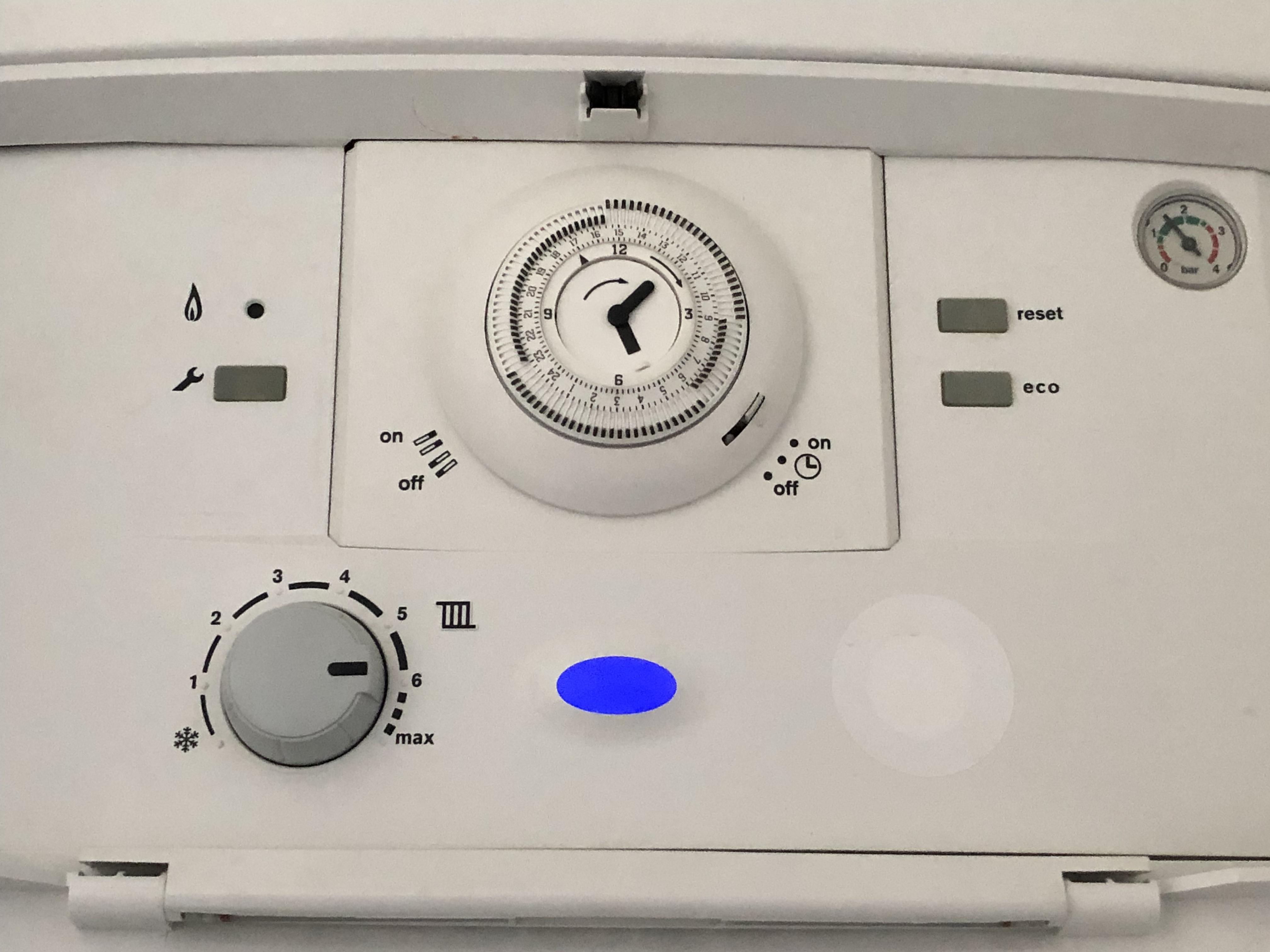

newhome Posted August 13, 2018 Posted August 13, 2018 Seems like plumbing issues follow me around ?. Have arrived to see my mother who says her hot water stopped working yesterday and the ‘light was flashing’ apparently so she pressed reset but still no hot water. Called out her normal handyman and he repressurised it but still no hot water and says she needs a plumber. Normal plumber is on holiday. Is it definitely a job for a plumber or can I fiddle with it? Boiling kettles to wash sounds like a joy! ?
Carrerahill Posted August 13, 2018 Posted August 13, 2018 (edited) Not necessarily a plumber only job - could just need reset for example. Why did it stop working is the question - it may just have gone into lock-out. The light on these will usually flash a sequence or colour to indicate the fault and display a letter or number in the temp gauge like F1 or something. I have seen this boilers bigger brother go into lockout for a low pressure issue - cycling the main power with a 30 second pause sorted it, other issues can be high pressure, over temp, flue issues etc. If the manual is in the front panel then the faults should be listed. Edited August 13, 2018 by Carrerahill 1
Nickfromwales Posted August 13, 2018 Posted August 13, 2018 (edited) Does central heating work ? If so that eliminates; fan gas valve air switch and part eliminates the PCB. If no central heating and no hot water then first check is; does the fan spin and blow air out of the flue? Remeber you'll have to reset the boiler every time to check operation and as it is a stinking WB you'll have to wait a long time for it to do self-diagnostic each time. Give me a Baxi or a Vaillant any day. Edited August 13, 2018 by Nickfromwales Edited to make sense. Eating my ham and cheese roll whilst typing and the roll has priority. 1
Alexphd1 Posted August 13, 2018 Posted August 13, 2018 Does the jnr have a self diagnostic every time you reset or switch off/on power?
newhome Posted August 13, 2018 Author Posted August 13, 2018 Thanks all. Doesn’t look like the CH works either. I’ve switched the clock thing to on then I powered it off, switched it back on, all the lights come on, then go off apart from the blue one. After a while the blue light starts flashing fast and that’s where it stays. All other lights are off. Gas hob works fine.
newhome Posted August 13, 2018 Author Posted August 13, 2018 38 minutes ago, Alexphd1 said: Does the jnr have a self diagnostic every time you reset or switch off/on power? Sounds like it does something. Not sure what.
newhome Posted August 13, 2018 Author Posted August 13, 2018 3 minutes ago, PeterW said: Assume you’ve tried the reset button ..?? Lol yes, several times. Same result. All lights come on, everything goes out except the blue one and eventually blue light fast flashes after 20 - 30 seconds.
AliMcLeod Posted August 13, 2018 Posted August 13, 2018 Does the light beside the flame symbol ever come on? That indicates the gas burner is on (I have a larger WB Greenstar boiler - beefier version of this). When you turn the timer so it should switch on, does it do anything to suggest its coming to life? Any noises? The spanner button is the service button but my user manual does not give any instructions for that - it must be in the secret manual only gas accredited folks get. 1
AliMcLeod Posted August 13, 2018 Posted August 13, 2018 (edited) This is what the manual for the boiler says: In the event of a fault, the reset button will flash once per second and the blue mains indicator light will flash. 1. To reset the boiler press the reset button for approximately five seconds. When the boiler resets the reset button will no longer be illuminated. 2. The mains indicator will no longer be flashing. If the fault remains and cannot be cleared by pressing the reset button, contact Worcester, Bosch Group for assistance. Unless one of the experts here can think of something, I fear a service call might be required. There's a few YouTube videos with the same problem too. Here's one: Google "greenstar 24i flashing blue" to see more. Edited August 13, 2018 by AliMcLeod 1
newhome Posted August 13, 2018 Author Posted August 13, 2018 The light by the flame only comes on when the boiler resets and all lights come on. Other than that it’s off as are all the lights apart from the blue one. The reset button doesn’t flash indicating that a reset is required. I checked under the stairs that she hadn’t knocked the gas off but that looks ok. I think I’m out of ideas tbh. Plumber supposed to be ringing back .... Driven 400 miles, sitting in a cupboard, no hot water. I’m a bloody jinx! ?
newhome Posted August 13, 2018 Author Posted August 13, 2018 There is a magnafilter thingy but I haven’t touched that. Water hardness circa 230 here I found out yesterday.

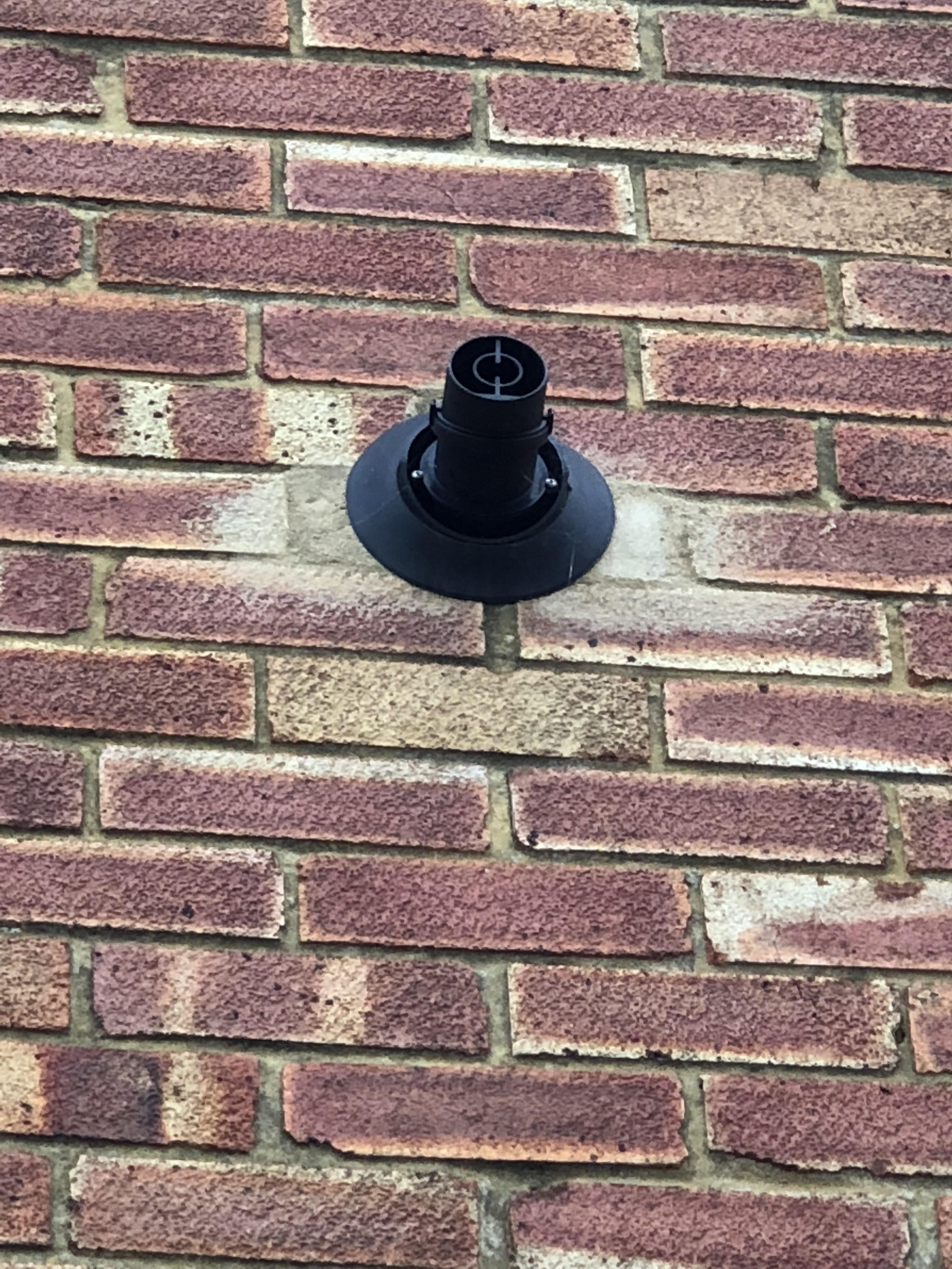

newhome Posted August 16, 2018 Author Posted August 16, 2018 Thanks all. Plumber said that it was full of water probably from water getting into the flue as ‘we’ve had a lot of rain recently’. Have we? There was a tiny tiny bit of water in it but we struggled to see it TBH. Anyway it was my brother’s friend who fitted it but he’s on holiday so another one of his friend’s is going to look tomorrow. If it needs a new boiler then sobeit but it definitely feels worth getting a second opinion.
newhome Posted August 16, 2018 Author Posted August 16, 2018 Oh and his advert said no callout charge! PMSL!
PeterW Posted August 16, 2018 Posted August 16, 2018 If the flue fills with water it drains out of the condensate pipe ... it’s designed to do that ... 2
