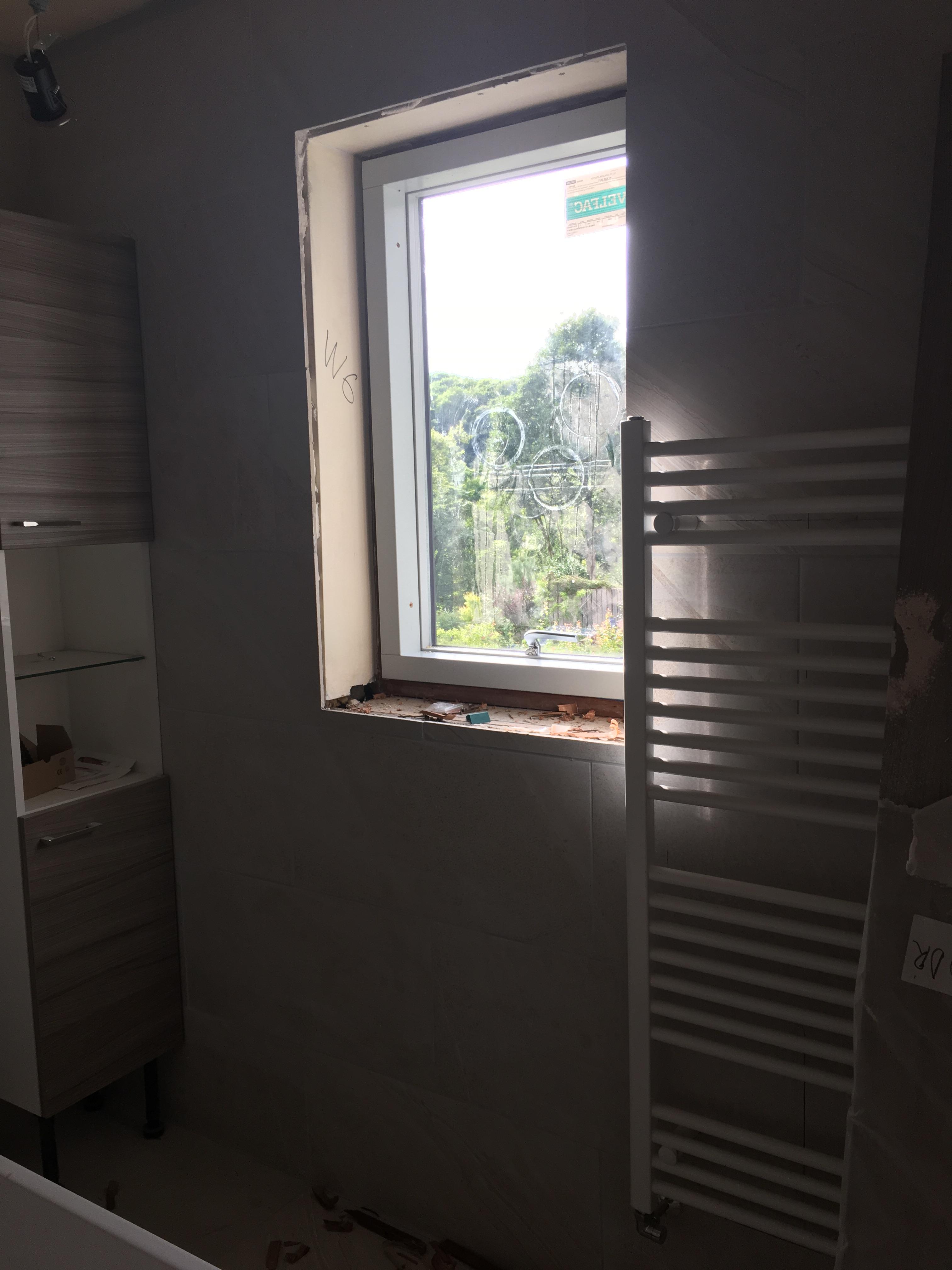

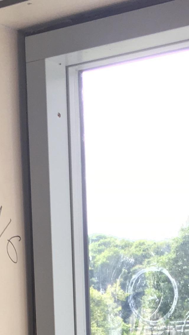

Hi looking for a bit of advice /feedback.  We are renovating a house and work with a project manager.  We selected new windows for our house and they have just been delivered.  Aluminium on the outside and wood on the inside.  I have just been down to see how things are progressing as they are being fitted today and have found that the window fitters (not employed by the window company but hired separately by project manager) and they appear to be screwing the windows into the opening leaving huge holes in the frame which I am being told will be filled and painted over.  It looks awful and I am so shocked it has been done this way.  Came home to where we are living at the moment and have a similar set up and cant see a single screw hole in site on the windows.  Can anyone tell by looking at the photo if this was the only way this could have been done.  Please don't mention that fact that there is a clear glass window in a bathroom (that is another conversation).  TIA for your replies,

This is in my opinion incorrect for this type of window.
They should fit a plate or heavy builders band to the side of the windows, i.e. the side that is hard against the wall, the plate/band sits back about an inch or two into the room, you then offer the window up and then screw the plate/band to the window aperture. This also means when it comes to removing them in the future someone doesn't need to dig out filler.
Alternatively, can the glazing be removed from these or are they factory fitted and made up? On standard UPVC units you can pop the beads, remove the glass and screw the frame in with the screws then hidden when you refit the glass - likewise with opening windows, you can often screw through the frame and the screws are only visible when the window is open which is not an issue as the open frames of windows are full of latches and levers and screws anyway so another screw won't detract.
Another thing, are the windows in final paint? Or is that just a primer? If that is the finished paint then I would also not be pleased at some monkey rubbing a bit of filler into the holes and trying to match the exact colour and finish which from the image looks to be a sprayed finish, possibly a polyurethane paint which will have excellent durability and a bit of Dulux brilliant white will not look the same ever.
I would NOT accept this and would have the installer replace the windows (at their cost) that they have butchered. It is just a total lack of thought.

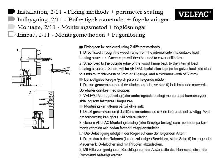

Looking at that Velfac installation document linked to above there are 2 ways to fix the windows, and option 1 appears to be through the frame.

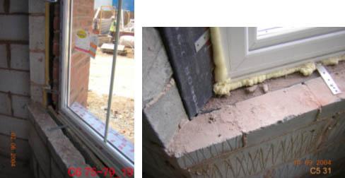

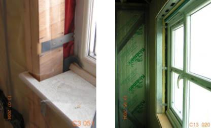

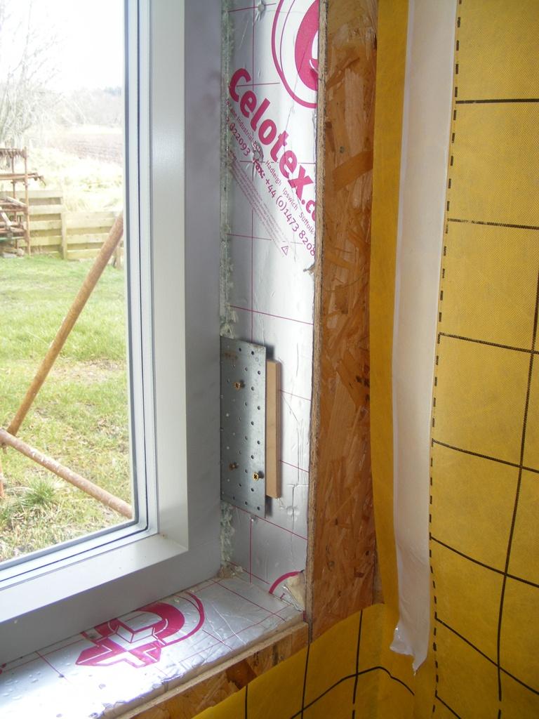

This is how my very similar Rationel Ali clad timber windows are fitted:
Fixing plates clearly visible.  Print that picture and give it to your muppet project manager, along with the question of how does he propose to correct the holes he has butchered in your windows, at his expense.

Can't see the fitters taking the blame as they have followed the installation detail from Velfac. I think it's a shame that Velfac find it an acceptable method, or should at least say brackets/straps should be used unless there is good reason to screw through the frames :(
