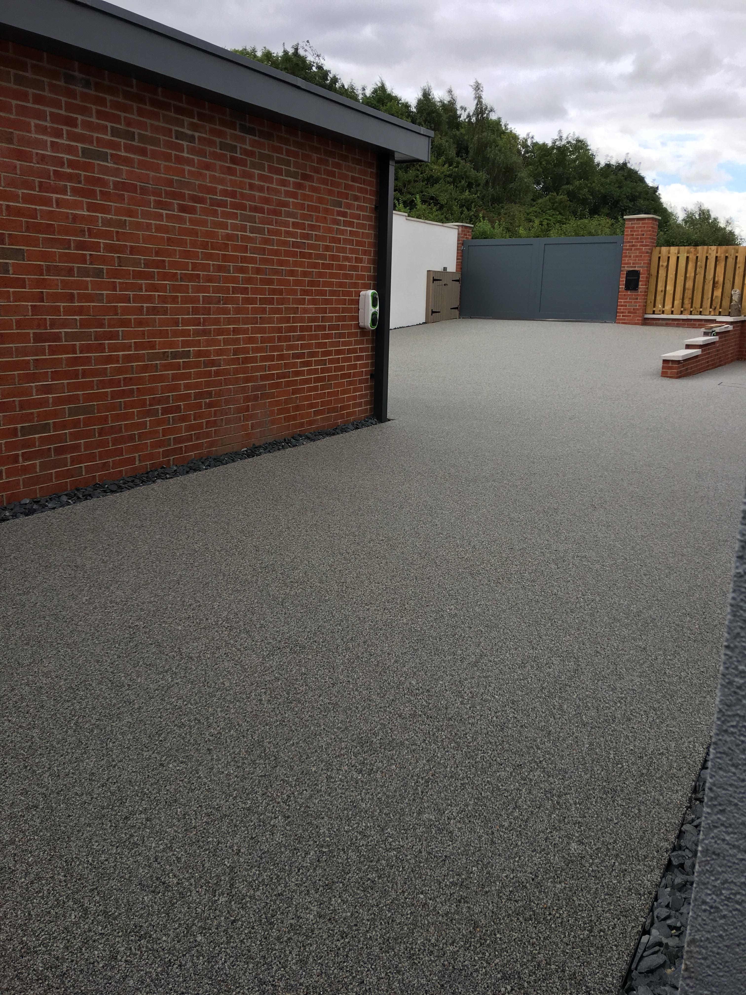

PeterW Posted July 29, 2018 Share Posted July 29, 2018 Is it resin bonded or resin bound ..?? I didn’t know there was a difference til I checked ..!! Link to comment Share on other sites More sharing options...
Redoctober Posted July 29, 2018 Share Posted July 29, 2018 I believe one is permeable and the other isn't. One is cheaper than the other and it depends on whether or not the area being laid requires a SUDS appropriate product. Link to comment Share on other sites More sharing options...
Hecateh Posted July 29, 2018 Share Posted July 29, 2018 (edited) They are both permeable. Resin bound is mixed with the stone and then poured and is more expensive and longer lasting Resin bond, the resin is poured first and the stones are scattered on top. Edited July 29, 2018 by Hecateh Link to comment Share on other sites More sharing options...
lizzie Posted July 29, 2018 Author Share Posted July 29, 2018 Its resin bound....25 year guarantee LOL...installer has been in business doing driveways for over 20 years (Obvs not resin that long as its hadn't been invented!). Its an insurance backed guarantee so should be worth the paper. I wouldn't go for the cheaper version they just scatter aggregate on top of resin and it comes loose and wears off. Its all permeable SUDS compliant and UV stable so its wont yellow. Link to comment Share on other sites More sharing options...
Bitpipe Posted July 29, 2018 Share Posted July 29, 2018 Had this done in Jan and it still looks amazing, if a little grubby (need to get the pressure washer out). What substrate are they using? My landscaper laid a block boundary (haunched with concrete at rear) and laid about 100-150mm of type 1 and scalpings, compacted in layers. Resin contractor laid 50mm porous tarmac day one and then 20mm of resin bound gravel. The resin laying was continuous to avoid any joins. They used a custom circular mixer that looked like a candyfloss machine vs a bell cement mixer - the gavel mix, sand and two part resin were added in batches, mixed and then dropped into a barrow below before being trowelled into place. They sprinkled ground glass on the top to give a little sparkle and additional grip. As it was Jan, took a day or so to set hard - we couldn't walk on it at all for 24-36 hours. Good luck! 1 Link to comment Share on other sites More sharing options...
lizzie Posted July 29, 2018 Author Share Posted July 29, 2018 (edited) Thank you @Bitpipe good to hear a review a few months on. I have steel edging haunched in (contains slate chips over drainage around slab) and my tarmac contractors did the base when they did our road It was done to spec resin people wanted so all resin lot have to do is a one day lay....its a lot of sqm though! I'm getting the additional grip treatment too. He said no walking on it for a day and 3-4 days for vehicles. Got any pics of yours? Edited July 29, 2018 by lizzie Link to comment Share on other sites More sharing options...
Redoctober Posted July 29, 2018 Share Posted July 29, 2018 1 hour ago, Hecateh said: They are both permeable. Resin bound is mixed with the stone and then poured and is more expensive and longer lasting Resin bond, the resin is poured first and the stones are scattered on top. Just a quick inter web search - Resin bound surfacing – Stone blend Resin bound surfaces are created by mixing together aggregates with the resin itself. The completed mixture is then poured onto the base surface, where it is spread and finished with trowels to leave behind a smooth, flat and consistent surface that is water-permeable and slip resistant. Resin bonded surfacing – Stone top Also known as the scatter method, resin bonded surfacing is achieved by first applying and spreading a resin mix to the base layer, and then applying the aggregates on top the resin. The scattered aggregates are left to bond with the resin, leaving behind a rougher textured surface that is impermeable to water. Once cured, any loose aggregates which have failed to bond are swept away and removed, to ensure that no loose stones are leftover on the newly finished surface. Main differences As you can see from the descriptions above, the main differences between the two techniques come from the method of application, as well as the resulting surface properties. Resin bound surfacing is water-permeable, while resin bonded surfacing is impermeable. This key difference makes each method suitable for a range of different applications. 1 Link to comment Share on other sites More sharing options...
Gone West Posted July 30, 2018 Share Posted July 30, 2018 We had a resin bound entrance to our drive laid about two and a half years ago. They laid 200mm type 1 then 70mm porous asphalt and a 20mm layer of resin bound. The asphalt has to be left for a minimum of seven days for the oils to come out before the resin bound can be laid. After about a year we had a problem with a small area of the resin bound lifting. They came out and removed the faulty area and relaid. It's been ok since. As it's expensive I am going to cover the rest of the drive with resin bonded to match and I'm hoping to do it myself. Resin bonded is fine for a driveway but scattering onto hot bitumen, a cheaper alternative, doesn't tend to last very long with the chippings coming off. Link to comment Share on other sites More sharing options...
lizzie Posted August 3, 2018 Author Share Posted August 3, 2018 Resin all done in a morning 6 of them laid 160sqm by lunchtime. Its looks amazing, cant do a close inspection as cant walk on it just yet but from where I can see it looks the bees knees. Very pleased. 6 Link to comment Share on other sites More sharing options...

lizzie Posted October 4, 2018 Author Share Posted October 4, 2018 I thought I would update you all on our driveway.......the drive itself is still looking good (keeping everything crossed) however the installers caused a lot of damage to our gates (brand new powder coated aluminium gates ££££'s). The damage was not apparent for a few days as we couldn't walk on the drive. They had spilt resin on the gates (some aggrrgate stuck to it too) and then tried to get it off resulting in great smears of stone and resin all over the gates, its a real mess. Installer brought his own expert to look at it they said it couldn't be removed without damage to the powder coating the only option was gates off and taken away to be completely redone as the resin smears are spread over both sides of both gates its not just one small patch. Installer said get the quote and I will sort it out its my mistake etc etc. You know where I am heading now don't you.......quote at £995 plus vat for rectification and installer disappeared off the face of the earth. This is supposedly a well established family firm from Worcester.........next stop trading standards and local press I think, after 2 years of hell building this house and being ripped off left right and centre this is the last straw. I don't want to be slipping down the rankings for the most cowboys on one build do I! 5 Link to comment Share on other sites More sharing options...
