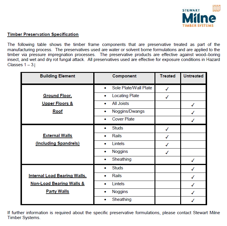

Mr Punter Posted June 8, 2019 Posted June 8, 2019 The JJI type joists are untreated as standard with treatment as an option. If you are using timber frame, as standard the the roof structure is untreated and the rest is as per
