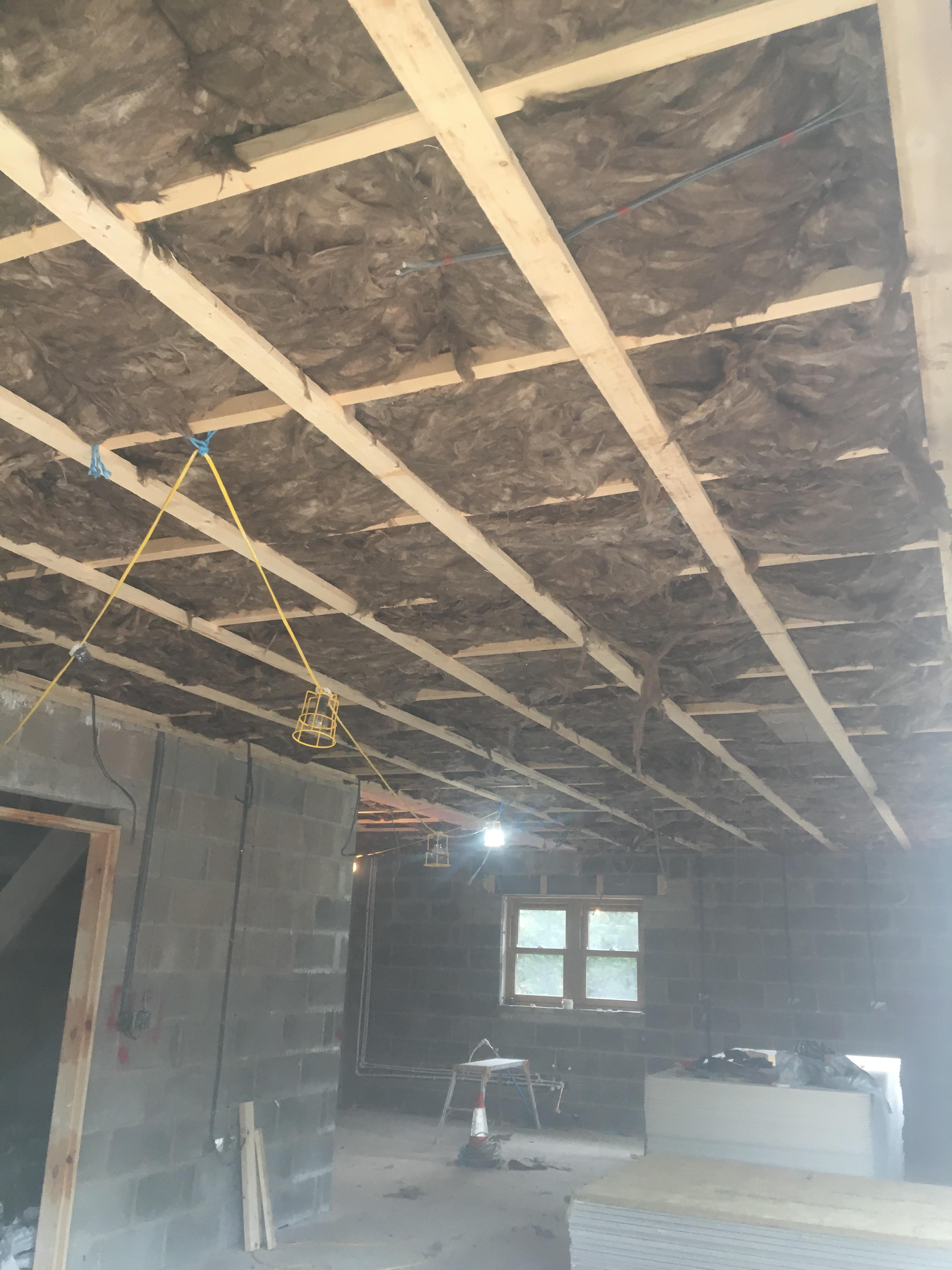

nod Posted July 24, 2018 Share Posted July 24, 2018 3 hours ago, recoveringacademic said: Reading this thread and all the dire warnings written there sent me scurrying off into Tinternet to look and see what I can find. Well, the only method of fixing them I haven't found was by using bubblegum. There's oodles of guidance and I have read a good deal of it. MiTek say that the fixing method rests with the designer. So I had a little phone chat with two or three companies and they all said that 'we' could discuss how I wanted them to be fixed. And anyone who knows me, knows that that is going to be a one-sided conversation. So, come on BH, help me out here. help make me sound as if I know just a leeeetle bit about metal web joists rather than sound more of a complete plonker than I already am. I know what to avoid: floor bounce - because of @readiescards 's thread (thanks) not installing them back to front (PeterW here ) [What the Hell is back to front on a POSI fgs?] make sure the trimmer is correctly seated (Jamie same thread) make sure the chords of the joists (flange, web ?) are wide enough (Peter Stark same thread) use 400 centers (already knew that - by accident) make sure the bottom chord is supported correctly (PetereW same thread) AlexPHD (same thread ) tightly pack between the bottom chord and the wall (what with Alex?) Peter Starks are hung from the top chord on a ledger plate (Whassat fgs ?) and he uses a strong back (should I consider one?) PeterW's helpfully annotated image of where the problem lies (same thread) @JSHarris seems to argue against hangers (same thread) Try pre-cambering a little bit ( @JSHarris same thread) @CC45 has strengthened his POSIs (same thread) That's a good start.... Do people use hangers because they are easy, and becuase they are easy to use, they don't pay attention to detail (present company excepted)? My spec is for the POSIs to be hung on a wall plate (rim joist) Knowing all of the above, how would you make sure the problem didn't occur in the first place? Counter battening makes a massive difference An afternoons work and £100 1 Link to comment Share on other sites More sharing options...
CC45 Posted July 24, 2018 Share Posted July 24, 2018 @nod- like additional strongbacks - could be worth putting these in as joists get installed - if possible. I've added extra screws to all my strongbacks and it did make a difference. Link to comment Share on other sites More sharing options...
ToughButterCup Posted July 25, 2018 Author Share Posted July 25, 2018 9 hours ago, CC45 said: @nod- like additional strongbacks - could be worth putting these in as joists get installed - if possible. I've added extra screws to all my strongbacks and it did make a difference. Strongbacks: my design doesn't require them, and battening and counter battening hasn't been mentioned up to now. Is this (are they) something I can choose to add? - I'm thinking of my BR submission here. Link to comment Share on other sites More sharing options...
PeterW Posted July 25, 2018 Share Posted July 25, 2018 You can add strong backs if you want - pretty easy to do. 1 Link to comment Share on other sites More sharing options...
CC45 Posted July 25, 2018 Share Posted July 25, 2018 They need to go in first I guess then you will need to slide the joists along unless the split the distance in half and use two overlapping strong backs. Not a lot of extra cost or time really. Link to comment Share on other sites More sharing options...
