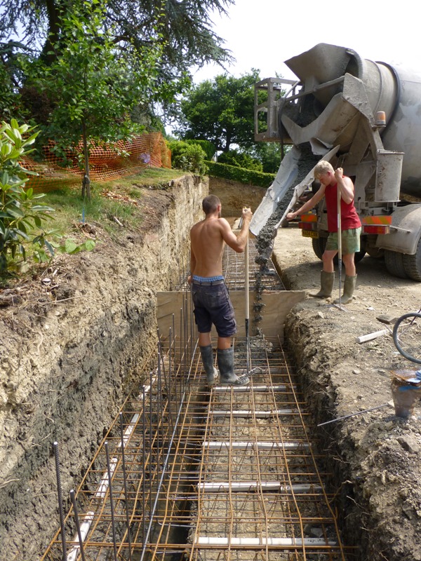

Jeremy Harris Posted June 24, 2018 Posted June 24, 2018 We poured our retaining wall foundation on a day when it peaked at over 30 deg ?
CC45 Posted June 24, 2018 Posted June 24, 2018 Thats a lot of footing for what looks like a 4ft rising to 6ft of bank! Must have been costly. Ouch.
Jeremy Harris Posted June 24, 2018 Posted June 24, 2018 35 minutes ago, CC45 said: Thats a lot of footing for what looks like a 4ft rising to 6ft of bank! Must have been costly. Ouch. The height is deceptive, as that bank is just over 8ft high at the far corner, plus the wall runs down along the far side as well. Yes, it was very costly. IIRC, the basic retaining wall and foundations came to around £25k, as it was two rows of 215 hollow blocks with vertical steels through the concrete-filled hollows plus horizontal steel rods along the mortar courses, laid in English cross bond, with the front and rear stretcher rows offset by half a block. The addition of a mixed block and stone dwarf wall at the top (topped by a fence) plus cream render to the whole exposed face of the wall, pushed the total cost up over £35k. This photo of the part- finished wall gives a better idea of the scale of the thing:
CC45 Posted June 24, 2018 Posted June 24, 2018 it is a lot bigger than the previous picture. Painful cost but I guess you haggled that off the plot cost! Must have taken some time as well. How do you handle the drainage? I'm guessing you don't want any water appearing on the face of that wall?
Jeremy Harris Posted June 24, 2018 Posted June 24, 2018 Yes, the plot was relatively cheap because of all the problems, thankfully. The drainage is handled by a perforated land drain pipe right at the bottom at the rear of the wall, with pea shingle backfill to allow any water from above to drain down to the land drain. The drain feeds to a soakaway, which by good fortune connects to an old Victorian clay pipe drain that runs down to the stream. My guess is that the clay pipe drain was put in to take spring water away to the stream, as there are a few springs that run out of the side of the adjacent lane.
