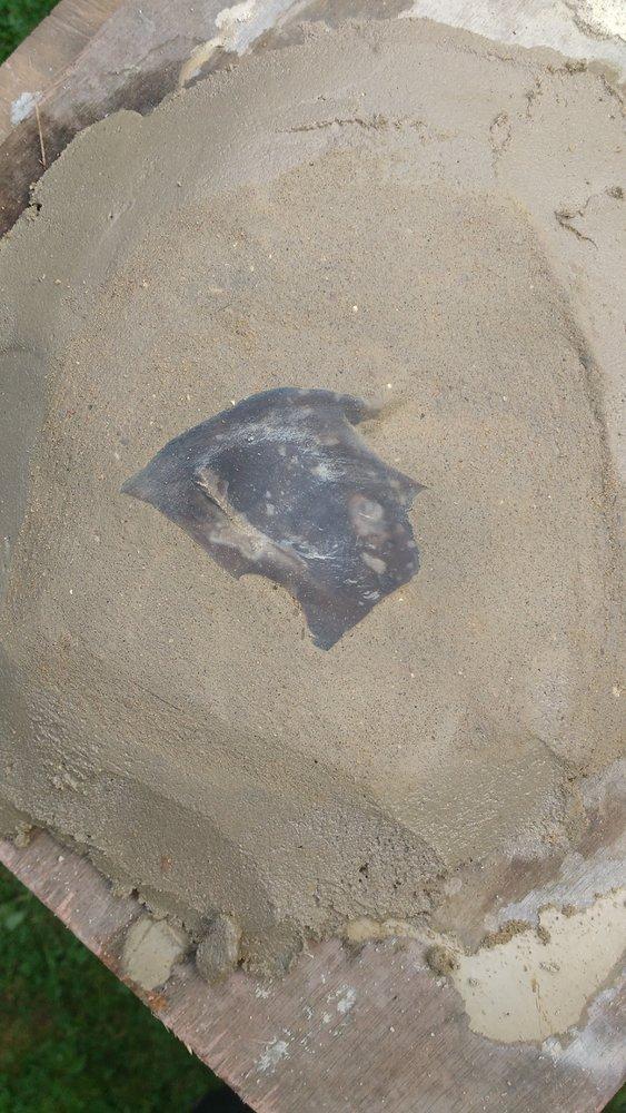

Onoff Posted October 30, 2021 Author Share Posted October 30, 2021 25 minutes ago, Gus Potter said: My view is that cement is not an option. All cements shrink.. flints have a very smooth impermeable surface and you won't get a flexible bond if you use a mix with any cement content. Anything lime heavy is far too white for our liking. Worst case it fails and I have to take them all out and redo. This is the mix I'm going with. - 3 soft - 1 sharp (figured it'd add strength and maybe some interest with the fines in it) - 1 opc - 1 lime (for plasticity/self healing) Happy with the test piece, its colour and edges around the flint: Plan is to, once dry, treat with maybe one of the waterproofing creams and repeat as required. Goes against the grain of traditional flint walling I appreciate. Let's face it, they wouldn't have had such waterproofing coatings back in the day. Link to comment Share on other sites More sharing options...
