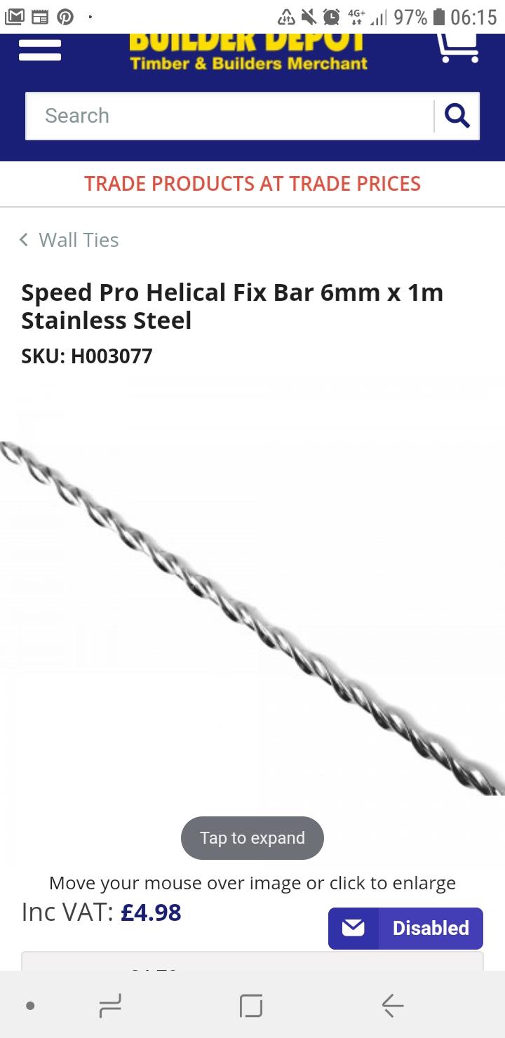

Onoff Posted May 7, 2019 Author Posted May 7, 2019 (edited) I was thinking to use these st/st helical wall ties cut down to to say 400mm: Did wonder whether I could use standard wall ties set at 45deg on each corner? Edited May 7, 2019 by Onoff

Brickie Posted May 7, 2019 Posted May 7, 2019 1 hour ago, Mr Punter said: I would fill with concrete as you build up. Not the same day though,risk of blowing the brickwork out. If you are mass filling,I’d just hang ties into the void. They’ll tie the brickwork to the concrete & make it all solid. As @Mr Punter says-the linseed oil prevents staining on engineering bricks. Only paint the faces which will be seen,and I wouldn’t vouch for using it on any other brick susceptible to staining (soft reds for example.) Might be fine but I’ve never tried it.
