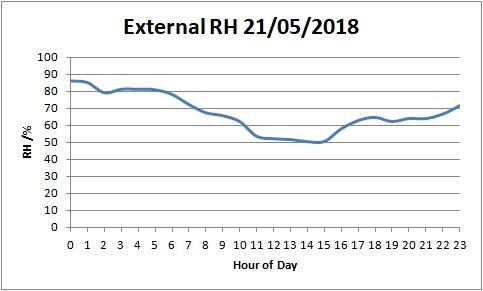

SteamyTea Posted May 23, 2018 Posted May 23, 2018 I was pondering this internal RH problem last night. Regardless of whether you have MVHR or not, if your house is hotter than the external temperature, and you are not doing silly things with hot water, then the internal RH will be lower than the external RH. This is because internal RH tracks external RH and for any given mass of water in the air (the AH), the higher the temperature the lower the RH. I seem to remember that there was someone over at the other place who had used lime plaster and had trouble getting it dry (not a surprise with lime plaster, but that is another story). He played with his MVHR and it seemed to make no difference. I offered to measure his RH levels, but he never took me up on it as he was convinced that the problem was the MVHR, so turned it off and just opened the house up. One thought that has just crossed my mind, where is the RH monitor?
Gone West Posted May 23, 2018 Posted May 23, 2018 23 hours ago, lizzie said: How do others do it? On my system there are four fan settings and it is recommended to run it on setting two. Setting one is for when the building isn't occupied and turns everything else off leaving the fans running very slowly. It is possible to change the fan speed for each setting so I have reduced setting two to 30% which allowed me to change the ventilation rates to that for a PH. This has increased the humidity from 37% to 45%. 2
SteamyTea Posted May 23, 2018 Posted May 23, 2018 1 hour ago, PeterStarck said: This has increased the humidity from 37% to 45%. Has the internal temperature changed? Also, the external RH can change quite rapidly for a seemingly small temperature change. All that is needed is a lot more data
Gone West Posted May 23, 2018 Posted May 23, 2018 2 hours ago, SteamyTea said: Has the internal temperature changed? All that is needed is a lot more data No, temperature the same. If only I had the time.
