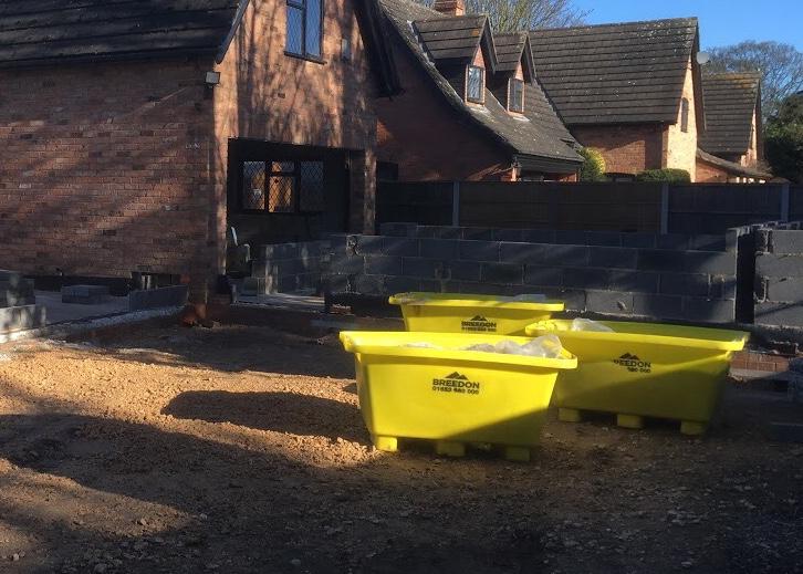

PeterW Posted May 6, 2018 Posted May 6, 2018 Ready mix is quick, simple and quiet although a 1/3cuM tub weighs a fair bit so you either need a flat level drive and a pallet truck or a Telehandler if you’ve got a way to go and tight access. But as @Declan52 says - you get a perfect finish with no variation.
Vijay Posted May 6, 2018 Posted May 6, 2018 so does the ready mix mortar come mixed dry and then you add water or does it come ready to use?
PeterW Posted May 6, 2018 Posted May 6, 2018 Just now, Vijay said: so does the ready mix mortar come mixed dry and then you add water or does it come ready to use? Comes pre-mixed with a retarder in it - will last 72 hours or thereabouts if you keep the air off it. Lovely stuff to work with and no mixer running for 8 hours a day !!
SteamyTea Posted May 6, 2018 Posted May 6, 2018 13 minutes ago, PeterW said: with a retarder in it So comes with the brick layer in the tub then, cool
Nickfromwales Posted May 6, 2018 Posted May 6, 2018 First time I've even heard of compo being pre-mixed and sent to site! How much easier ( and consistent ) is that Let your fingers do the walking.
PeterW Posted May 6, 2018 Posted May 6, 2018 1 hour ago, Nickfromwales said: First time I've even heard of compo being pre-mixed and sent to site! How much easier ( and consistent ) is that Let your fingers do the walking. You rent the tubs and then they line with a poly bag every delivery - our supplier will do down to one tub an order but they usually like at least two - does about 400 bricks per tub. 1
Nickfromwales Posted May 6, 2018 Posted May 6, 2018 2 minutes ago, PeterW said: You rent the tubs and then they line with a poly bag every delivery - our supplier will do down to one tub an order but they usually like at least two - does about 400 bricks per tub. Cool And Jesus, you've done a fair bit to that place since that shot !
PeterW Posted May 6, 2018 Posted May 6, 2018 2 minutes ago, Nickfromwales said: Cool And Jesus, you've done a fair bit to that place since that shot ! Yep - told you there was a double garage in there somewhere ..!! I reckon I get 10-15% more brick/block laid per day with readymix on a 1:1 gang as the labourer is only loading out - no mixing, no Monday morning pigeon poo and you can normally run it over a weekend if it’s wrapped up tight. In 21 tubs in all dumped around a tub in total over 9 weeks - less than 5% wastage. 2
