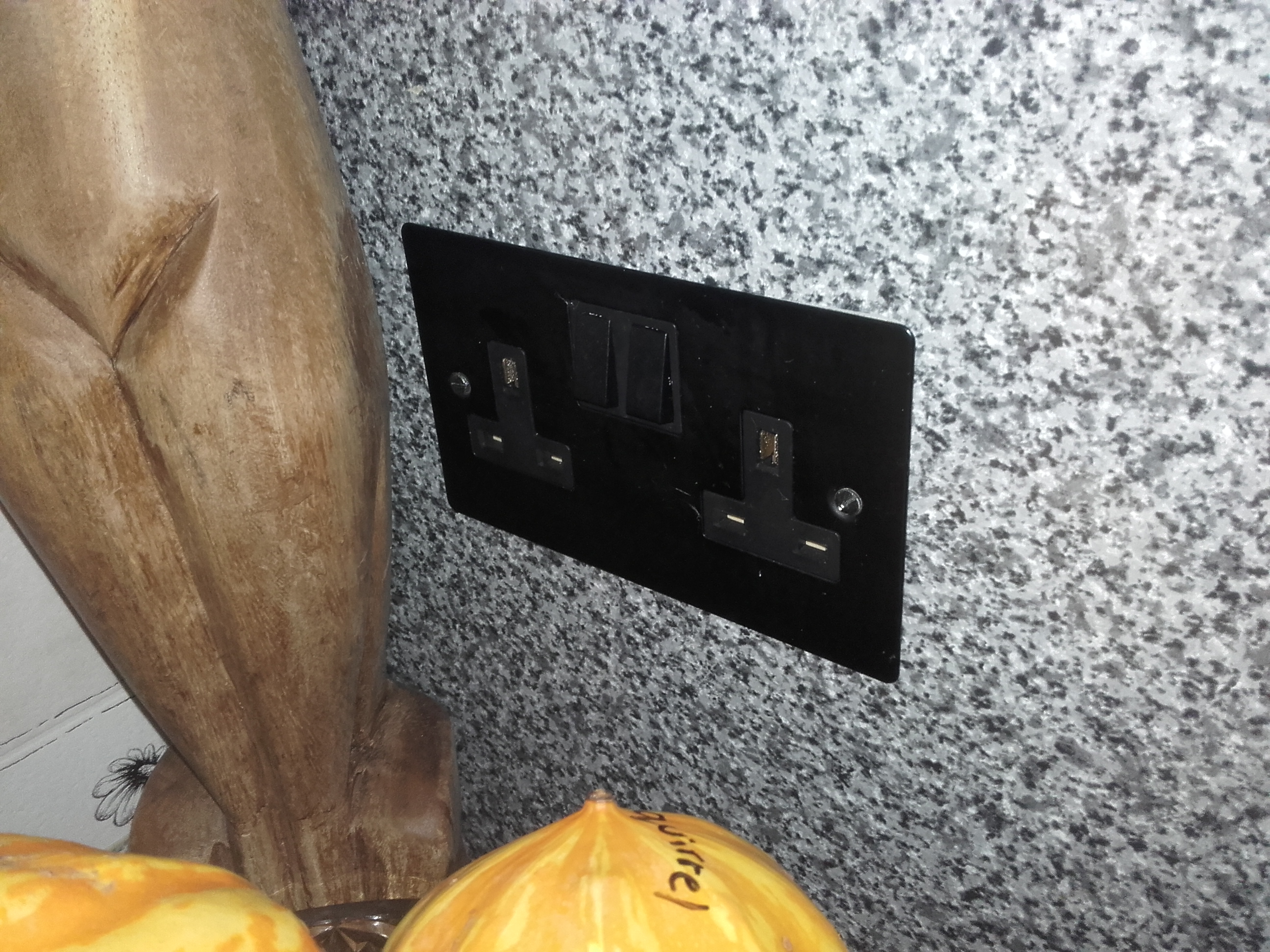

newhome Posted April 22, 2018 Posted April 22, 2018 I have white sockets and black in the granite splashback, but agree with @PeterStarck, it’s an individual choice so go with what you like. 1

Onoff Posted April 22, 2018 Posted April 22, 2018 In our "done before I found this forum else it would have been so different" kitchen, we have flat plate, matt black Volex insisted upon by SWMBO. To be fair all the fittings have a nice switch action except for the cooker switch for which I have to back the car up against! However...the terminals were a pita, very tight. I've changed most visible plug tops to decent black ones where I can so they stand out less. Less popular makes will have less range. I couldn't for instance get a neon version of the cooker switch. Then when I wanted a switched fuse outlet with the outlet in a particular place I had to an obscure make as a near match (Hamilton). I now want some USBs in there. The MKs they now do that would near match are about £60! Be aware too if you've used 25mm back boxes that some flat plate stuff won't fit.
